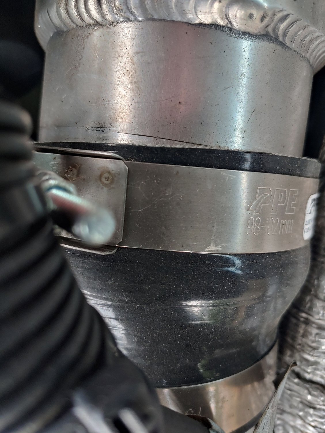

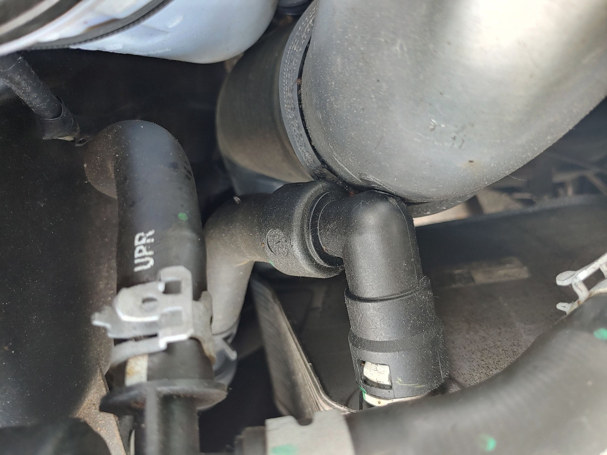

Just noticed this today that pipe was pulling out of silicone hose on my Rudy's pipe.
I'm gonna get on this today after work. Its up against the intercooler coolant fitting.
