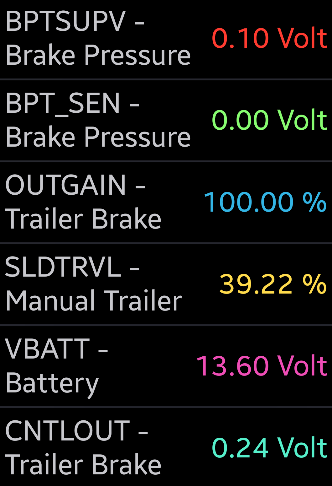

What is the code? I'd recommend using Forscan to test the inputs and outputs of the TBC module to verify your diagnosis.
What harness are you looking for? The pigtail that plugs in at the frame on one end and the other end plugs into the back of the 7-way trailer plug on the hitch?
This is a screen shot of a TBC module test using Forscan.
