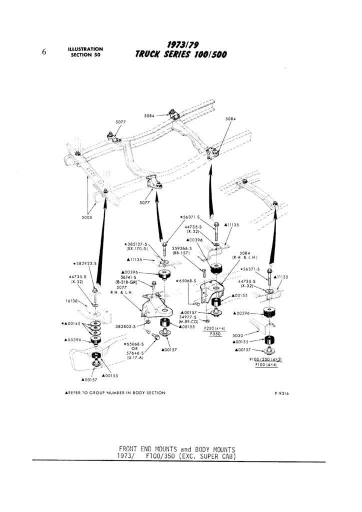

Ok installing energy suspension rubbers for my rad core.Upper/lower and three large washers and then large bolt and washer drops in from top of Rad cor,,,,,,,,,,,,My question is do I use the Three large washer as shims ,or am I just using to level out the rad core,or do I just sit the rad core right on the upper rubber and bolt down loose any help my appreciated

I believe the 3 washers (00145) are to shim/level? So between the core support and on top of the bushing, on top of the frame?

Great pic Rich ,talked to a friend that restored his bump,said you wont know until you set the cab to line up fenders,any way your pic shows the three large washer /shims so IL start with them ,,,you back in the States,hope all went well.Thankyou
