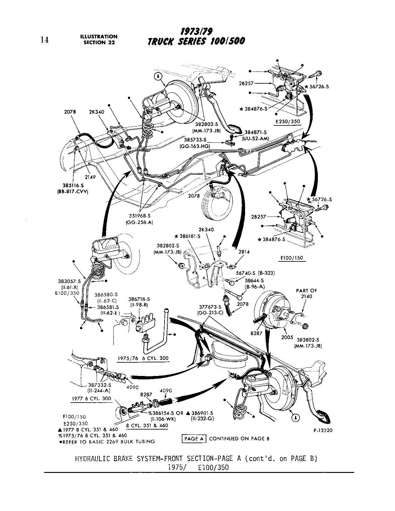

There were TWO different valves used in 1977, which one are you using?
D4TZ-2B257-A .. Brake Pressure Differential Valve / Marked: D4TA-2B328-A1A or A2A or D5TA-2B328-C1A or D1A / Obsolete
1974/79 F250 2WD with dual piston caliper disc brakes // 1974/79 F350 except 1979 F350 4WD /// 1975/79 E250/350.
D5TZ-2B257-B .. Brake Pressure Differential Valve / Marked: D5TA-2B524-FA or FB / Obsolete
1975/79 F100/150 2WD/4WD // 1975/79 E100/150 // 1975/79 F250 2WD with single piston caliper disc brakes // 1976/79 Bronco // 1976/79 F250 4WD // 1979 F350 4WD

Location varied by years/vehicles, here are two examples.
See 2B257 in upper/lower pics:
