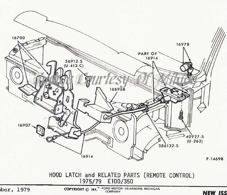

Pop the hood, remove the 1 bolt/screw (65912-S), and lift the cover bracket (16B968) in a way that it will unlock from a tab?? Meaning the odd shaped bracket that is over the place/area/the hood release bracket that the cable connects to. Then you remove the cable loop from the latch, and then the plastic piece/collar in the end of the bracket. You have to pop out of its mount hole. And then just graphite the cable end.

Another piece of advice while you have it apart is to make some simple low key modes to the locking latch area to make is easy to open in the event you break that thin old cable.
See the red dash, that is a cut/slit just big enough to put a #1 size flat tip screw driver (blue) in to and over to push on the lever the cable normally pulls on to release the hood. See the X on the cover you removed you can make a back up emergency hood pop J rod (red) so to speak.
Of course to get in there you have to remove your grill shell insert. Yes the diagram is for a van. I POSTED IT FOR MORE DETAIL, but trucks are the same way. AS FAR AS THE WAY YOU ACCESS THE LATCH CABLE. I NEVER SAID THE CABLE WAS THE SAME.
