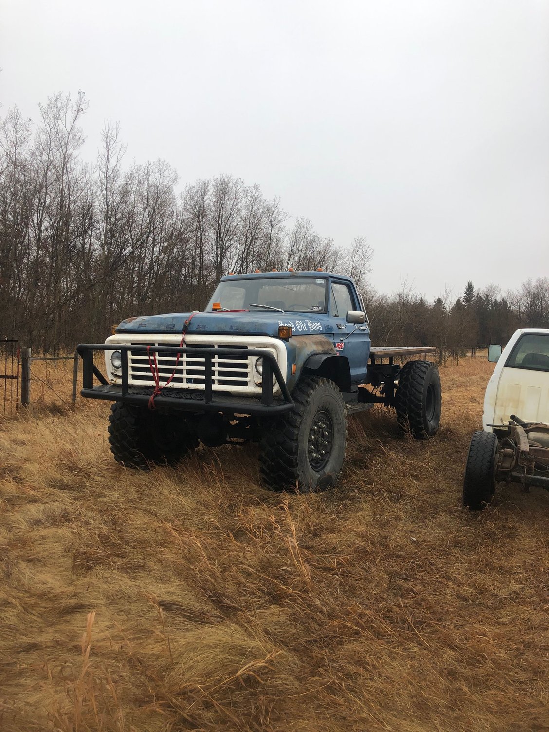

Hey Ya’ll. I just bought a 1975 F660 and I’m trying to find out what it’s all got or had when it was built. I’m not having much luck decoding this VIN. Any help would be appreciated

And here is a picture of the old girl if any of you wanted to have a look

Awesome looking truck man! Gunna have some fun in that one!

WOW.... an F600...... that joker sure looks MEAN.
Congrats on the find!
