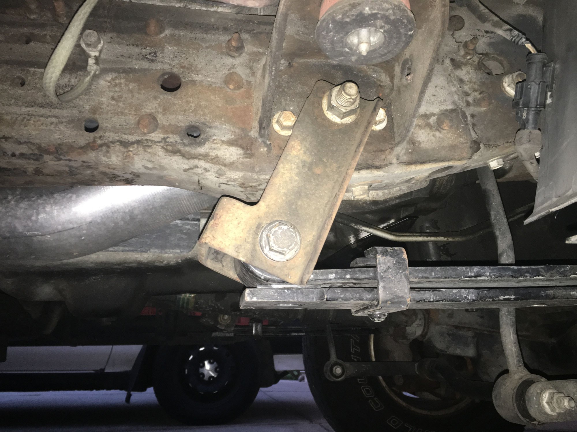

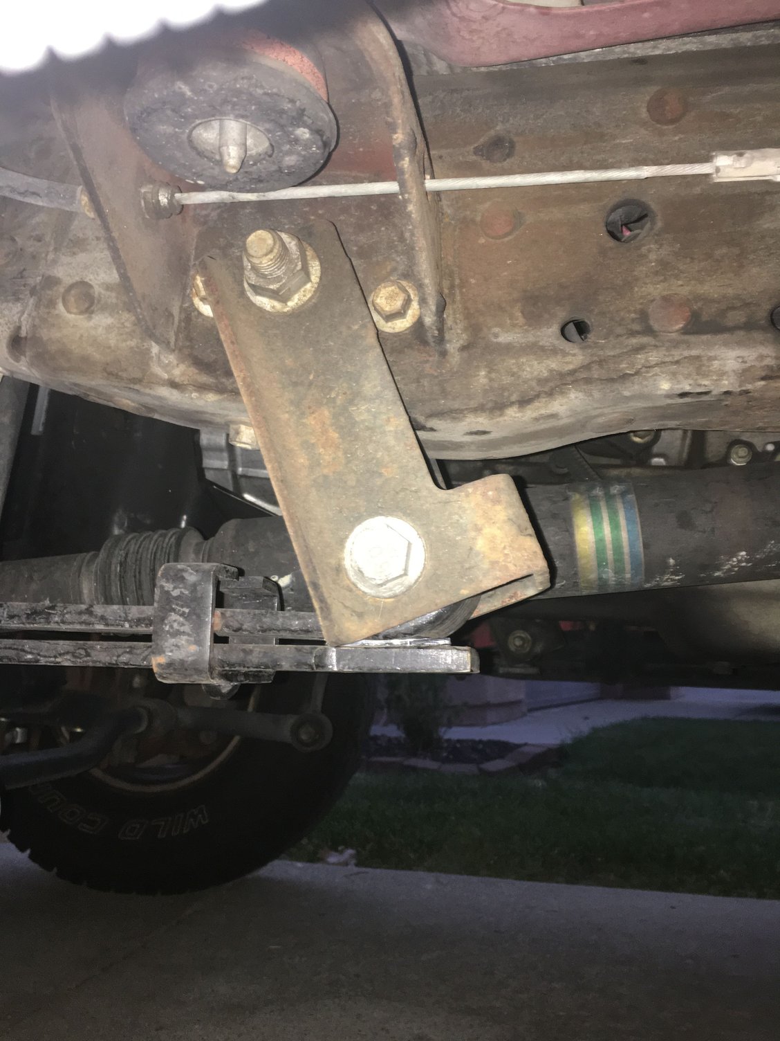

Though I’m satisfied with my X/Mod B codes (mentioned V codes earlier but was mistaken) from ATS, I am curious about how the ProComps would stack up against what I’ve got. The ride is nice, just wish now that they’ve settled out that I had another 1.5” or so of height like it was 5k miles ago with new springs.
The front shackles are within an inch or so of contacting the frame rail again, similar to how they were with my stock springs, the X codes have nearly flattened out since I’ve been driving on them. Maybe it was addition of my 200# ranch hand grille guard that overdid it, I don’t know? Maybe the “modified Xcode” would have been more appropriate, again or possibly the ProComps.

Jregezeino's Avatar
Jregezeino
Joined: Mar 2018
Posts: 347
Originally Posted by pirate4x4_camo
I edited the 350,,,,, I read your 200 pounds but typed 350 pounds because I was looking at v10 spring rates.
200 pound ranch hand would compress the psd springs .26”
no the shackles should not hit the frame... post a pic
Here are two pics, this is on an upward slope in my driveway (weight shifted rearward) and completely unloaded truck. When the springs were new and stiff, the shackles sat nearly vertical.
