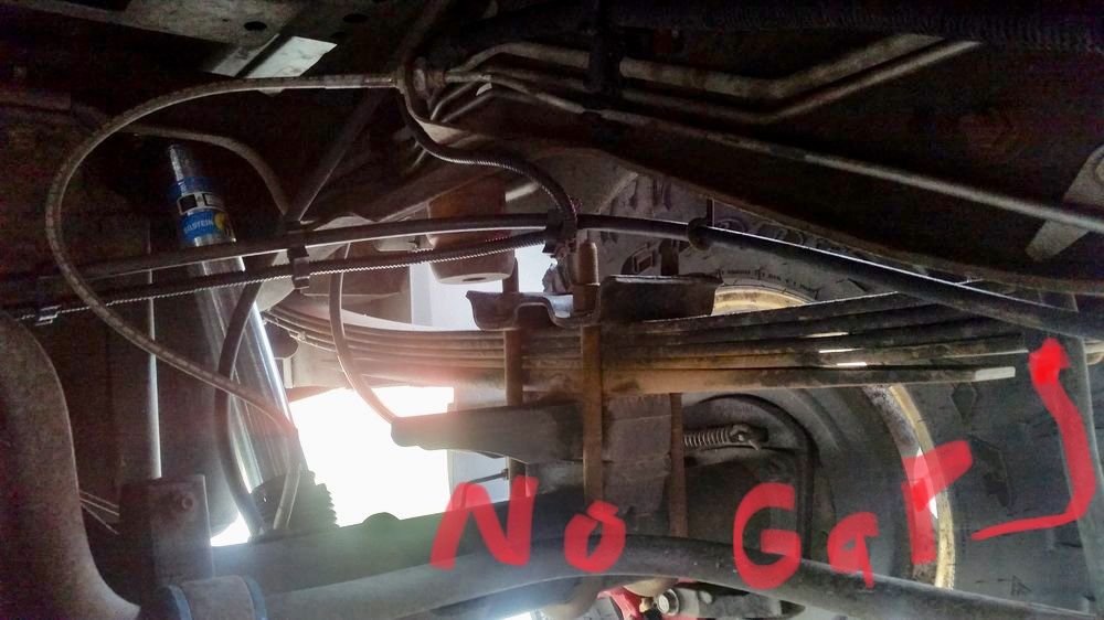

When you use the dual rate spring in your Excursion the additional curb weight over the F250 compresses the main spring so it almost sits on the secondary or overload spring at ride height. This means you are riding around on a spring rate of 1000 pound per inch..... way way way to much ..as in it is ridiculous setup that we used to use because it was free out of a junk yard.
this is what a B or C f250 spring looks like when installed on a Excursion ...
notice the lack of gap between the main spring pack ( top 4 leafs ) and the very bottom overload spring.
on a f250 this gap is over 4 inches

This is how a dual rate spring is designed to work on the F250,
notice the gap gap between the main spring pack and the overload spring.

No let’s look at The graph from Ford’s leaf spring test as shown on the blue prints.
as you can see the B code has 7” of total travel and we know the main spring pack has a rate of 330 pounds per inch and the auxiliary or overload leaf has a spring rate of 670 pounds per inch.
as you can see in the picture I post in a previous post the weight of the Excursion compresses the main pack down onto the overload spring at curb weight, This give you a 1000 pound spring rate and as you can see in the graph that leave some you with only 2” of up travel
