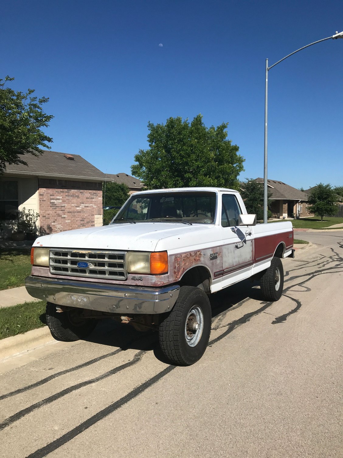

its an 83 frame with a 91 brick nose.

I apologize. again, new to forums. I'm still learning more about the truck. its a 83 frame with what appears to be a 91 bricknose cab. Looking at the image you posted, i have the manual interior door lock 22168, but not the 21852 type.

22168 latch control and its associated 21852 rod not used after production date 3/1981. So no 1982 and later has them.
Pic is 1980/89, 1990/91 would be the same.
