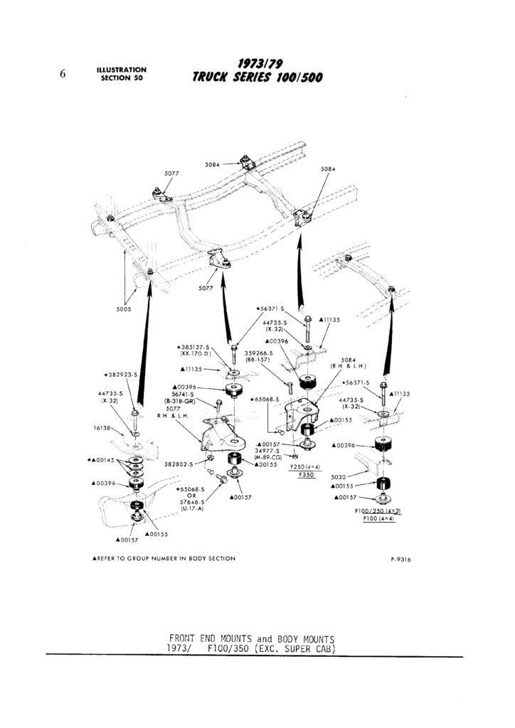

X2 from the top side either use a BIG impact or a 4 ft cheater pipe on a 3/4 or 1" drive breaker bar. Then you will either strip the bolt head or snap it in half. NO cutting torch the rubber bushing bust into flames and smoke like crazy. Sawzall between the bottom of the core support and the top of the frame rail.
D3TZ-1000155-B .. Absorber (rubber cushion) - Lower radiator support and lower front & rear cab mounts / Obsolete
CARPENTER NOS OBSOLETE PARTS in Concord NC = 800-476-9653.
PARTS INTERNATIONAL in Farmers Branch TX = 888-727-0418.
GREEN SALES CO. in Cincinnati OH = 800-543-4959.
WESLEY OBSOLETE PARTS in Liberty KY = 606-787-5293.
D3TZ-1000396-C .. Absorber (rubber cushion) - Upper radiator support and upper front and rear cab mounts / Obsolete
PARTS INTERNATIONAL
GREEN SALES CO.
