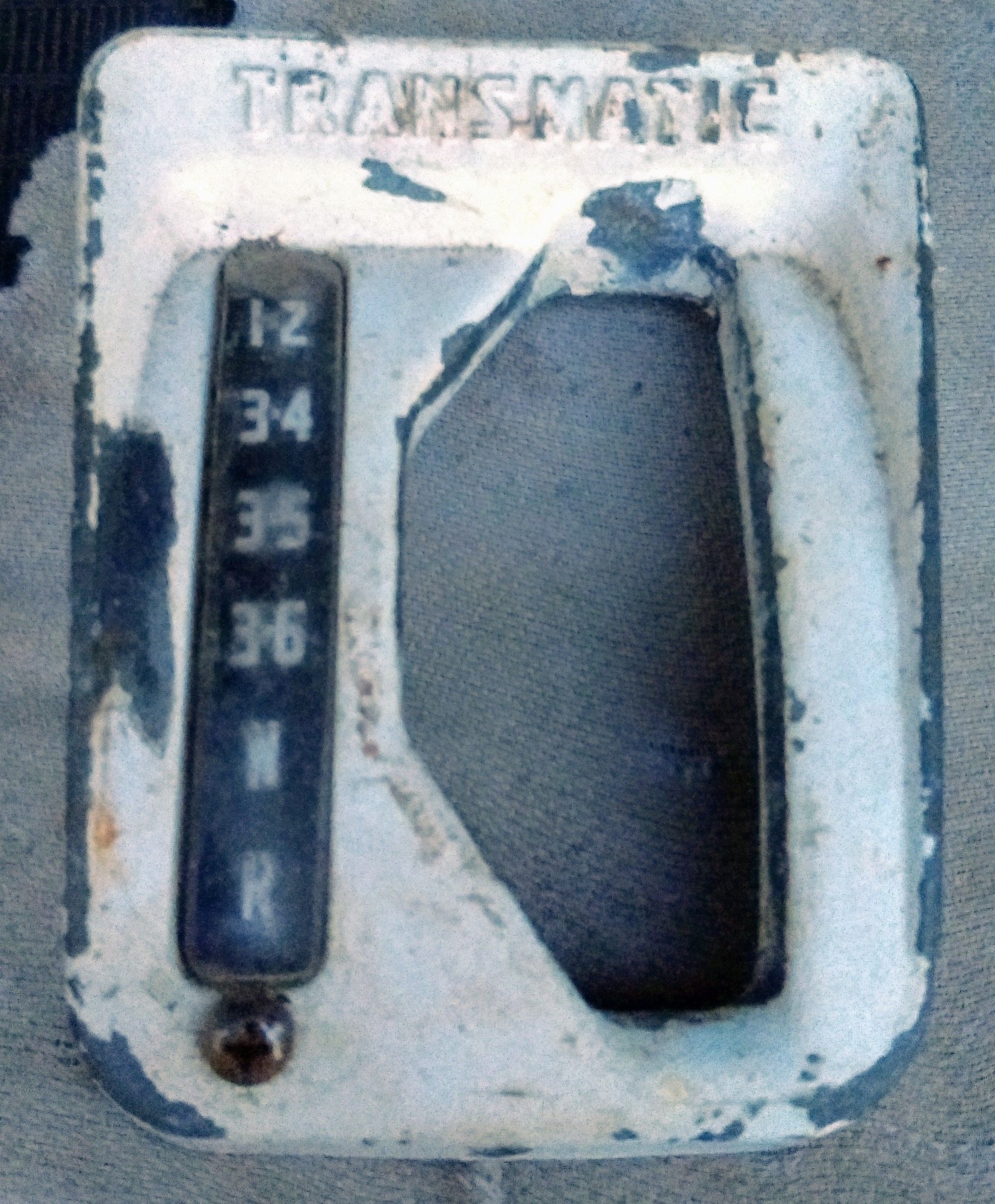

Thank you, I'll give that plate a look over and thank you for the Allison info. The shifter didn't have the bezel that had the pattern on it but I lucked out and found it in the glove box. This is going to be a rookie question but this is my first encounter with a pattern that looks like this one: When I'm loaded down with gravel do I start out in the 1-2 spot and then move it to the 3-6 once 2nd gear is wrung out or will it start itself out in 1st and work its way up through the gears if I leave it in the 3-6 position?
All of the medium-heavy trucks I've ever driven were manuals, so this is my first experience with an Allison.

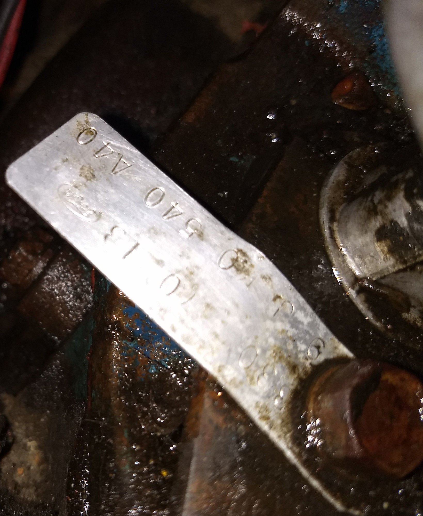

This truck has a Motorcraft 2bbl 2150, I believe, on it. There is nothing going to the plate under the carb except the PCV and no hoses aside from vacuum advance leaving the distributor.
Wouldn't a 70 330MD have had a Holley or an Autolite?
I did find these tags on the transmission and next to the distributor. (The distributor area tag is hard to read even in person, but the first number is 330 upside down by bolt.)
It is a MT30 trans according to the tag
Last edited by ID Scrounger; Apr 6, 2019 at 07:01 PM. Reason: Forgot pictures I referenced

2150 series Motorcraft carb introduced in 1975. 1963/74's used the Auto-Lite/Motorcraft 2100 series 2V
1963/74 500 and larger series trucks with 330 M/D's could have the 2100 series 2V or a Holley 2V

you would only use 1-2 as needed to start say on a hill
if the selection is 3-4, 3-5, 3-6 it will start in third gear and then upshift to whatever gear is allowed by the shifter position. The transmission as set up is not capable of automatically shifting thru all the gears (1-6). I rarely use 1-2, unless I am pushing 40k combined or on a steep hill
