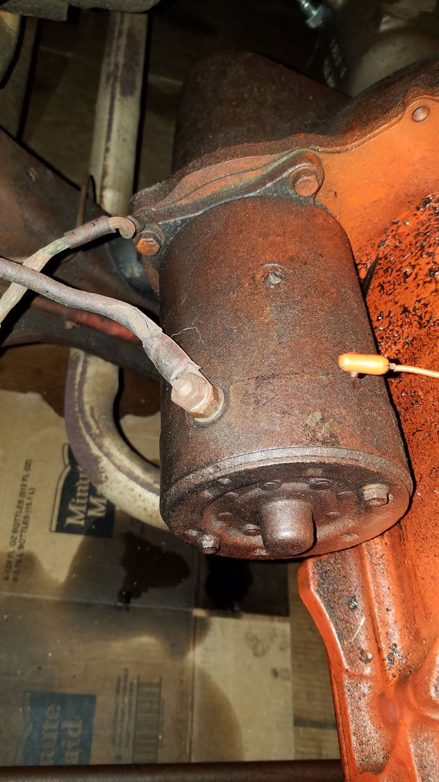

I have a 1964 F100, 223 inline 6. The starter has been missing, sounds like the bendix isn't engaging.

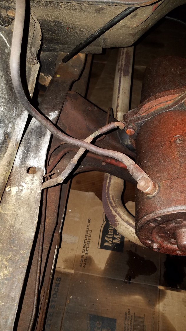

Before I pull it, I noticed the cables are frayed to the starter.
Are these a specialty item. some special part number (I can't get to my computer right now)
or can I go to a local parts store and replace them?

You can use any 4 or 8 gauge wire. I use 4 gauge myself and I buy rolls of pure copper welding wire. Add my own connectors with a crimping tool and done.+
While your in there you may as well replace any ground wires too. Like the grounding to block and frame.

I would recommend avoiding generic parts house replacement cables when possible. They are not made with good materials. For the same money can get high quality cables and terminals from a Tractor supply or welding outfit with terminals pre-installed with a good crimp. Those cables in the pic are original Ford. They weren't bad when new but they are shot now. The blister-pac cables commonly seen today are OK for a small 4 or 6 cylinder car probably but that's about it, they have thick insulation, and hardly any copper. There are some cable sellers on eBay if none are available locally. Just need to know the length and ring size.

I wouldn't be surprised if you can't locate any such ground cables. They have a way of coming off over the years and not getting put back on.......... if that is the case - you should add some. Your truck will thank you for it.
Ideally, ensure there is a grounding cable from the block to the frame and from the block to the firewall. Make the cables ~ two inches longer than needed to allow some engine to body to frame flexing. Scruff/shine up the attachment locations to ensure a clean contact then bolt the cables on, and lastly spray the attachment bolts with a sealer to prevent corrosion in the future.

You can do the "as long as I'm in there might as well..." too. Clean the starter face and block where they mate from any paint or grime. The solenoid starter relay needs a good ground too.
Where does the negative battery cable terminate on your engine, to the block or the frame, or at the firewall?
They were kind of cheap with the wire lengths back then and did things like that. They took a circuitous route with about 5 different connections. Today I run a heavy negative cable directly to the block, a bolt near the starter. Another cable to the frame just like in the pic, and a firewall to block connection strap, up by the distributor/heads. With fresh cables all around it will start zippier and charge better.
