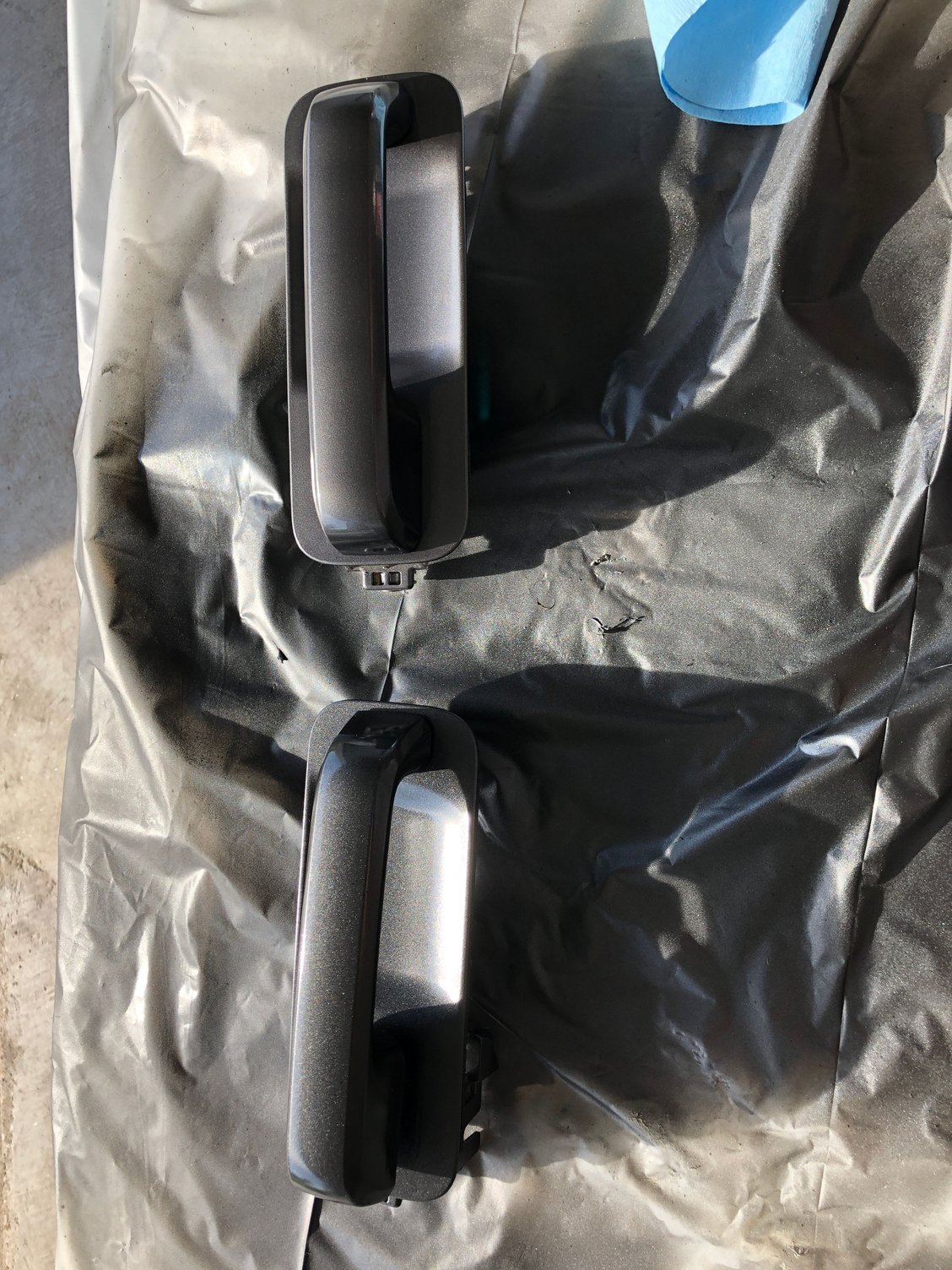

My truck does not have the painted door handles, they're black. Working online with oempartsource.com, they came up with JC3Z-2522404-AA using my VIN number. I'll know in a week or so.
Thanks -
- steve
2522404 is NOT going to work. I know because that's the first one I bought and there was an obstruction since the handle is essentially flipped.. you need the driver rear handle with the part number above.. I will put it on tonight I can take a picture of both handles when I get home if youd like.

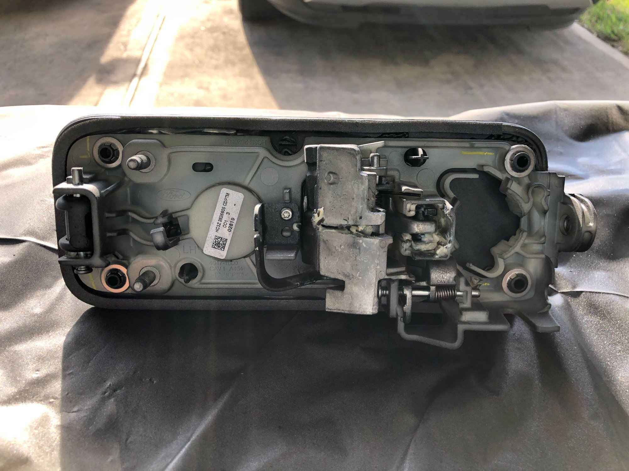

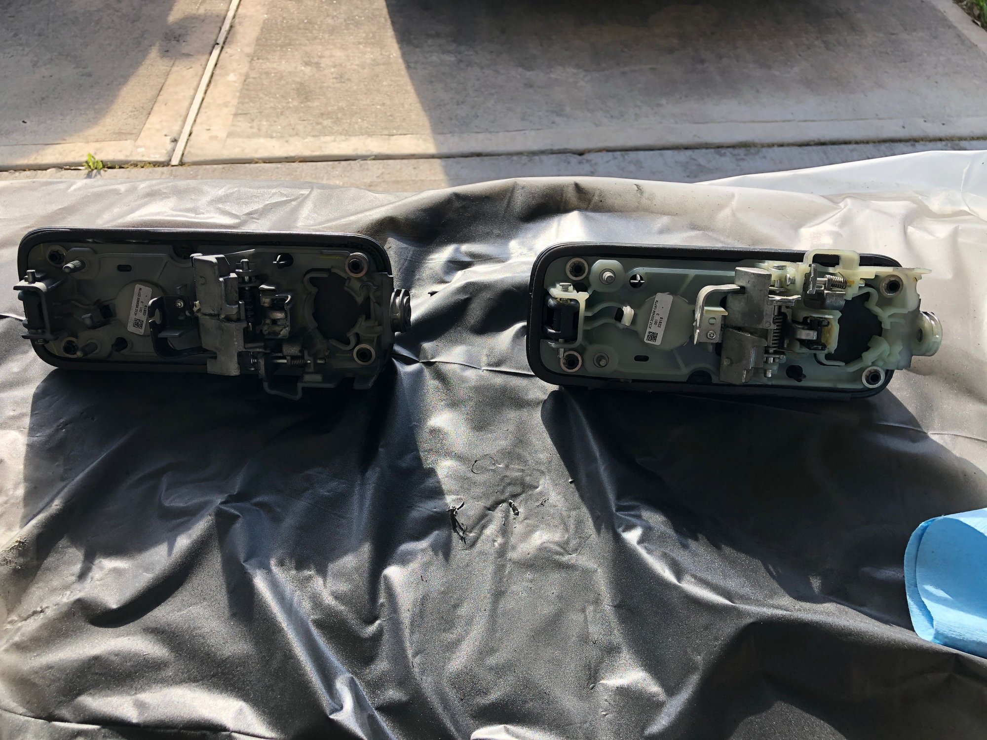

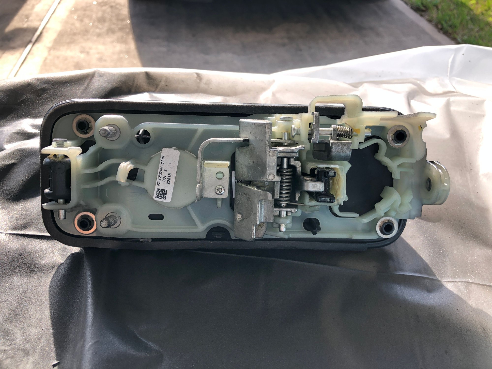

Left side is the correct part you need (driver rear) Right side is the wrong part (front passenger)

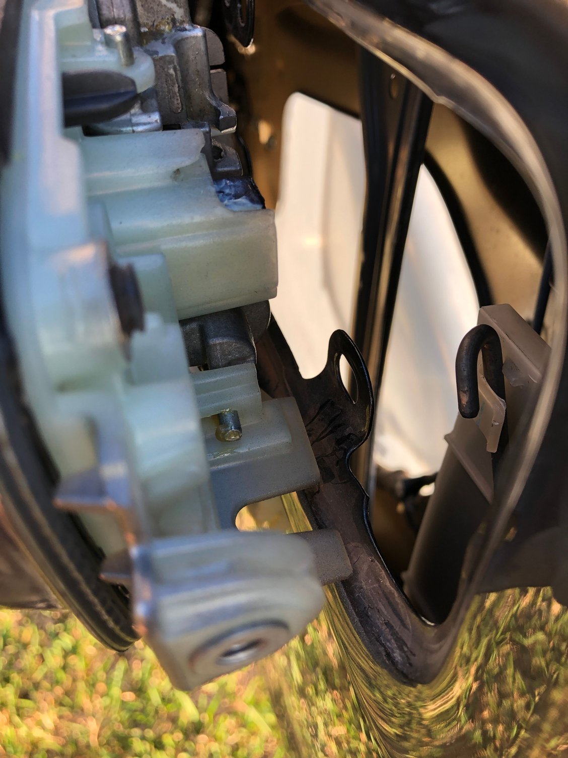

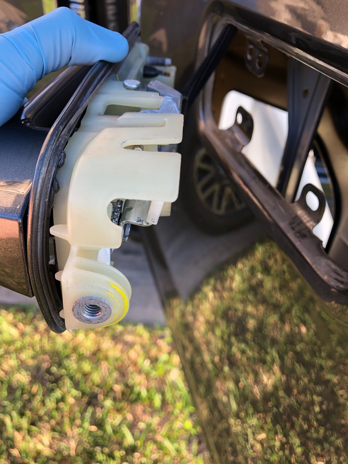

Correct part needed with no obstruction
Wrong part.. notice the tab on the bottom of the door opening. It obstructs the entry

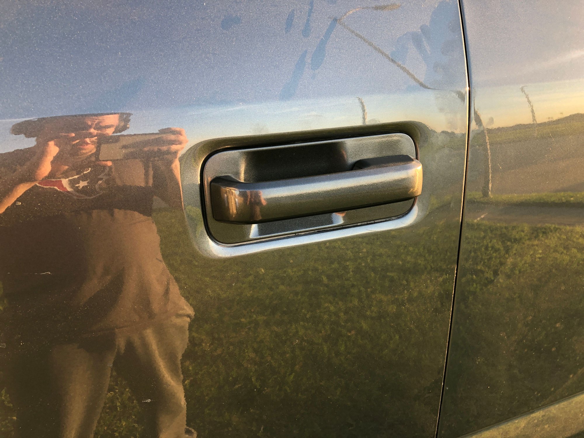

Once it’s all said and done.. final product hopefully it deters the thieves
