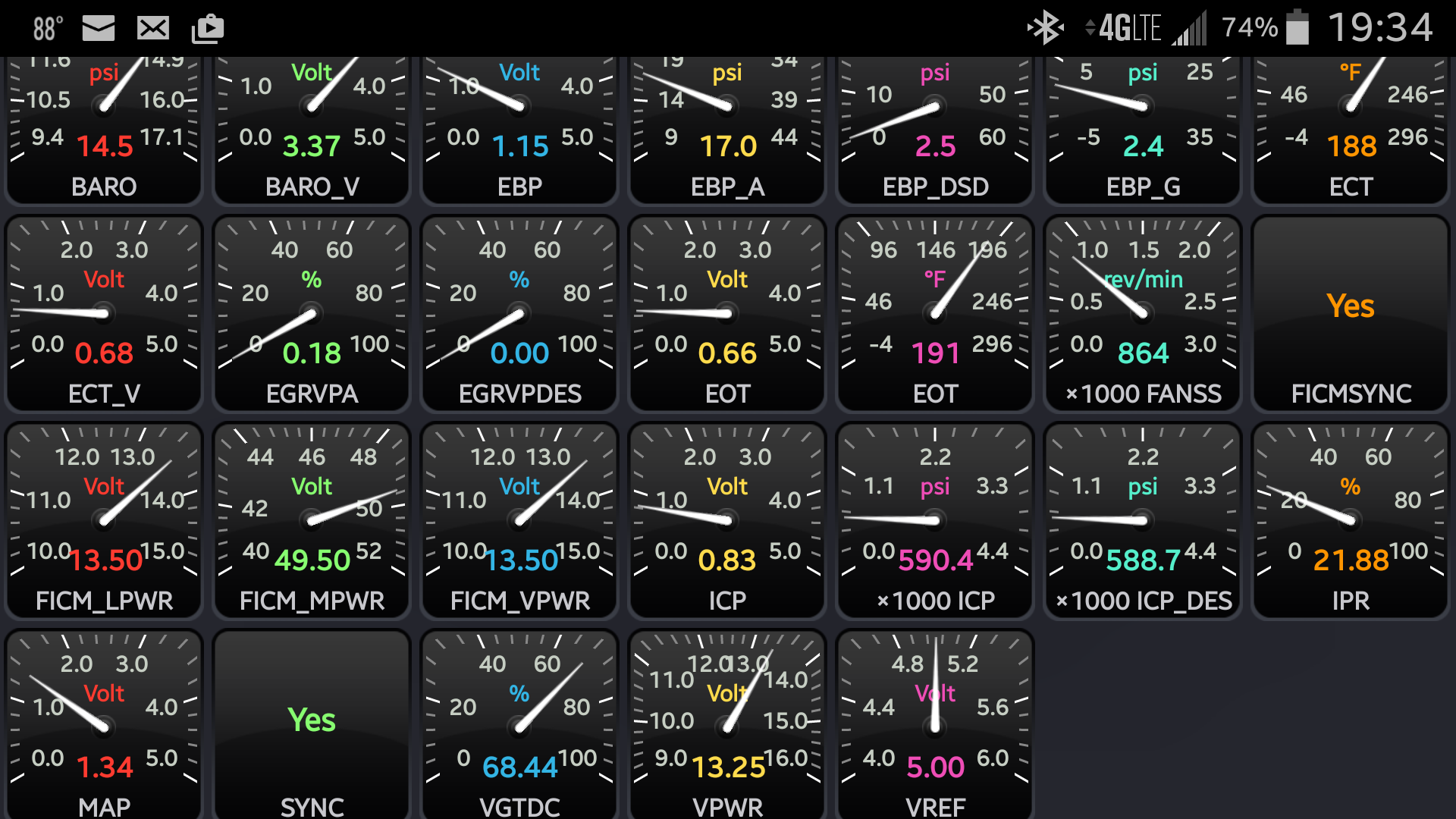

I've never had the capability to monitor very many parameters at once but with this x4 I can display several at the same time. But I have no real idea what it's telling me. What are some normal readings I should be looking for? I know batt voltage is 13+ ficm should be 48, and eot and ect. But what about icp? Ipr? Ebp? From what I gathered from a quick search of the forum my ebp reading is about 100 too high. I rarely see it below 100. But I don't know what that's telling me. Vgt is another pid it displays but I haven't the slightest idea what it means. Sorry for sounding like a newb but I've never had access to this kind of data before and need enlightened!

Normal at idle, fully warmed up pids for 2005.

That is an awesome layout. What app is That? My evo reads 99 at minimum and 130-140 when I am on the throttle
That is the Forscan app. I don't daily that, it's for mobile diag in a pinch when I don't feel like hooking up IDS.
