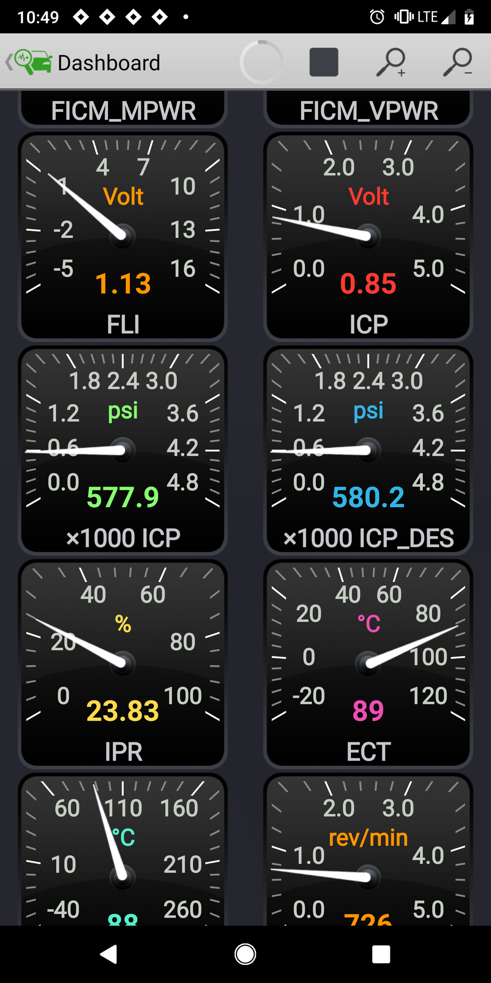

Hi I took a screenshot of some of my stats including hpop at idle. Does it look normal? Am I running at the minimum requirement or is this where the psi for these trucks generally sit at idle? The truck is a 2005 F350.

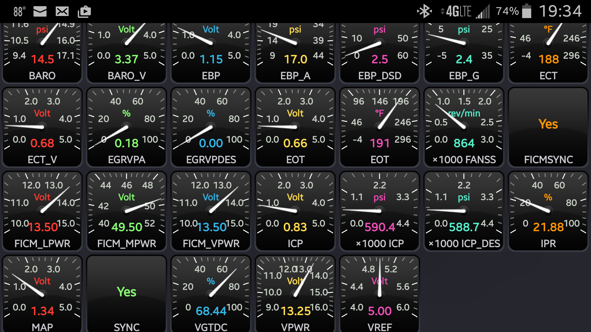

Post more info such as the desired ICP. In my opinion your IPR is high and ICP is low which to me indicates a small leak but I dont know what the PCM was asking for nor if it was at operating temperature (186°f+).
Here are the standard numbers for a healthy system I go by of my 2005.
Notice desired is 588, which is normal for a warmed up at idle engine, and it is making 590 at only 21.88%.

Ok so I got at least a few PIDS through Forscan up and running. I used ICP and ICP desired and I see the app stating that at idle my ICP desire is 580.2 and actual fluctuates or bounces between 579 and 582. Doesn't stay at 579 for even a second but it's does show that it's dropping to that point momentarily. IPR stays at 23.8.
