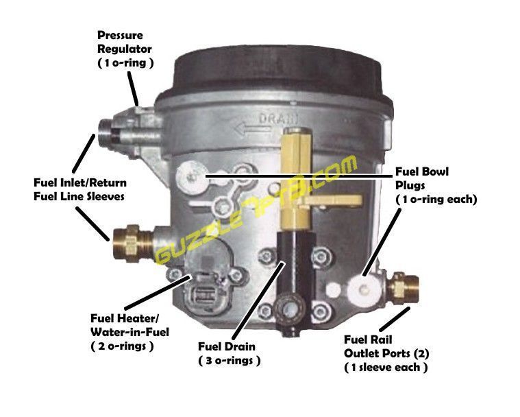

Why not just check your fuel pressure? Just because it doesn't have a way to push a button doesn't mean that it can't be checked, it means it can't be checked electronically. There's a port on the fuel bowl you can take the plug out of and tie into with a gauge. Do a search and you'll find tons of info on it.
Old Mar 31, 2019 | 09:44 AM
Sous's Avatar
Sous
FTE Leadership Emeritus
Joined: May 2014
Posts: 27,354
Likes: 5,946
From: Lake Hartwell, GA
FTE Emeritus
As JOHN2001 mentioned, there are two ports on the backside (toward the cab) of the fuel bowl you could tap into in order to read fuel pressure. It should read ~60 PSI at idle from either port. The one on the lower right (looking at the picture below) is post filter and the one on the upper left is pre-filter. The fittings/plugs should be 1/8 FNPT.
In the image, they are labeled "fuel bowl plugs".
