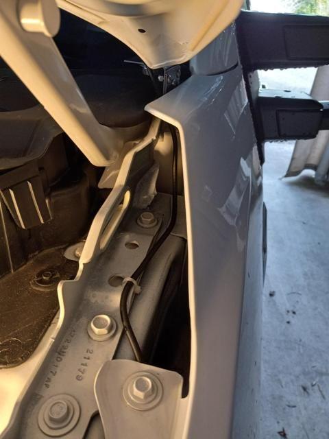

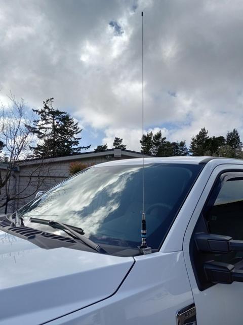

Using an idea posted by Gasgzlr, I used two Tram-Browning 1/2 inch stainless "L" brackets to install a President Iowa antenna to the new pickup. It does require drilling two holes to attach the two brackets together. I used stainless hardware to connect the brackets.
The radio I installed is one of the President Bill FCC units. I used a 9 foot Firestik Fire-Flex coax and went through the large firewall factory grommet on the driver's side using a small socket extension. Taped up where I went through the grommet afterward with new friction tape. It's wired to the outfitter 1 switch using the factory pass-through wires. I used indoor outdoor Velcro to attach to the dash. The SWR across the board is 1:3.
