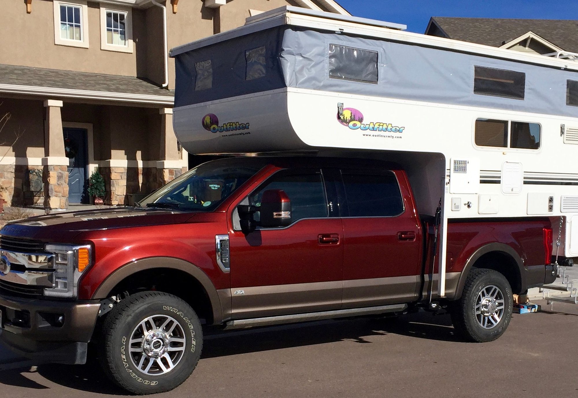

Where in the world can you mount a CB antenna on these 'AlumaDuties'? I might be able to bend a piece of stock with multiple angles on the fender well near the windshield but, other than that I'm at a loss as to where.
It needs to be able to clear the truck camper when mounted (that is the hard part).

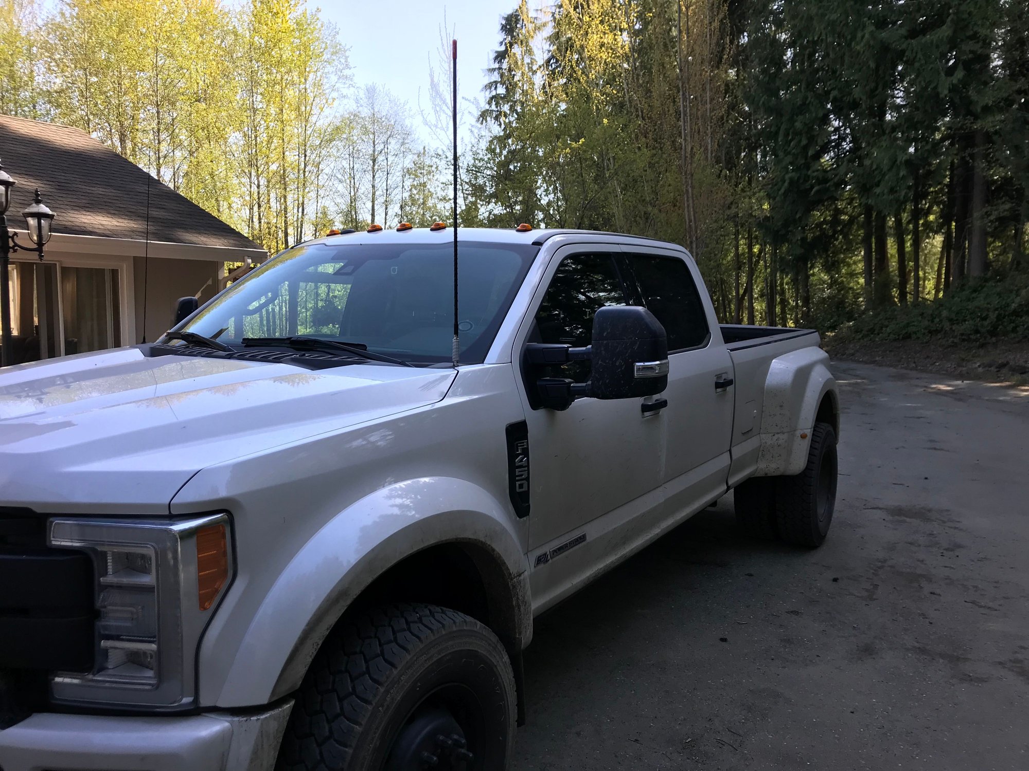

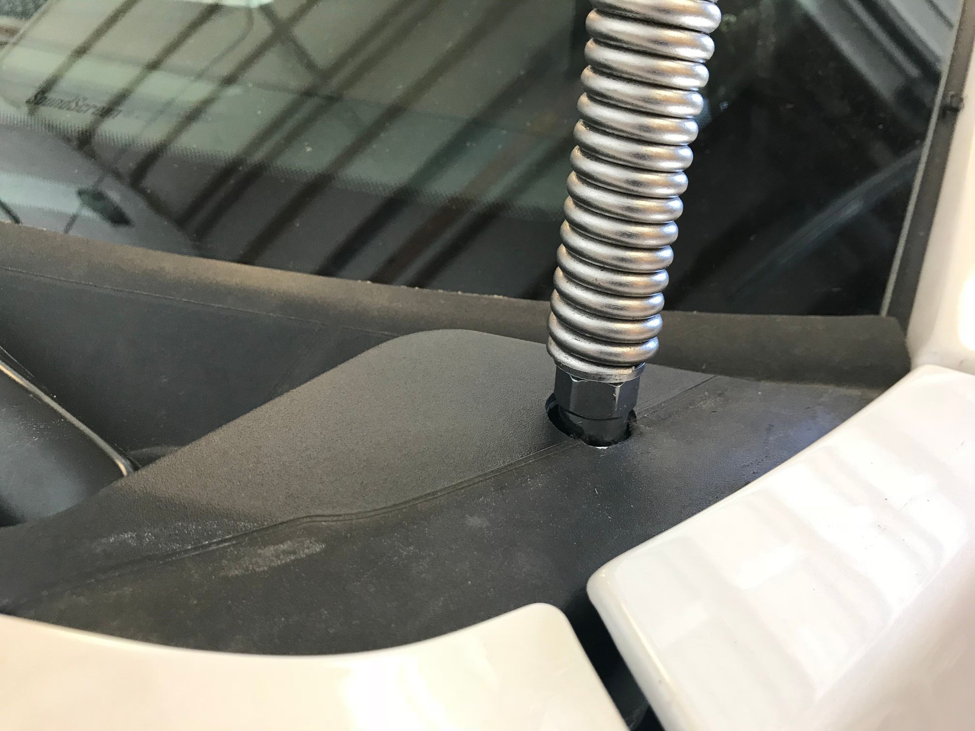

Here is what I did. Same constraint as you, hauling a TC. I fabbed the bracket and mounted it to the hood hinge bracket base. It handles a 3ft fire stick OK, but prob not sturdy enough for a 5 footer.

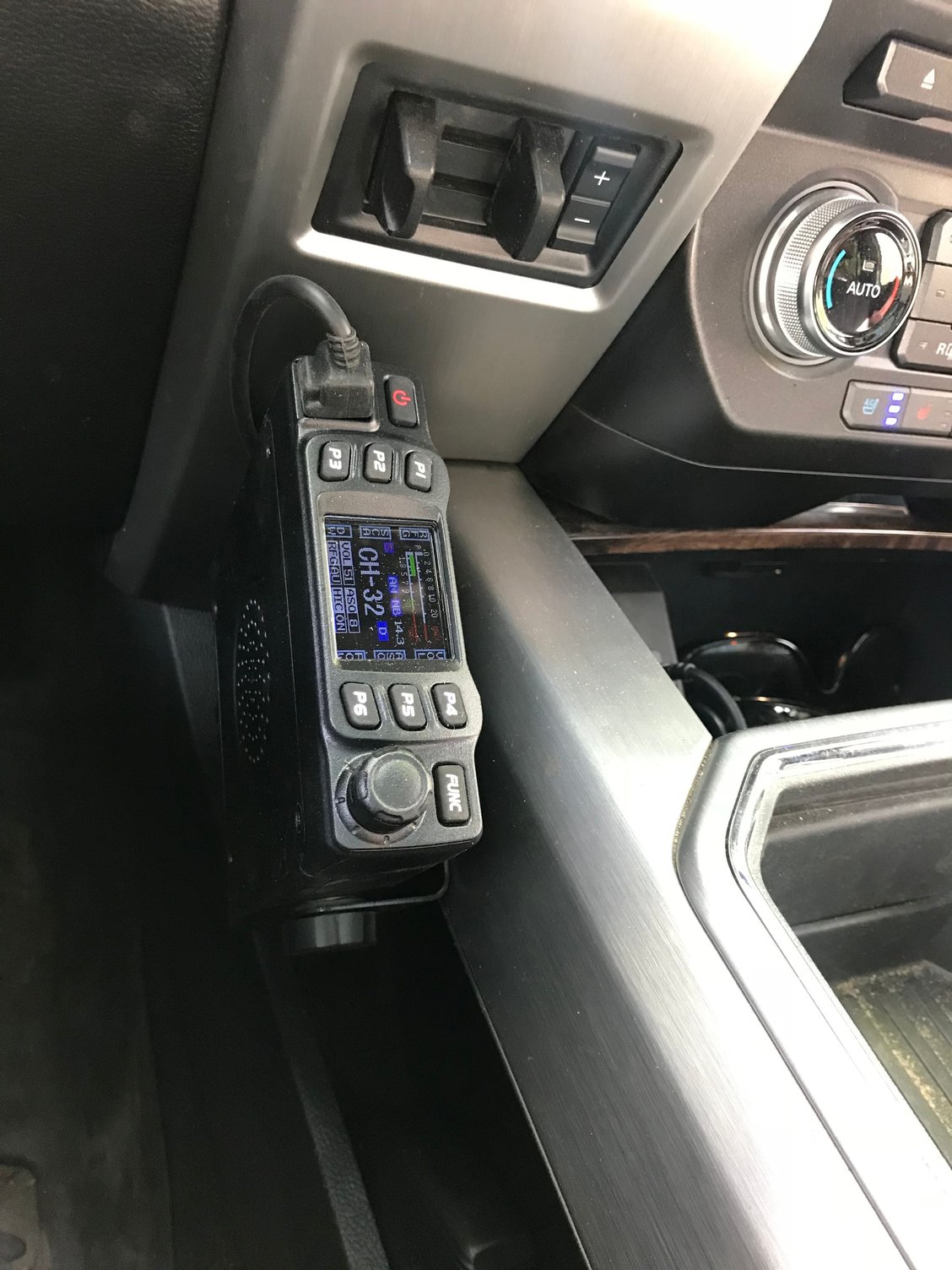

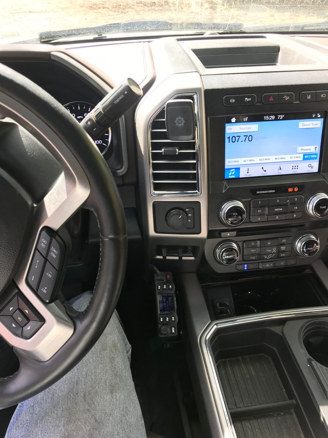

totally out of the way. Within reach of driver and can hear the built in speaker.

radio is a Stryker SR-94HPC. Works great!
