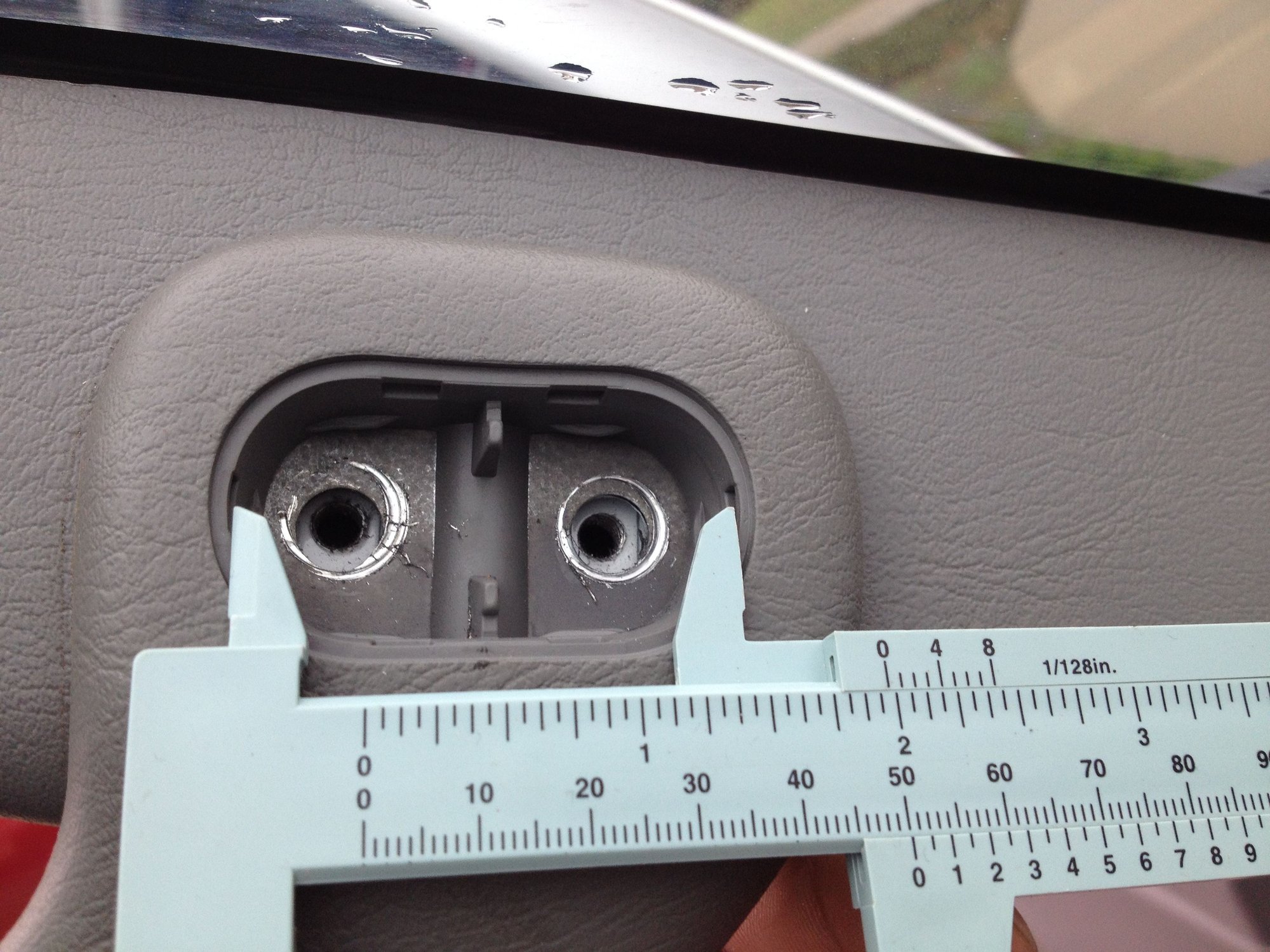

I had a Samsung Galaxy Tab 2 laying around that did not get much use. Discovered Torque Pro and away we go........
Could not find much for mounting options on a 2003 Super Duty other than a suction cup window mount, which I do not like. I did not want to just clamp one on the A-pillar handle either and really did not want to alter the A-pillar.

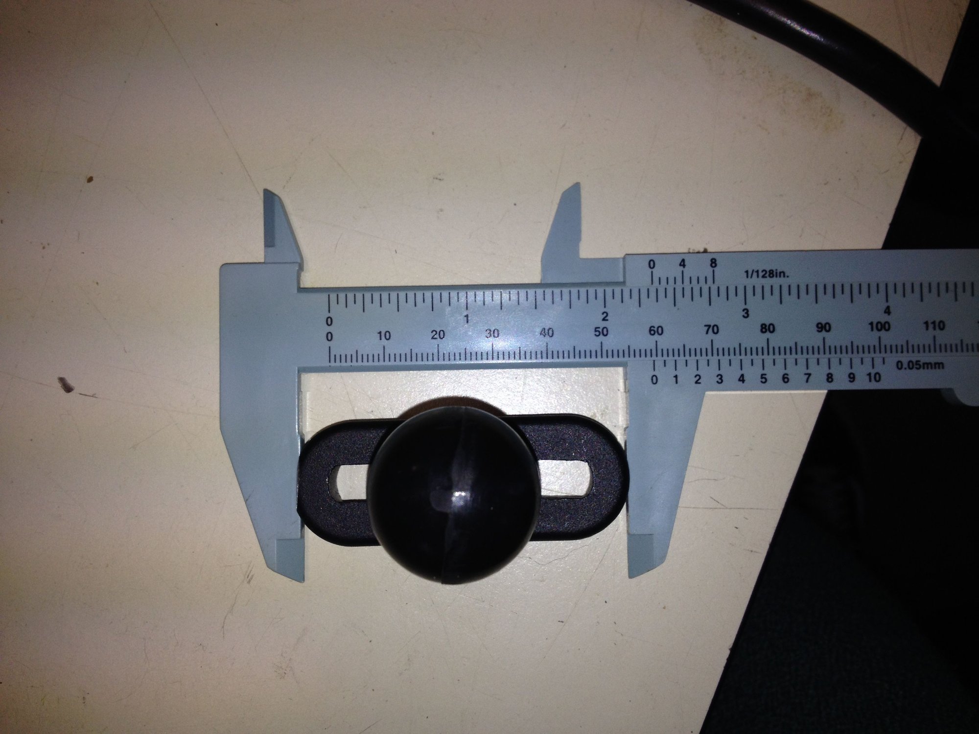

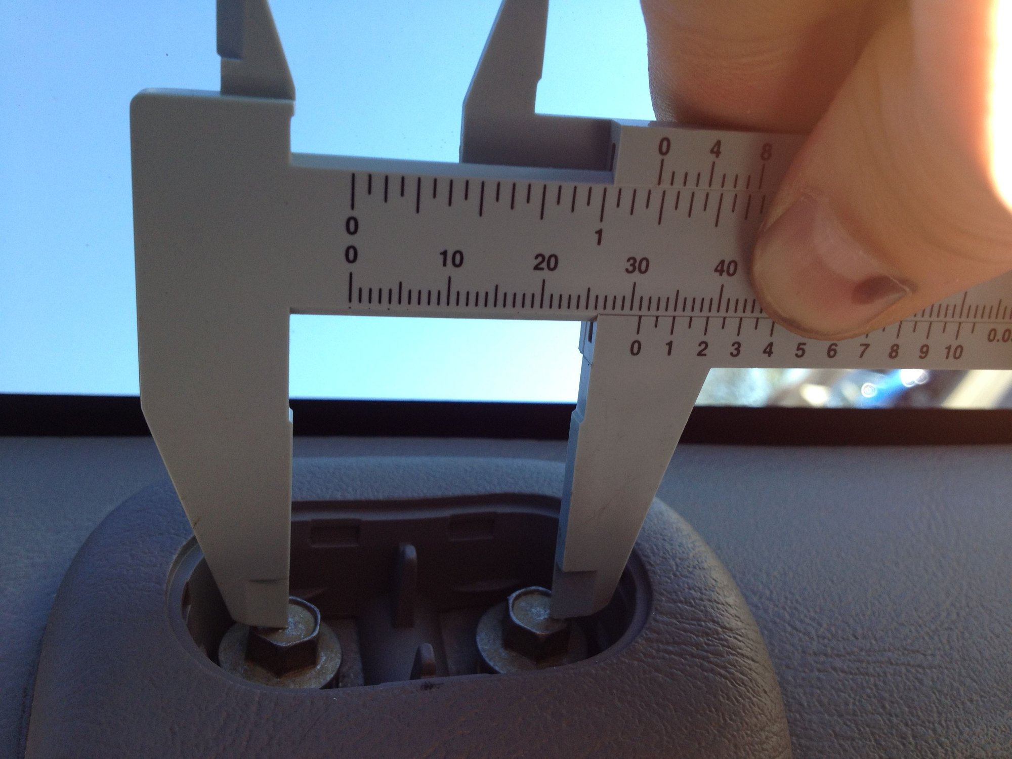

Searched around with some measurements to find a Ram base mount that allowed the bolt holes from the A-pillar mount to line up.

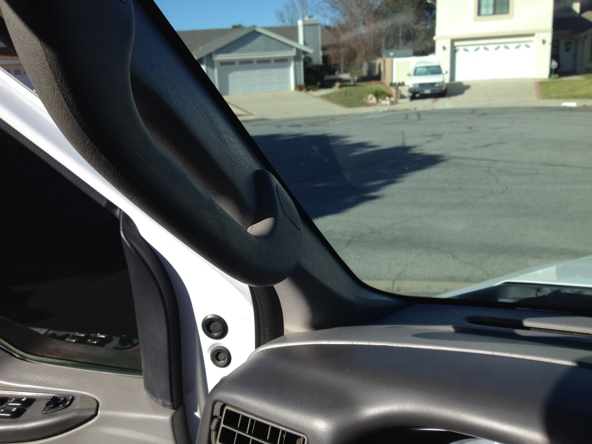

The first view without anything:

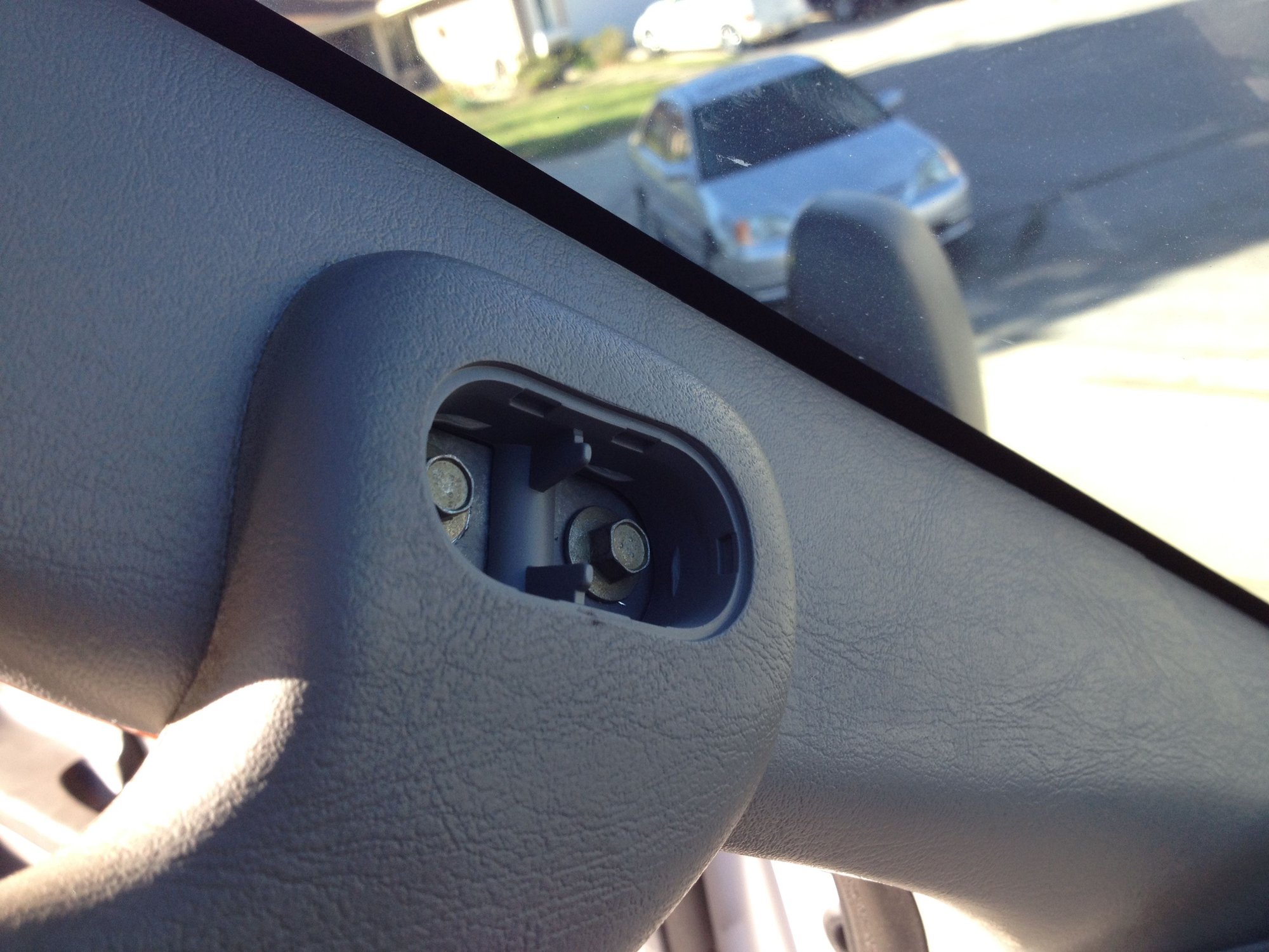

The location I was looking at using to mount to:

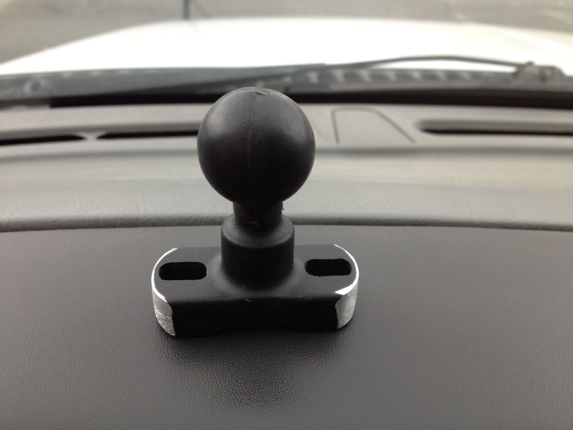

The Ram mount I found to dimensionally allow the bolts to align:
So the mount was a wee bit larger than the hole I want to put it in. So I ground down the mount itself very easily with a bench grinder:
The only alteration required to the A-pillar was to cut out the two little plastic tabs that stick out in the middle between the two mounting holes. A quick snip and they are gone. The little hump inside the hole is ok because of the V shape at the base of the Ram mount:
And then picked up a couple M6 x 30mm bolts and a couple washers (I could have searched harder for black but I didn't), and BAM!!

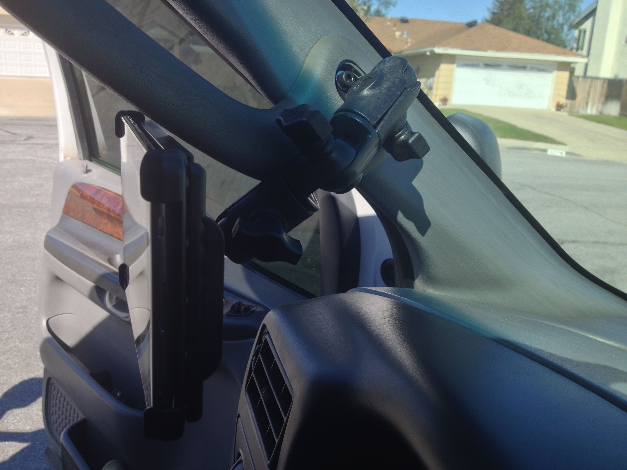

At first I attempted a straight Ram extension piece, but it would not allow the tablet to be where I wanted it to be. So I used one of these:
https://smile.amazon.com/gp/product/...?ie=UTF8&psc=1
The end results for my A-pillar:
Now I just gotta play with the Torque Pro a bit to get the gauges to the size I need and which ones on what screens.
The mount is SOLID too
