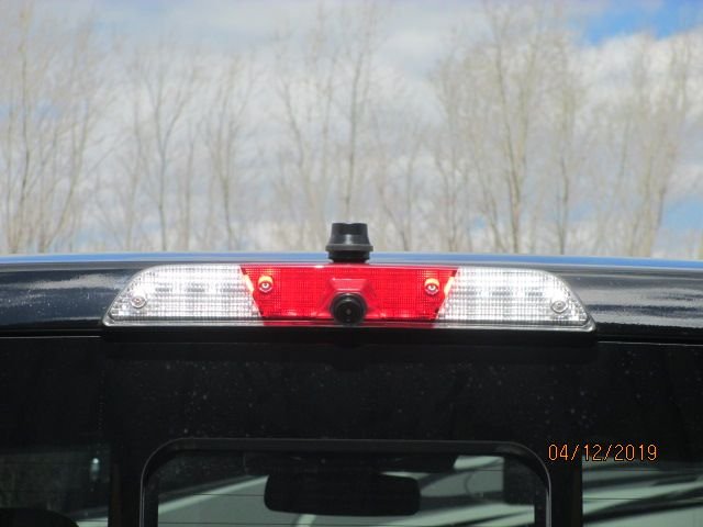

The cool thing about the Bullet Proof Diesel mount is that is sits low and I park in a 7' tall garage opening still. Leaves me about an inch to spare. Hope to have the radio install finished tomorrow and make sure the tuning is good. Here is what I have for pics.

bulletproofs website says not compatible with 3rd Brake Light Camera. Am I missing something or is yours a one off?
Old Apr 14, 2019 | 09:03 PM
  #65
Toyman's Avatar
Toyman
Joined: Feb 2004
Posts: 14,904
Likes: 76
From: Wayland, MI
Yes, it does say that. I also called them and asked. They told me that some trimming of the light would be needed to make it fit. When I got ready to install it I slid it up in place and it fit perfectly. From there I put it up on the truck and connected the wiring, then slid it back into place again to make sure it all fit. After that I ran the coax in, drilled the 2 holes needed and mounted it all in place.....mine worked, yours may need trimming but it should fit.

If you look where the antenna cap is that's where the interference would/will be. Mine did have some clearance issues there, but instead of trimming the 300 light I decided to just add a little clear RTV to the back side of the light. My thought is try that first and if it leaks Ill take it apart and remove the RTV and trim the lamp slightly. I have a dually so it wont see any automatic car washes anyhow. Ill try and get a few pictures of mine as well since I have a white truck and you can really see the way the mount works.

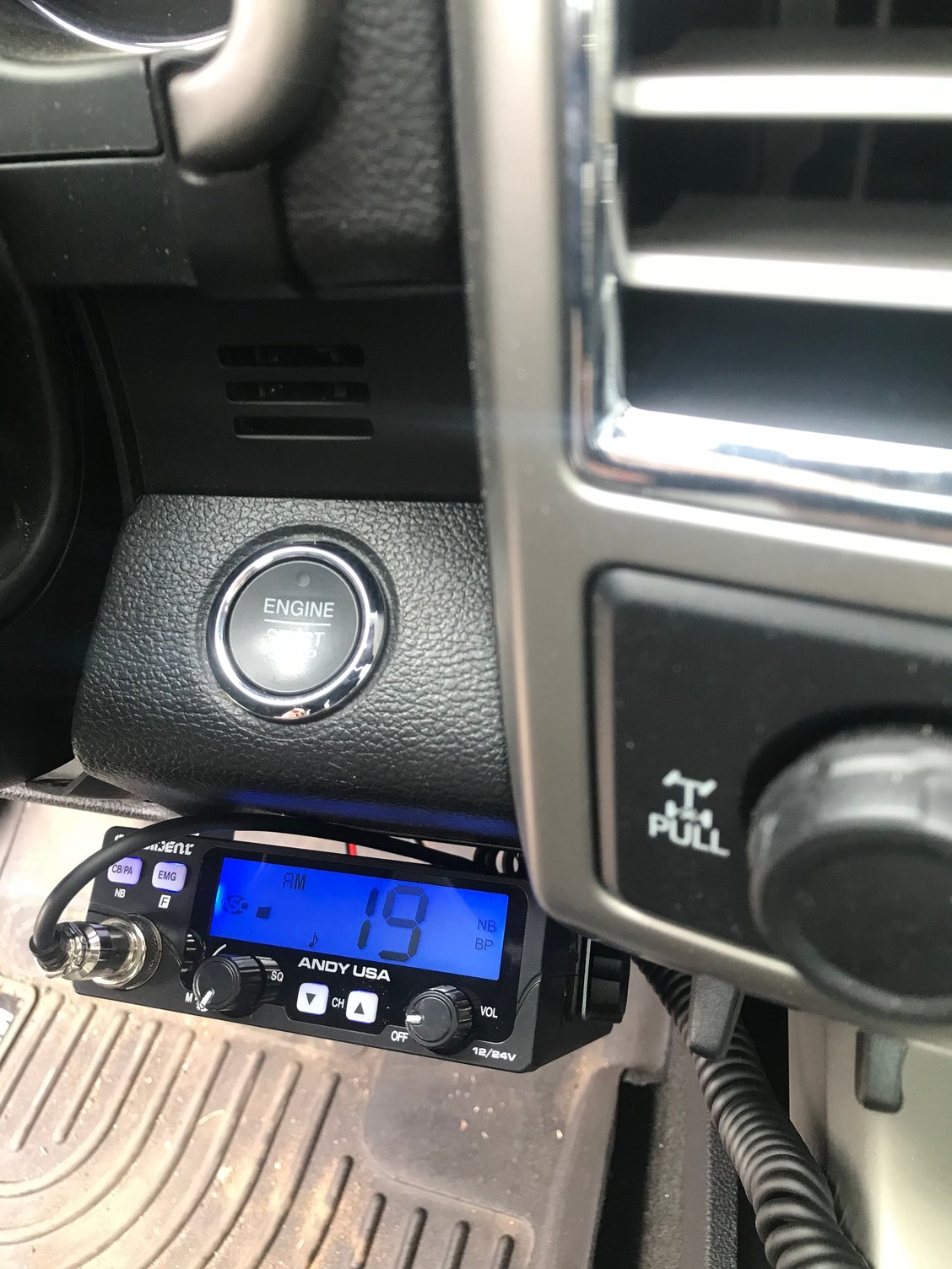

So I got my radio installed today. Running a President Andy, it’s been peaked and tuned. Deadkey at 5w and swings to 33w, was really happy that I got the SWR set to 1.3. Seems to reach out alright, did a couple radio checks.

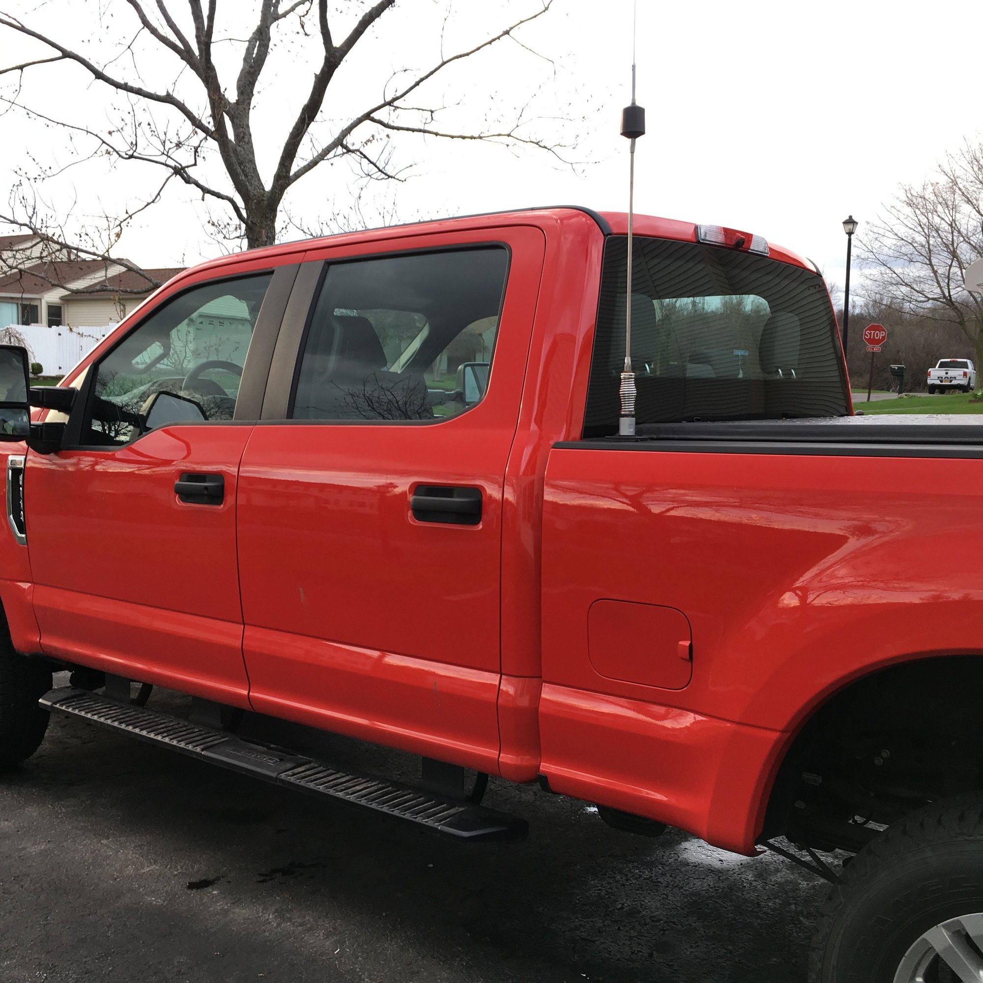

Following, I see where poor ground plane is a factor and people posting their radios. I saw a post about a firestik antenna being mounted but did not see an answer. On my old truck I had a 4' firestick mounted on the front bumper and it worked fairly well. I put it all away after reading the trouble people were having with the aluminum body. What is the chance of this large antenna working well on the front as it did on my 2005 Super Duty? I m trying to avoid running the wire only to find it is not useful. I don't use it often but we are planning some long trips and miss the information it can provide. I do like the small radios available and the price seems very reasonable for a once in a while use. Thanks for any insight. I am no radio man but do like information while driving.
Old Apr 20, 2019 | 01:32 PM
  #69
alabamatoy's Avatar
alabamatoy
Joined: Jul 2002
Posts: 196
From: Madison USA
A good ground plane is an RF reflective surface...it does not need to be magnetic, nor metallic, just RF reflective. So an Al ground plane for RF works fine. The big problem with the Al is that you cannot use a mag mount antenna base.
Mounting an RF radiating dipole antenna with no ground plane reduces its effectiveness, but does not nullify it. So mounting a firestick on the bumper works...it just doesnt work as well as it might with a good ground plane. Get the SWRs down low (as close to 1:1 as possible) and drive on.

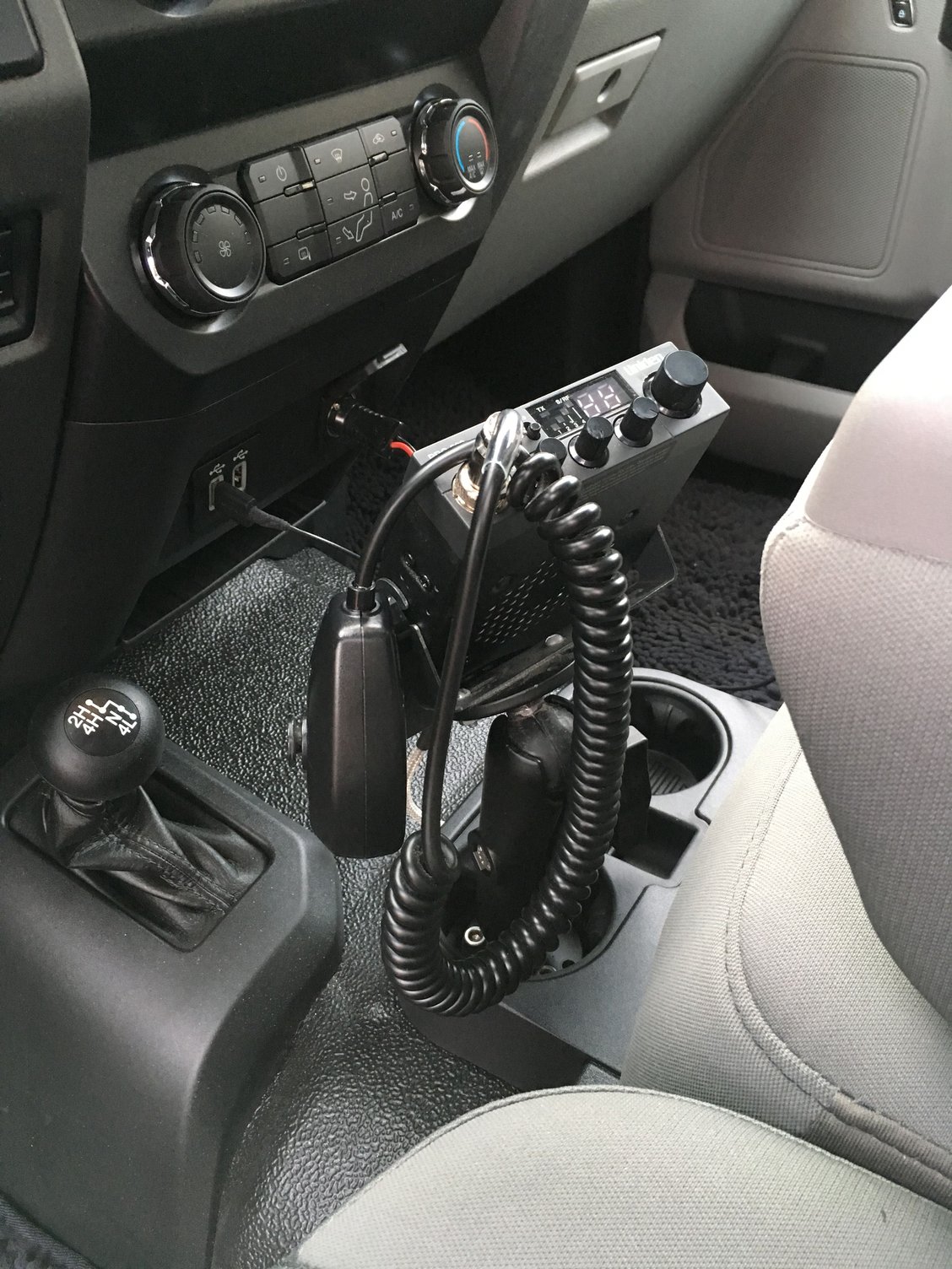

Mounted my Wilson 2000 in a Breedlove Stake Pocket mount, mounted my Uniden Pro20 on RAM MOUNT 1-1/2” hardware, a circular ball mount bolted to my XL/STX front ‘console’ removable cup holder, tucked cabling along the edge of my ‘rubber’ flooring, for now using the lower 12V power port, may add a microphone mount.
