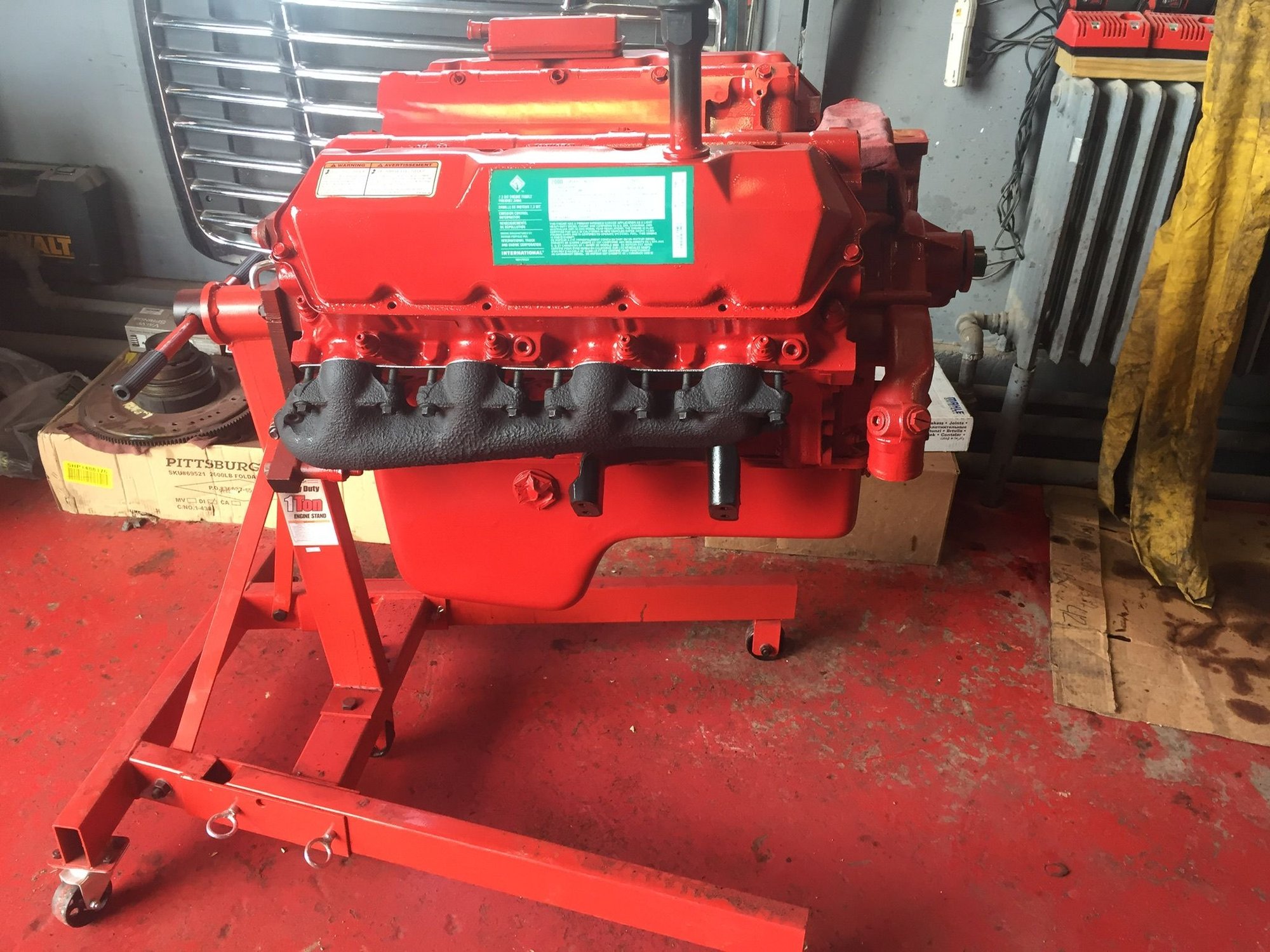

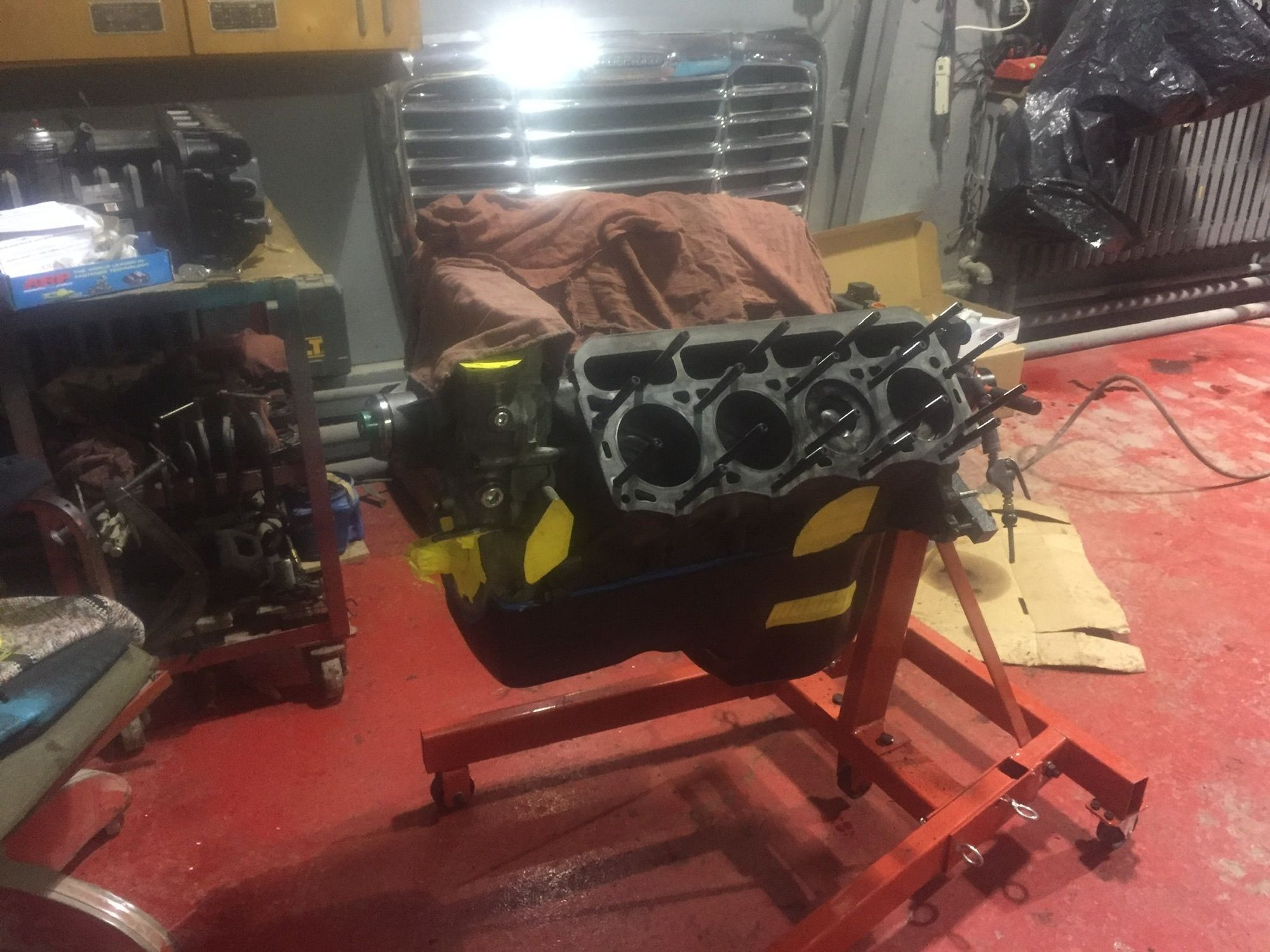

And here’s the mandatory picture. This is how it sits, it’s got a bag now
Well thar she sits, bare *** naked. You're wasting no time on this project.
Old Mar 15, 2019 | 12:45 PM
  #67
Eaglescout94's Avatar
Eaglescout94
Joined: Feb 2014
Posts: 1,041
Likes: 72
From: Springfield
I’m still probably a week out till I have enough parts to put it together. And yes, I’m trying to get it done fast, I’m driving a pt cruiser at the moment and it sucks. I want my monster back

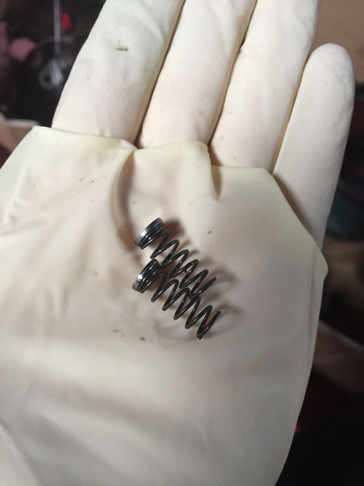

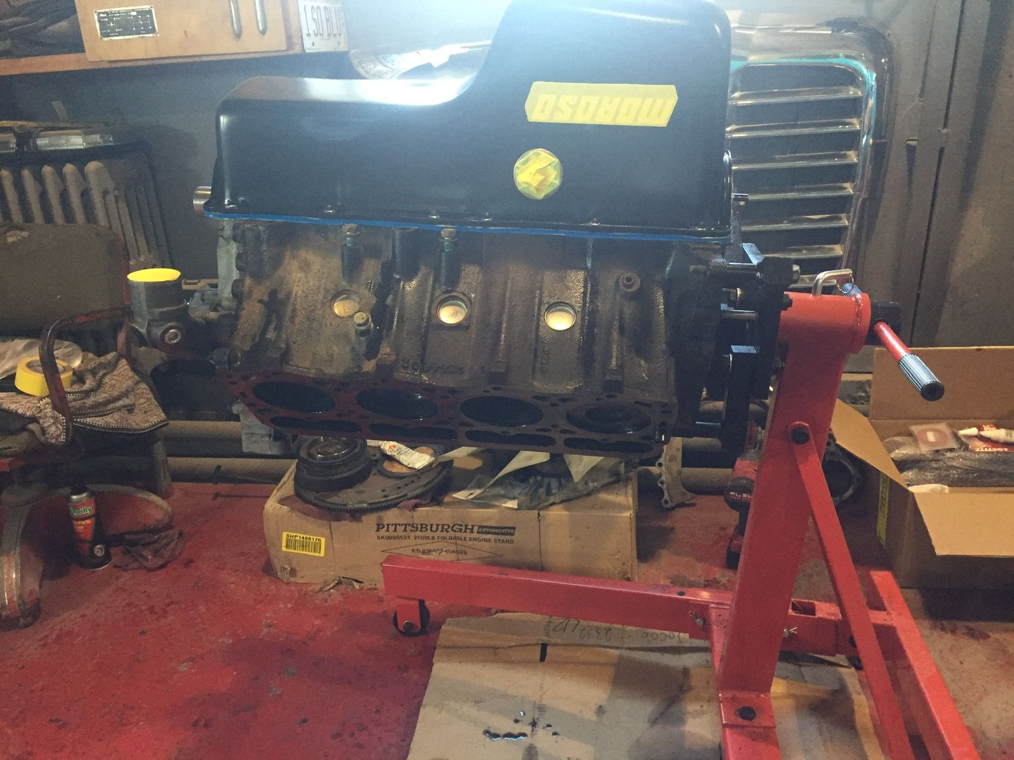

From: Springfield
I assume these are the valves that i can remove from the HPOP to eliminate the need for the oil crossover line? They were th only thing i could remove when i pulled the feed lines off the pump. Stil waiting on more parts before i can start putting the engine back together but have one question to help me clean. What can i use to help clean all the oil/grease and other crud off the engine? I tried heavy duty oven cleaner, the oil laughed at it, i tried a purple degreaser, it didn’t do anything put turn black, ive scrubbed with brake clean and a wire brush and while it works best so far its very slow going. I really should have sealed the engine when i pulled it so i could use the steam cleaner and I wouldn’t have any issue now but i spaced out since i wanted it stripped so i could get parts ordered. I’d say live and learn but hopefully i wont be in the engine for a longggg time now.

From: Douglassville, PA
Those are the springs and I find that Methyl Ethyl Ketone (MEK) removes things that other solvents won't but it is nasty stuff and might not even be available in CA. I get it at Lowe's by the gallon and you'll either want to work outside (preferable on a windy day) or in a garage with flow through ventilation. A big shop fan would even come in handy. It evaporates quickly so overnight soaking is not easy, might not even be an option.

From: Springfield
Glad those are the springs, I pulled them and kept looking for a little till I decided those had to be it since nothing else is there. Glad I don’t live in California then. I’ll stop by there today when I’m running around and see if Lowe’s has some. Ive about got the valley cleaned just have the sides and back of the block to do. Hopefully the paint scheme turns out as good as I think it will.

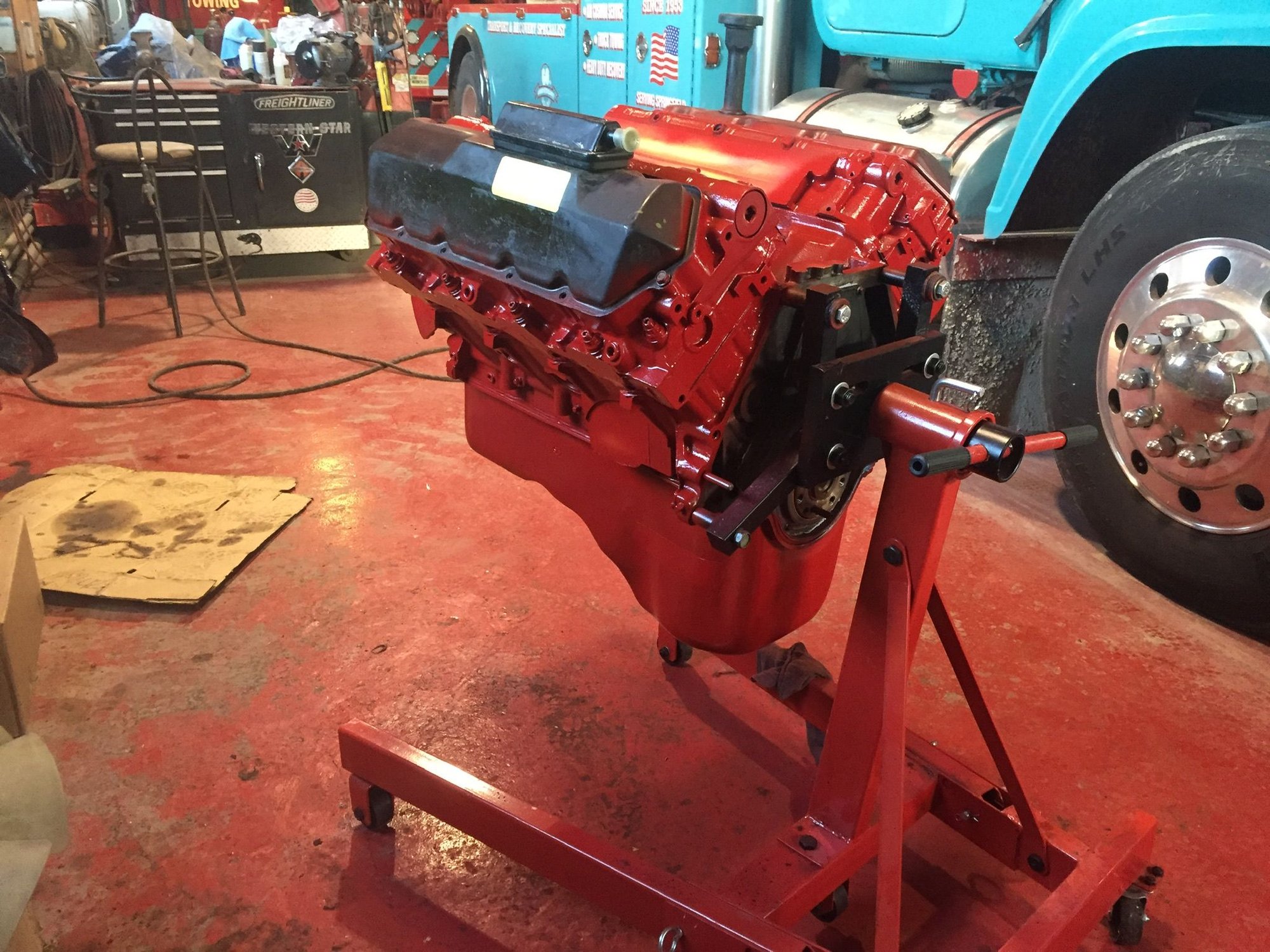

From: Springfield
Its got a coat of paint on it now but I still need to install the HPOP and reservoir, put together the new oil cooler, paint and install it plus my injectors, glow plugs push tubes whenever they finally show up. I’m planning on finishing pressure washing the engine bay the end of the week and painting the frame as far as i can to make it look even better. If everything works like I’m hoping, and my push tubes show up soon, I think i could be driving my monster next Sunday evening.
