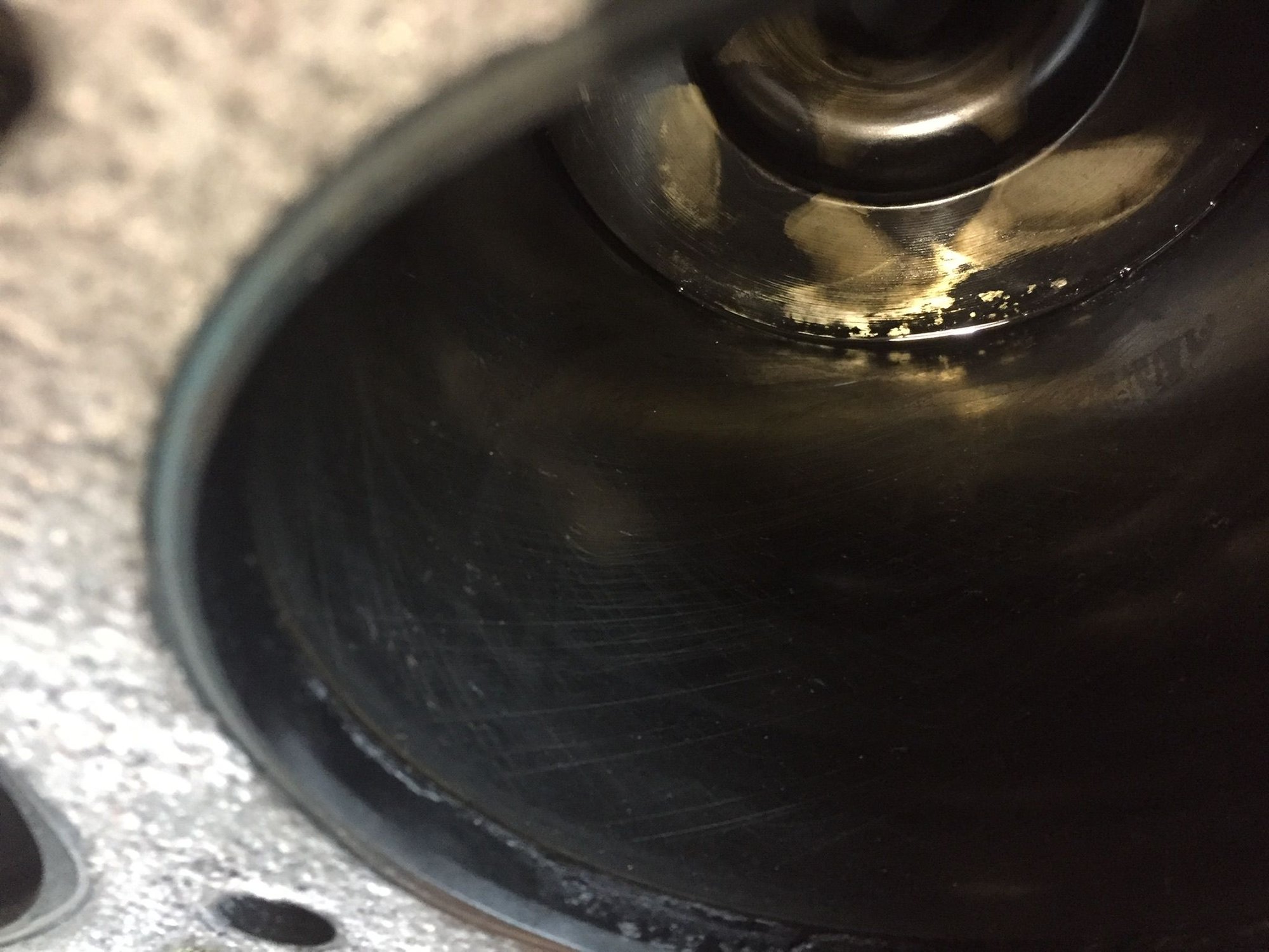

The one thing I’m curious about, 3 of the cylinders on the drivers side had shiny spots on the pistons and the passenger side had some too but not as much. Isn’t shiny piston surfaces caused by a coolant leak or water being missed into the cylinder and cleaning off the soot from the piston?
