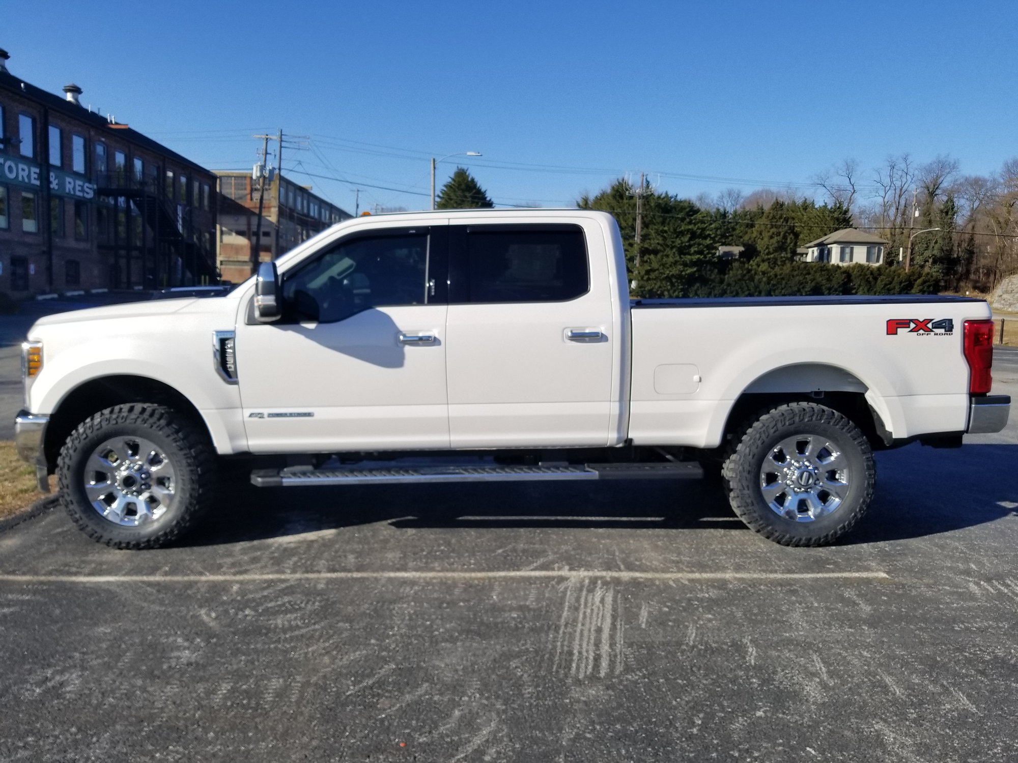

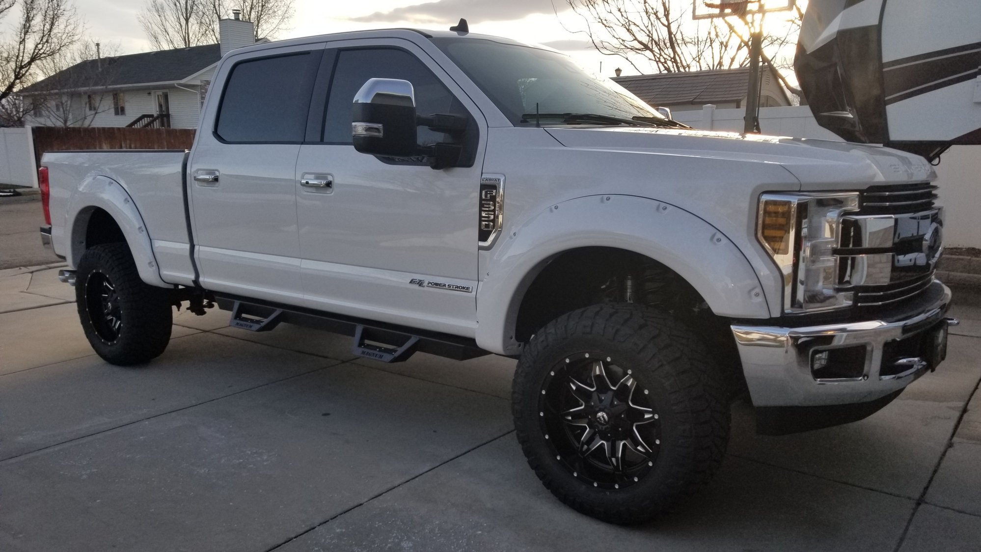

I agree to hang in there Sounds like alignment to me. I did a 2" BDS Level Kit with Fox Shocks. Added 35" Nitto Ridge Grapplers (12.5" wide on 20" Fuel Wheels). Runs solid, but my friend who did the work does need to adjust the steering wheel. It's a little off. Almost unnoticeable.

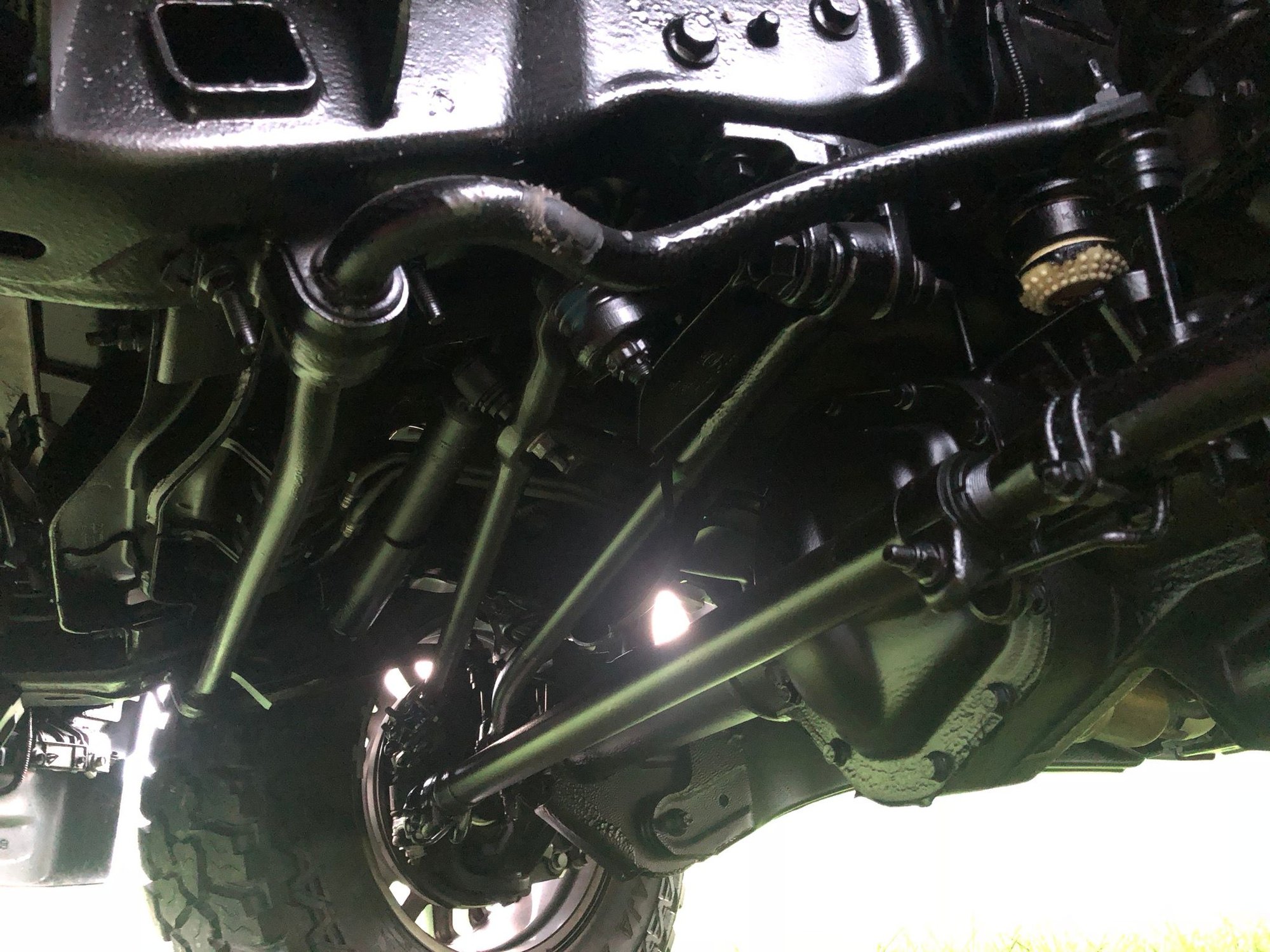

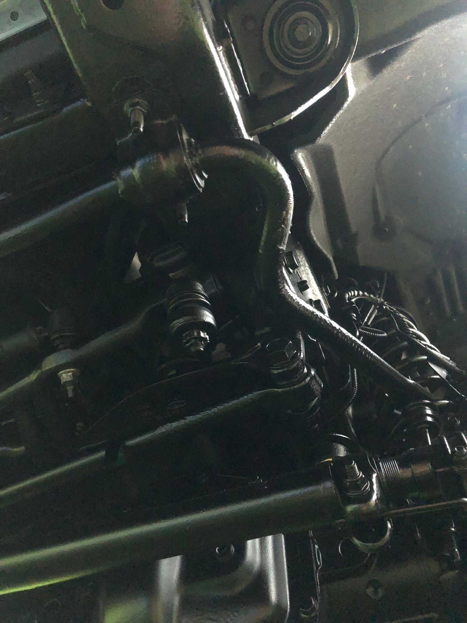

On stock 20’s they rub on the sway bar and radius arms but no body issues at all. I’m replacing the sway bar and radius arms this month. Not the cheapest way to clear 37’s but I wanted to keep the 37’s as far in board as possible. The high clearance radius arms are a proven thing here from PMF or Lewis, but no one to my knowledge has done a high clearance sway bar so I’m having one built. Pics below show the sway bar rub points - totally solvable.

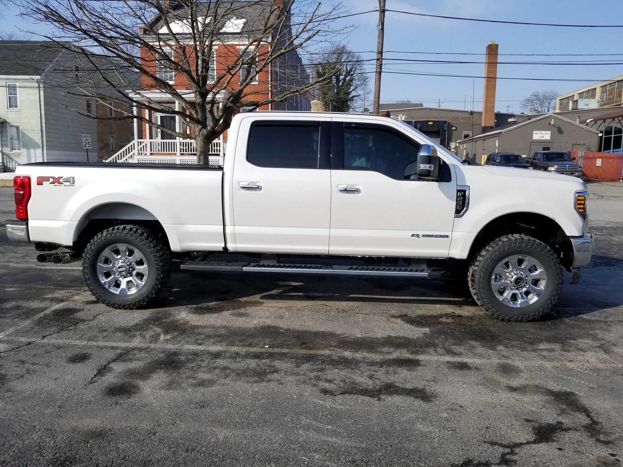

Trail Master 2" level. Its 1" higher in back like i wanted. Snow plow prep package. Had it installed and aligned at 4 wheel parts for 223 out the door. Figured i couldnt go wrong at that price. Tires are cooper stt pro 295 65 20 which measure 35.4"
before and after pics

Looks awesome!! It's amazing what 2" will do for the look of these trucks. And you got a steal of a price. I'm still digging you Cooper's too, very nice!!
