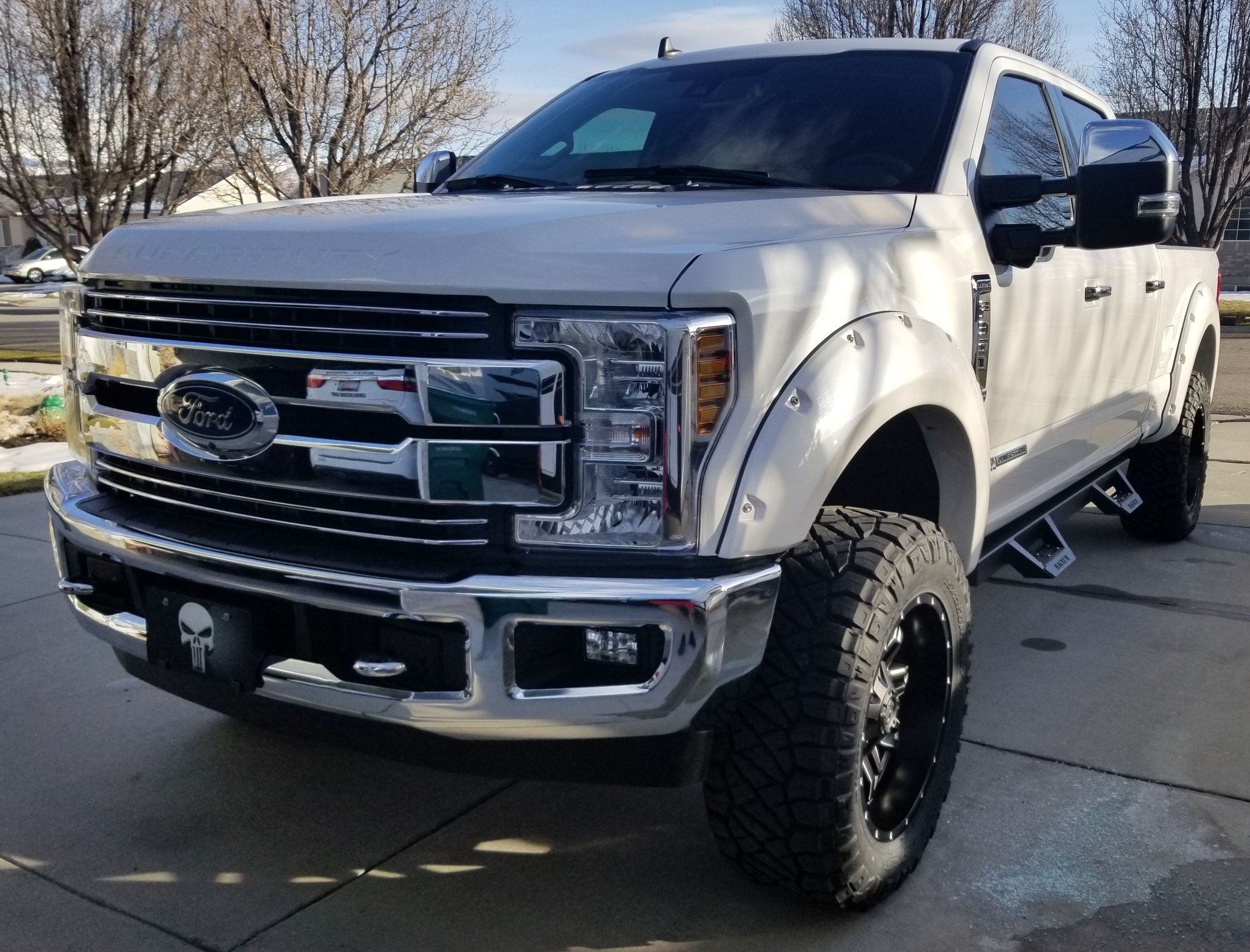

-24mm I believe
They stick out perfectly, if you add Fender Flares. Without Flares, they stick out a little too far, for my liking anyway. That photo is before I added the Bushwacker Fender Flares.
Old Mar 2, 2019 | 09:19 PM
MBaldo's Avatar
MBaldo
Joined: Mar 2019
Posts: 486
Likes: 8
From: Salt Lake City
Even with Flares, they are out a bit. 11.5 wide Nitto RG's may have been perfect.

Fuel Lethal Model # D56720008245
Definitely -24
3,700 lb rating (I pull a 44' Toy Hauler)

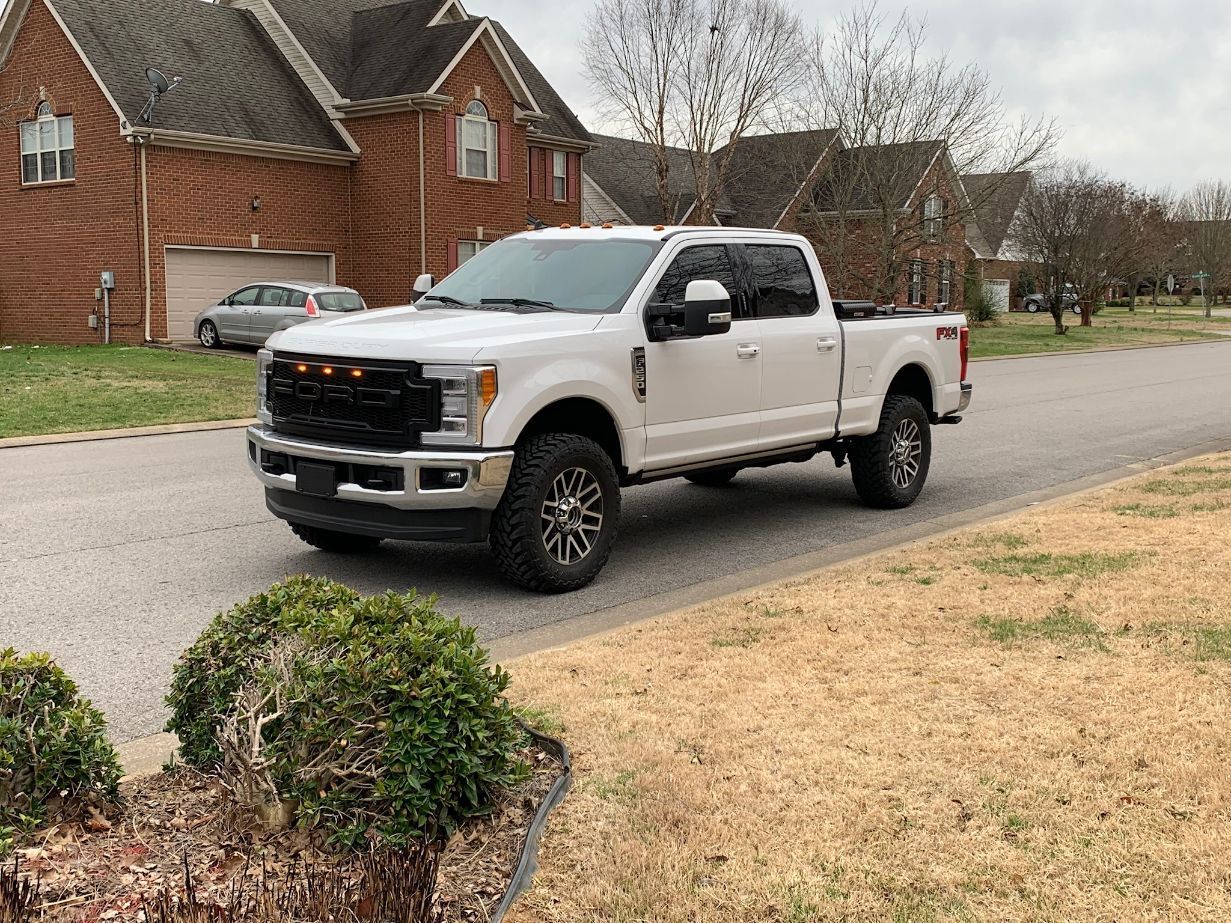

So, after considering, I think I definitely want around a 2" level and no more. While that isn't a lot, I also don't want to risk ride quality. I'm 40 years old. While not old, I don't want a $75k truck that rides like a lifted 1990 Toyota. I take this truck on some pretty long road trips, sometimes with a 6000 boat behind me, and most often with my wife and 3 kids with me. I also use the truck as a daily driver and have business partners, clients, etc riding with me. So, even if it costs more, I want the best ride quality I can get. Is the Carli that much better and worth the money, or will I even be able to tell a difference with a 2" level?
Also, attached is a photo of my truck with the new tires. I went with Nitto Ridge Grappler 35 x 11.5 x 20's, and I think they look great. I didn't want the 12.5's because I wanted the tires to barely stick out further than the wheel wells and I like a skinnier tire to resist hydroplaning in rainy weather. These aren't disappointing and I think they look great with the OEM wheels. I don't even want to change out the wheels and put aftermarket on. I love it just the way it is.

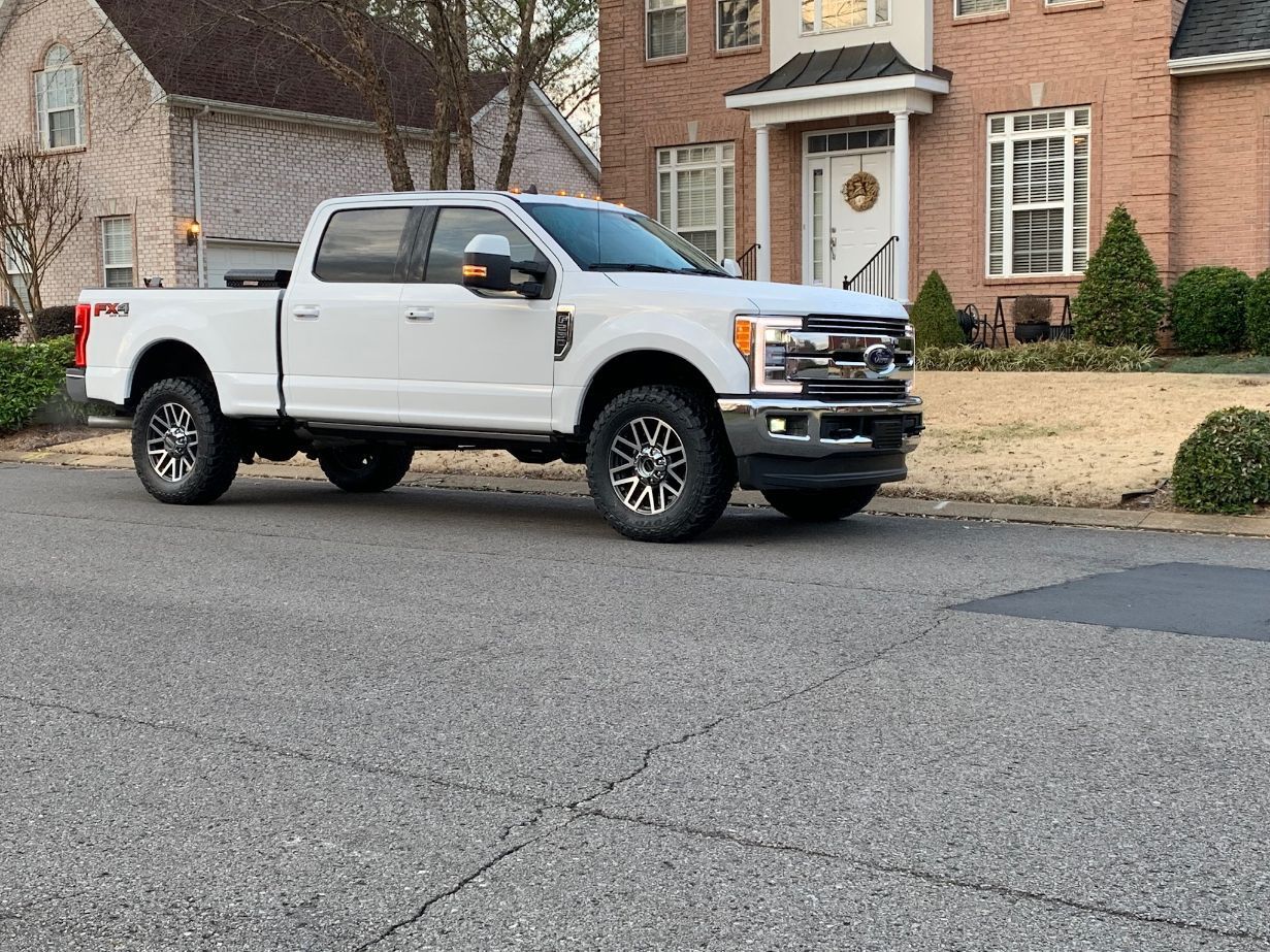

so I can even notice a 1" level
pre 1" level (and pre grill)
1" level
1" level
I also don't like any rear rake while towing so I also wanted a 1-2" only level. See below before 1" level and after.

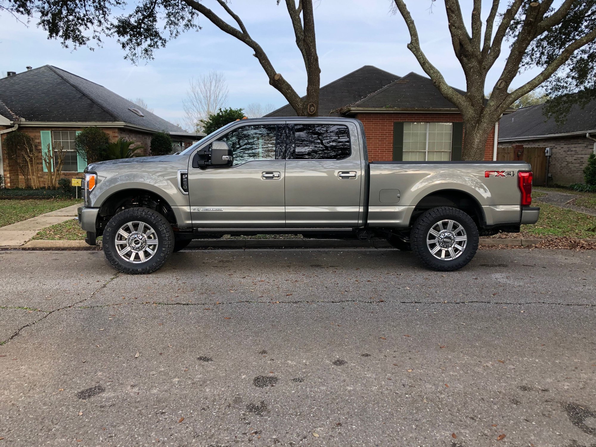

Originally Posted by rewillia
Here's mine leveled, completed yesterday; 19 SD F250 6.7L CCSB FX4, Front +2" BDS under-coil pods with new track-bar bracket and Rear -1.5" Spacer drop; Bilstien 5100's (both F&R) and Nitto RG 35/12.50/r20 F-125Q's on stock OEM 20x8J 40mm wheel set including matching 5th spare Wheel/Tire underneath.
Looking for Advice!
Since having the leveling worked done
as described above last week (which was done with only 280 miles on the stock truck) I was only able to drive the truck locally, until a few days ago when I drove a one way distance of 200 miles on the highway (to start a new job) where while on the road I since have experienced both some "minor" bump steer (i.e. on expansion joints, pot holes, etc.) as well as a very slight pull to the right (almost unnoticeable) yet enough that I need to maintain corrective hold on the steering wheel at highway speeds and such that I am concerned as "something" is clearly not right (and pissed about it)!
I called the shop that did the leveling and installed the 35/12.50/r20's on it for me and they said, "well maybe you threw a well weight off of one of the front tires or maybe the alignment shop they use missed something!". - to which does not inspire confidence (to me) that I choose the right 4x4 off road shop to do the work for me. Since I'm now 200 miles away and have started a new job, I don't have the time to take the truck back to them so I've scheduled a service appointment with a big Ford Dealer here in Houston (Joe Myers' Ford) next week to have them check and/or do an alignment and re-balancing of all four tires as the 1st step and will have to wait to get the results of their findings. Note: all four shocks were also changed out to the Bilstien 5100's in part with the leveling work performed. (I have also since looked and verified that the wheel weights are in place on the inside of both front wheels)
Not knowing much about what's involved or all the options to be considered in terms of leveling a truck, The shop that did my work had first quoted me the cost of the leveling/lift and installation to include replacement of the OEM track bar with an adjustable one of which I accepted but once the work was completed they stated that changing the track-bar was ultimately not needed since they replaced the OEM track-bar bracket instead{?}, so here I am now at the mercy of finding another shop (or the Ford Dealer I'm going to take it to) to get this right.
Was I wrong to expect (or mislead to be believe) that leveling the stance of my truck and upsizing to the stated tire type/size as indicated would not result in my truck having a far "harsher" ride and noticeable feedback at the steering wheel as I am encountering?
I knew "going in" that by upsizing from the stock LT 275/65/r20 Michelins to the 35/12.50/r20 Nitto Ridge Grapplers I would be sacrificing some degree of ride quality simply do to the difference in tread pattern and the 'footprint" of the wider tires - but I did not expect it to be what I am currently experiencing.
Am I missing something (information/knowledge) as to what to expect)?
