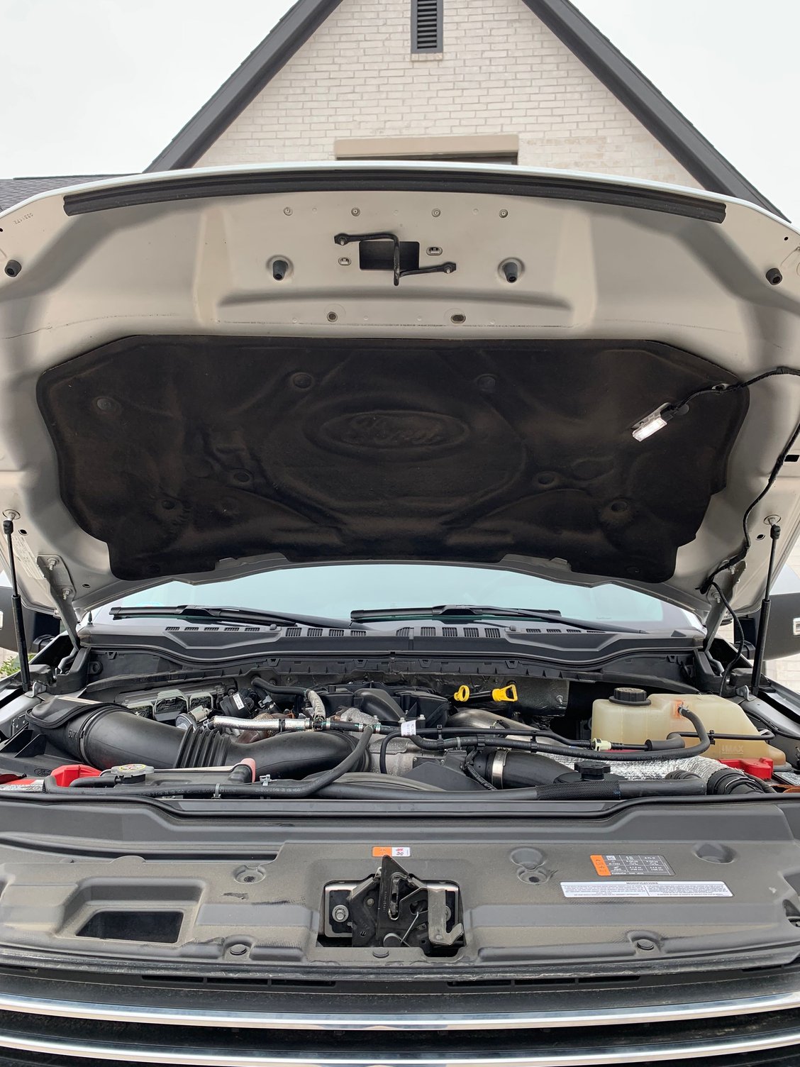

No1Hookman is correct. The 17-19 pad will fit the 2020 hood as the hood shape and fastener locations are the same. But the 17-19 pad has the light cut out in upper driver’s side corner. The 2020 light is now on the lower passenger side. The 2020 light could be relocated to the 17-19 location as the attachment holes are still there in the 2020 hood. One would need to splice in the additional wire. I don’t see any clearance issues with the new intake.
I traded my 2017 fully loaded Lariat F450 in on a new 2020 last week. Same everything except I added the PTO and front fender liner options. (Btw...the fender liner is a full molded plastic liner that overlays the standard felt liner. No dealer that I talked to here in the Dallas, TX area new what it was and no picture on Ford’s site when building one online. Low cost option, so I thought I’d order it and find out for myself. Great option for the trucks that live in the mud and snow as it is more durable and will clean easier.)
Anyways, I’m standing here with a new pad for the 17-19 and a 2020 truck. I’ve decided to return the pad and wait to see if Ford comes up with one in the next six months. If not, I may relocated the light. Noise reduction and the unfinished underside are big motivators for me. In the mean time I’m going to research if any F150’s have a pad that will match. Worth a shot.

So I haven’t opened the box for fear of a restocking fee or worse not being able to return it since it was a special order part. I called my parts guy and he confirmed the PN I have is what his parts catalog shows for the 2020MY. He gave permission to open the box and check fitment without any penalty if I can’t use it. I’ll update again this evening after work.

It’s wrong. Cut out for the light is in the upper driver’s side corner. No relief for the 2020 light location.

Nope. That’s the number they currently show for the 2020. And it’s wrong.
I’m going to wait and see if they come out with an updated part. Kind of a bummer though. I would rather get it on there now before the underside of the hood starts getting dirty. I’m not sure how easily the primer like finish will clean.
