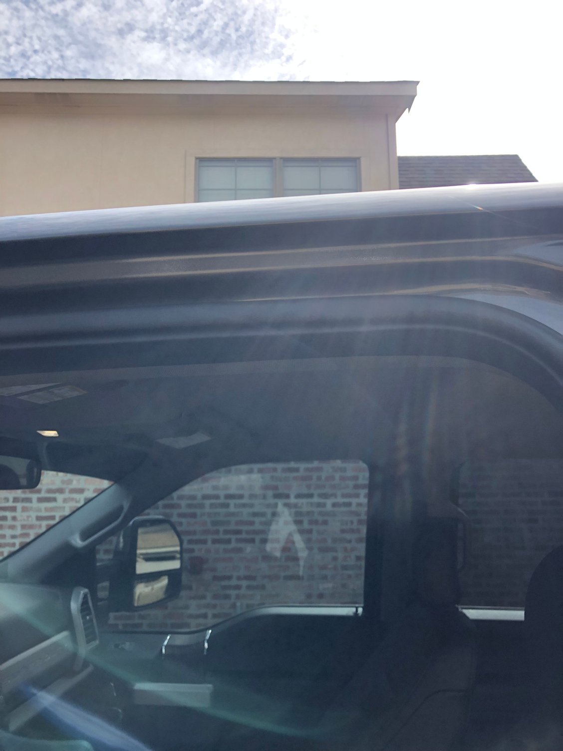

Brand new truck. Has a slight vibration/looseness at the top of the door. If I pull the door slightly the weatherstripping makes a better deal and the noise goes away. It’s not terrible but kind of annoying because it’s right next to my ear. Anyway to tighten this up?
Area that I notice the noise

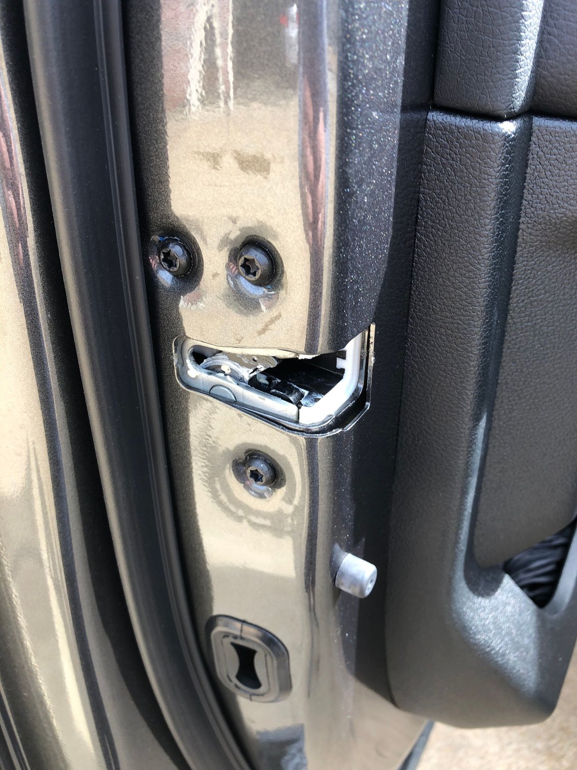

Had the same problem on mine as well. A small adjustment of the latch catch (located on the b pillar) solved the problem. Keep in mind that the latch catch is adjustable up/down and in/out so you may want to mark the current up/down location with a piece of tape prior to loosening.
The idea of the adjustment is to pull the door slightly tighter to the body upon closure.

The door is attached to the hinges with 2 bolts. One on the top hinge and one on the bottom hinge. Loosen these 2 bolts to adjust the gap if the door.

My 2017 crew cab had the same problem when new. Dealer installed new door latch with only a slight improvement. I did some searching on the interwebs and found that adjusting the door via the hinge was the way to go. Did it myself in a couple if minutes and fixed the problem.

Glad to hear it might be fixable. I know the service advisor looks at me as if I’m moaning and complains but it’s not a lot to ask. I usually turn up the volume and don’t hear it but it drives me nuts knowing it’s there.
My wife’s new Honda Odyssey is a lot more solid as far as build quality is concerened. I had issues on my 15’ F150 and had hoped everybttwould have been tightened up in this body given its the 5th year of prosuction.
