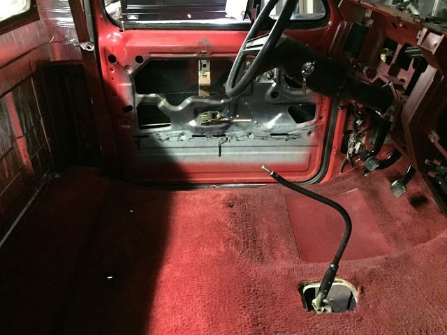

Speaking about button part of the door - there're big gaps and there light coming through.
What will be a good fix to that? I don't think new weather strip will fix it, the one i have right now is not to bad. Here is a picture (the gap looks bigger then on the picture):
Old Dec 2, 2014 | 09:56 AM
reamer's Avatar
reamer
Joined: Jan 2001
Posts: 3,789
Likes: 26
From: Connecticut
Getting it aligned as mentioned above will bring in the bottom. (that adjustment will be made with the bolts on the door.) Use the hinge-to-cab bolts to align the door up and down, and closer-further away from the striker, relative to the cab, then align the door in-and-out, so you can run your hand from cab-to-door with out feeling a "bump."
this will close the gap on the bottom, but keep an eye on the top from opening too much.

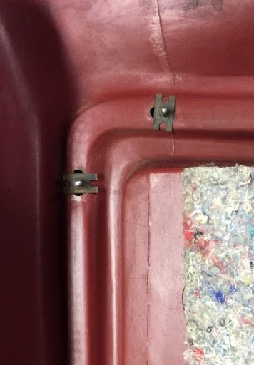

How do i remove this metal clips on the door panels? I need to remove the trim without braking it:
Old Dec 2, 2014 | 12:20 PM
Gary Lewis's Avatar
Gary Lewis
Joined: Jul 2010
Posts: 32,875
Likes: 48
From: Northeast, OK
Use a small screwdriver to pry up the lip on one side that locks the thing on the stud. Do it gently so as to not break it, but if you spring it you can flatten it with pliers before placing it back on.
