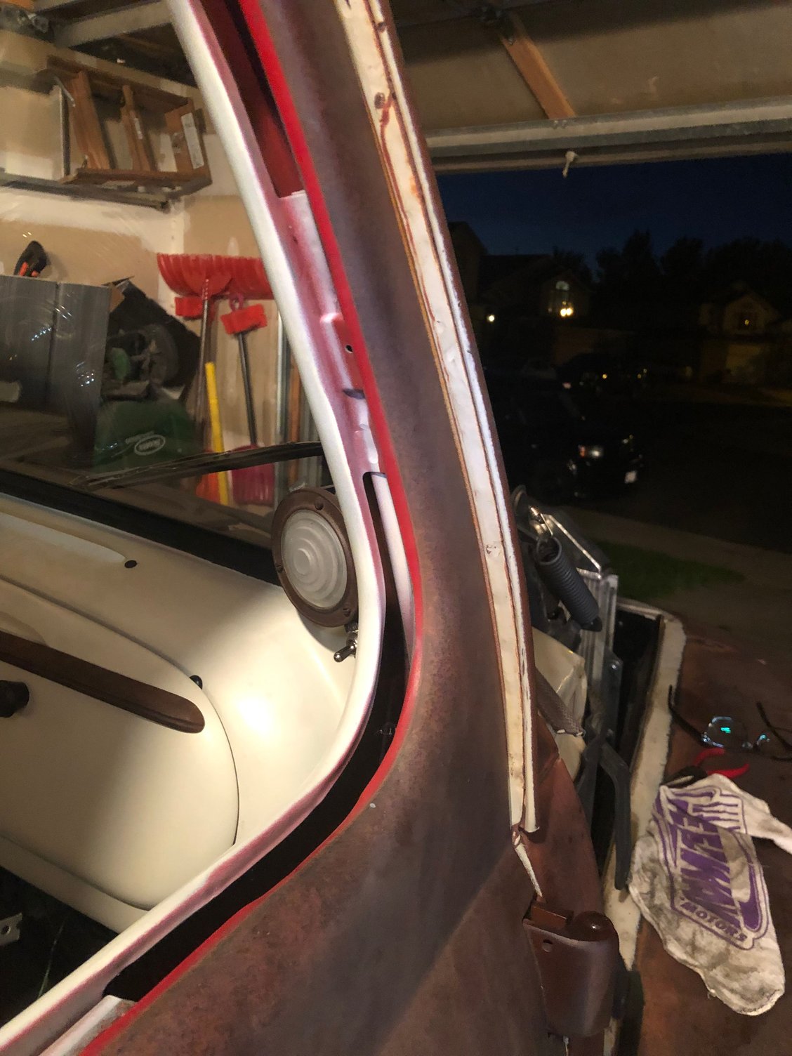

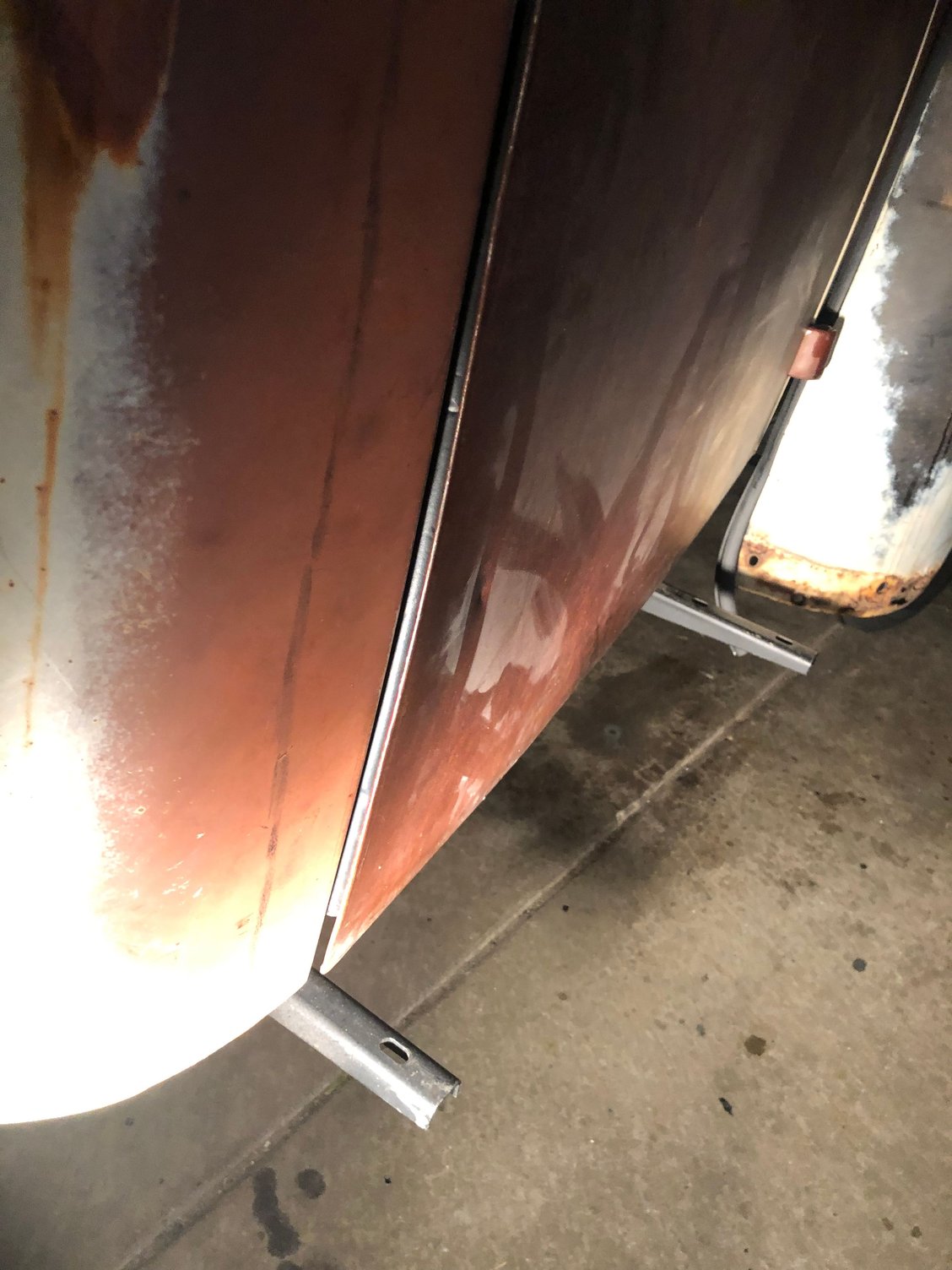

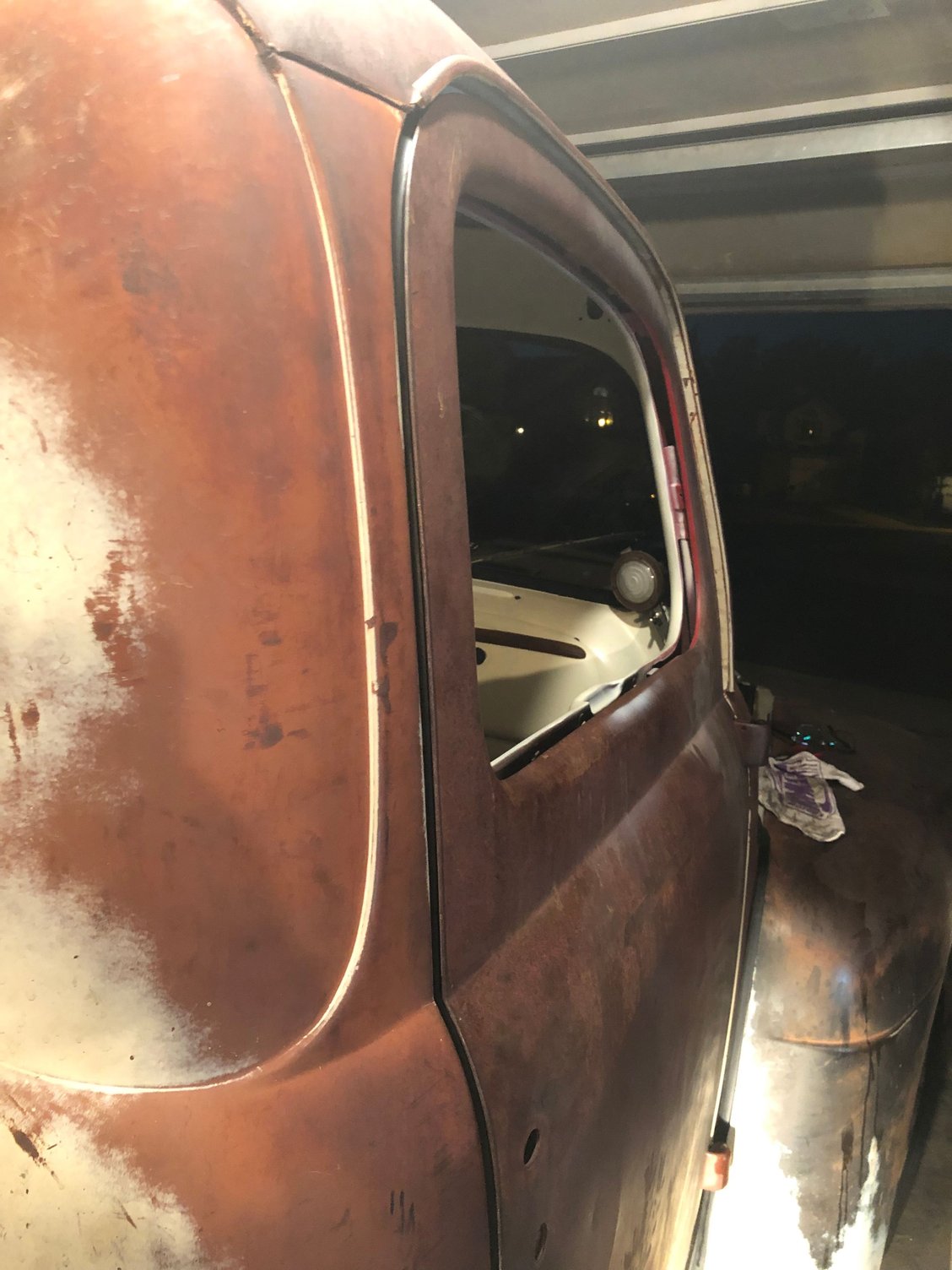

My cab was missing passenger door (and hinges), so I snagged one (with hinges) from a yard.
Any tips for aligning door, adjusting hinges at the door sill? Or, perhaps the door is bent up top?
New seals, and I didn’t want to slam super hard, but as you can see when closed there is a big gap (inboard) up top at the front. Rest of door doesn’t seem too bad, maybe a bit out on lower rear bottom. I think the top hinge is outboard as far as it could go, but maybe I’m missing something simple.

Well, that was a bad idea (on my part) to try that method… I don’t know if I slammed too hard or in wrong spots but the ‘rebound’ leverage seems to have bent the upper hinge plate. Now my door won’t even come close to closing.
Tried beating on it, heating it, using engine hoist, but it isn’t gonna be easy to get a short length of 1/4” steel to bend back. I’m afraid I’m going to have to remove the damn hinge pins now so I can isolate it in a vice I guess. We all know how much fun that is…
One step forward, two steps back.
