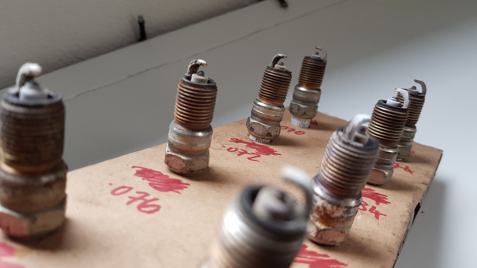

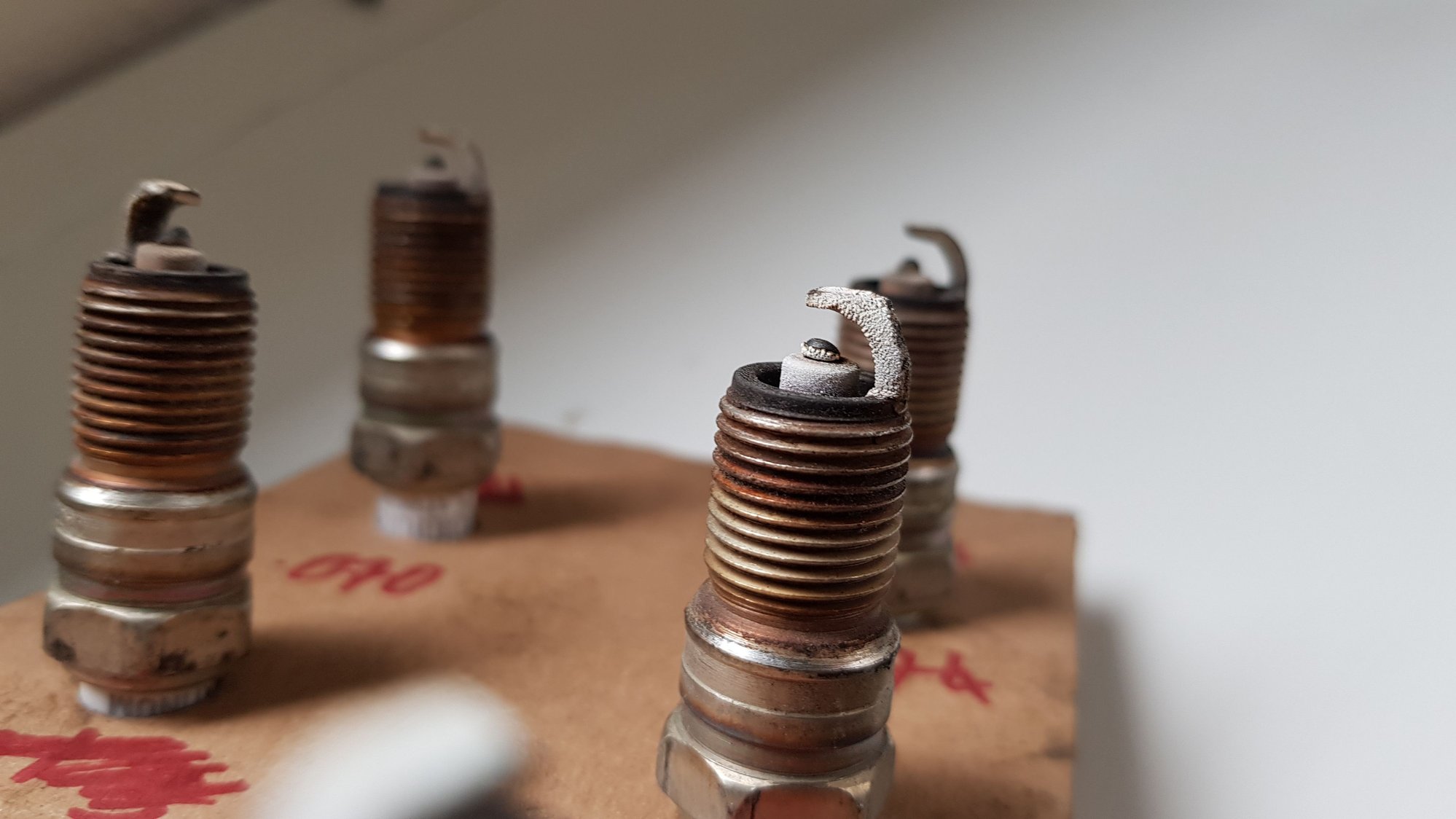

Okay. 10 new plugs and 10 new coils installed.
These suckers were in bad shape. Two had gaps over .80 and one was even .88! See below for the others.
God knows how long these were in service for, but I'm hoping with these finds that this is the source of my problem. The next week or so will tell, I guess.
The EX started up very smoothly (yet to drive). It still smells rich on startup, but again, I'm chalking this up to the 5-degree climate we currently have.
More soon.
For those that cannot read my handwriting (written in outside temps!) it goes:
.70
.74
.72
.84
.76
.70
.70
.75
.79
.88

Yep, those are done. That’s why I laugh when people brag how they’ve never done their plugs. When the gap gets too big, the coils have to work harder.
I do mine every 50k.

Those plugs look brutal. Hopefully mine aren't so bad when I finally get a medical release to where I can actually work on my X. Plan is to do plugs, boots and COPs after tax return arrives.
Hopefully not. I don't think they've ever been swapped in the truck's 156k life...
