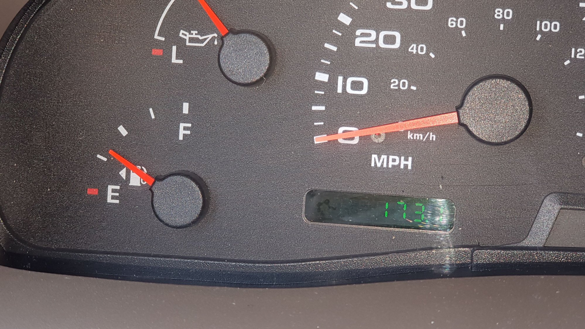

In other news, almost done with my current biased tank:
That's 173.1
Again, not judging this tank too harshly... even still, not the promising start I was hoping for...
