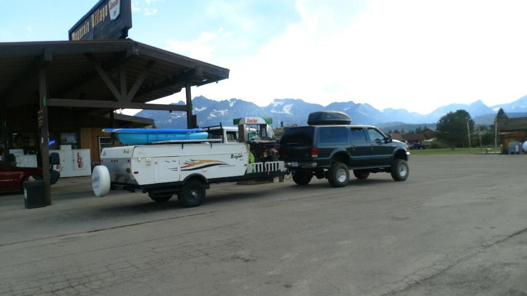

As someone from southern Minnesota, here are my specs and mileage as a comparison:
2000 6.8L V10 Limited, 220k miles
Large lift (5-7 inch? dunno)
5.13 gears front and rear
37" tires
New (reman) engine, injectors, COPs, spark plugs. (Had two plug blow outs and one totaled one of my heads, decided just to replace the whole engine and just about everything connected to it)
Banks Torque Tube headers (I had the engine out, so why not throw some nicer headers on?)
The overhead console indicates that I get about 8.3 to 8.5 MPG on average going to and from work (I typically only take it on bad weather days). My trip to work involves about a 20 mile trip, 12 of which is freeway (35). Accelerating up a freeway on-ramp twice a day, to only spend 12 mile diving on it, eats away at average MPG.
On a trip a few hours long (3-4) of mostly freeway, I've seen numbers around 9.5 MPG.
When towing my heavy 30ft camper fully loaded, my mileage plummets to about 6.6 MPG.
The mileage my overhead console reads is off however - I have been unable to successfully update the computer with my larger tire size, so my speedometer is off by 10ish MPH. The one time I hand calculated my mileage, I noted it was higher than the displayed value (but I don't remember what number that was). So the real MPG is slightly higher than the numbers I listed above. I do not notice a difference in MPG between summer driving and snow covered roads (maybe my deeper gears are the cause?)
The beast:
