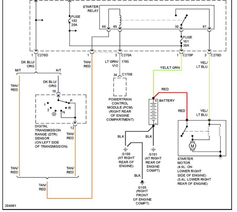

try your second key , on dwg the pcm must give a ground to get start relay on
Most of the time its the pcm not giving the ground to the start relay . . Because of pats problem or other blown fuses .

The one on top right is pcm power relay
You lucked out by accidently getting the failed one changed .Not very organized but hey it worked . The other two were not important .No pcm power =no signal to start relay .

201 was tow relay 202 was fog relay 203 was pcm power relay so you see he lucked out none of the others were critcal .
