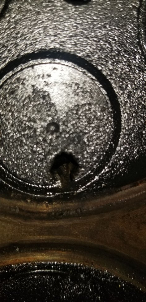

Still in it.
After a long hiatus I'm back at work on the powerstroke. Newest development, the picture I posted a while back of the glow plug was just the tip of the iceberg. The burn was consistent with the burn through the piston in that cylinder and intake valve. A plus is that the cylinder wall is perfect upon visual inspection. A negative I guess when the injector stuck in blow torch mode, it didn't stop at the intake valve. It got into the head just a little bit. Do any of you think this would cause problems? I feel the answer is obvious but, I just wanted to make sure.
