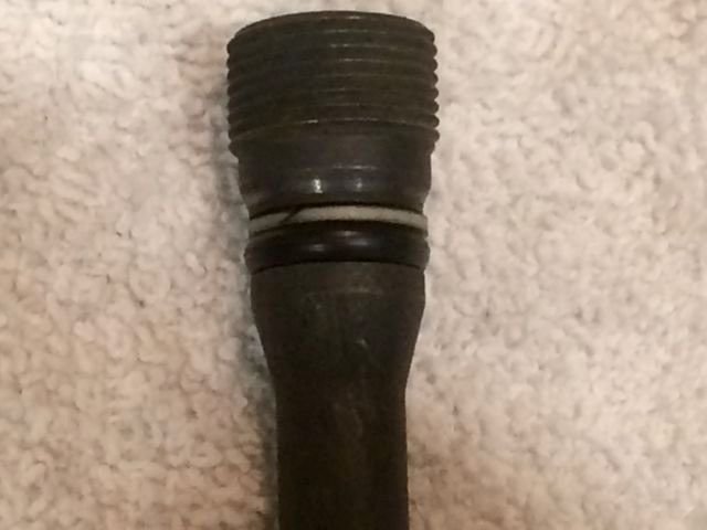

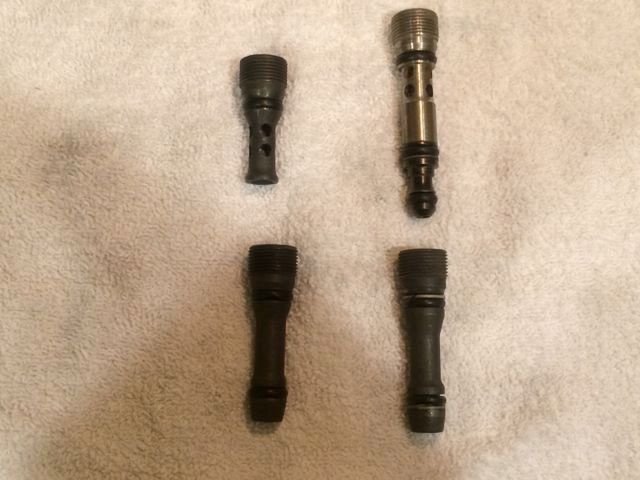

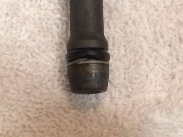

That one stand pipe top in the first photo top left is a really OLD style and if you find that one it may be a good idea to replace it with a
new one I think. Mark would know the best in that case.
Parts on the top of the stand pipe This is why it takes so long for an air test to blow the oil out of the rails.
I have not tried doing this so keep that in mind. It really depends on if the lower part of the top section is not hardened steel.
Ok here is how you can make this into a tool for blocking off one side. You unscrew a used stand pipe top take the lower section of the
top of the stand pipe and unscrew it and drill it to the correct size so that you can plug it with a grub screw that you have put some paste
thread sealant on (DO NOT USE TAPE) Rector Seal #2 would be good or any other that has PTFE in it. PTFE for people that don't
know is Teflon. The reason to not sue tape is if a fragment gets into the system it can kill an injector. Small clearances and tape don't
play well together at all. So stay safe and no tape in the fuel system. This may only be engine oil but it leads to the spool valves and
the intensifier piston. The clearances there are very tight. So tight that varnish from the oil can cause stiction.
Home brew stuck stand pipe pulling tool. The OTC one is crazy money.
The cap bolt is 1/4 #20 and the two aluminum things are just spacers that fit close over the bolt to press on the rubber hose to expand it so that it grips the inside wall of the long part of the stand pipe that got left behind.
