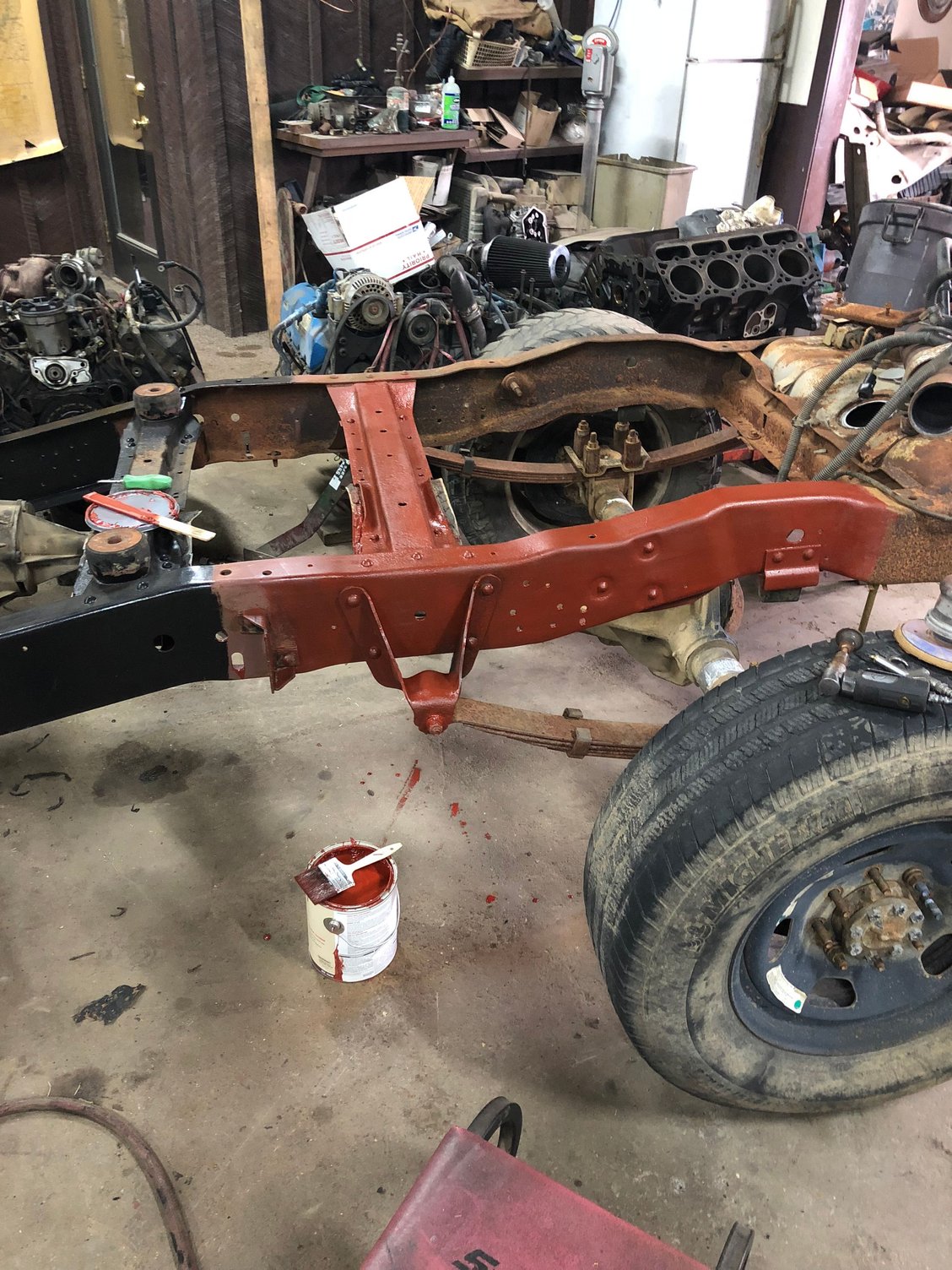

Is that a 1/2 ton frame? I don't recognize the frame horns
Old Oct 24, 2018 | 04:55 PM
7.3 forever's Avatar
7.3 forever
Joined: Aug 2014
Posts: 1,821
Likes: 238
From: piedmont mo
Yes f150 frame it’s definitely thinner than a 250 frame and horns have crumple zone atleast that’s what I call it. lol

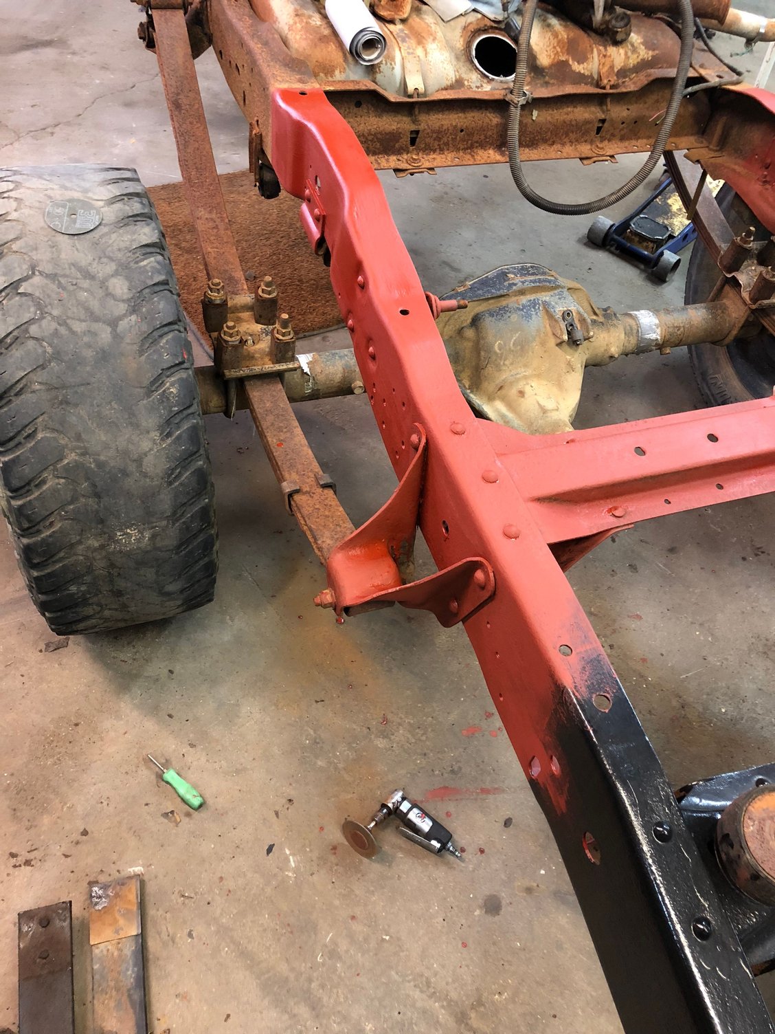

Well it’s not much but I got some more of the frame rust primered have inside of it done to. Gonna try to get other side back that far to today that way I can paint it tomorrow. Hopefully I can get it painted.
Old Oct 25, 2018 | 02:19 PM
7.3 forever
Joined: Aug 2014
Posts: 1,821
Likes: 238
From: piedmont mo
And got the other side primered and trans lines in.
