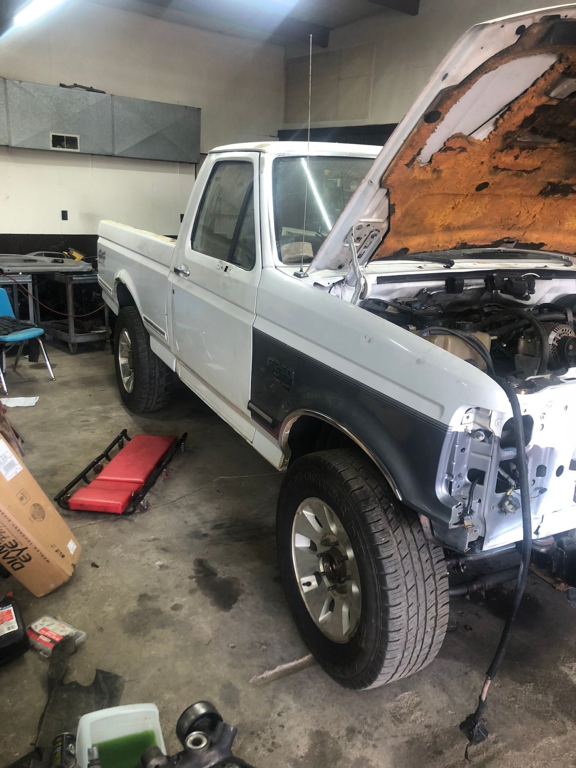

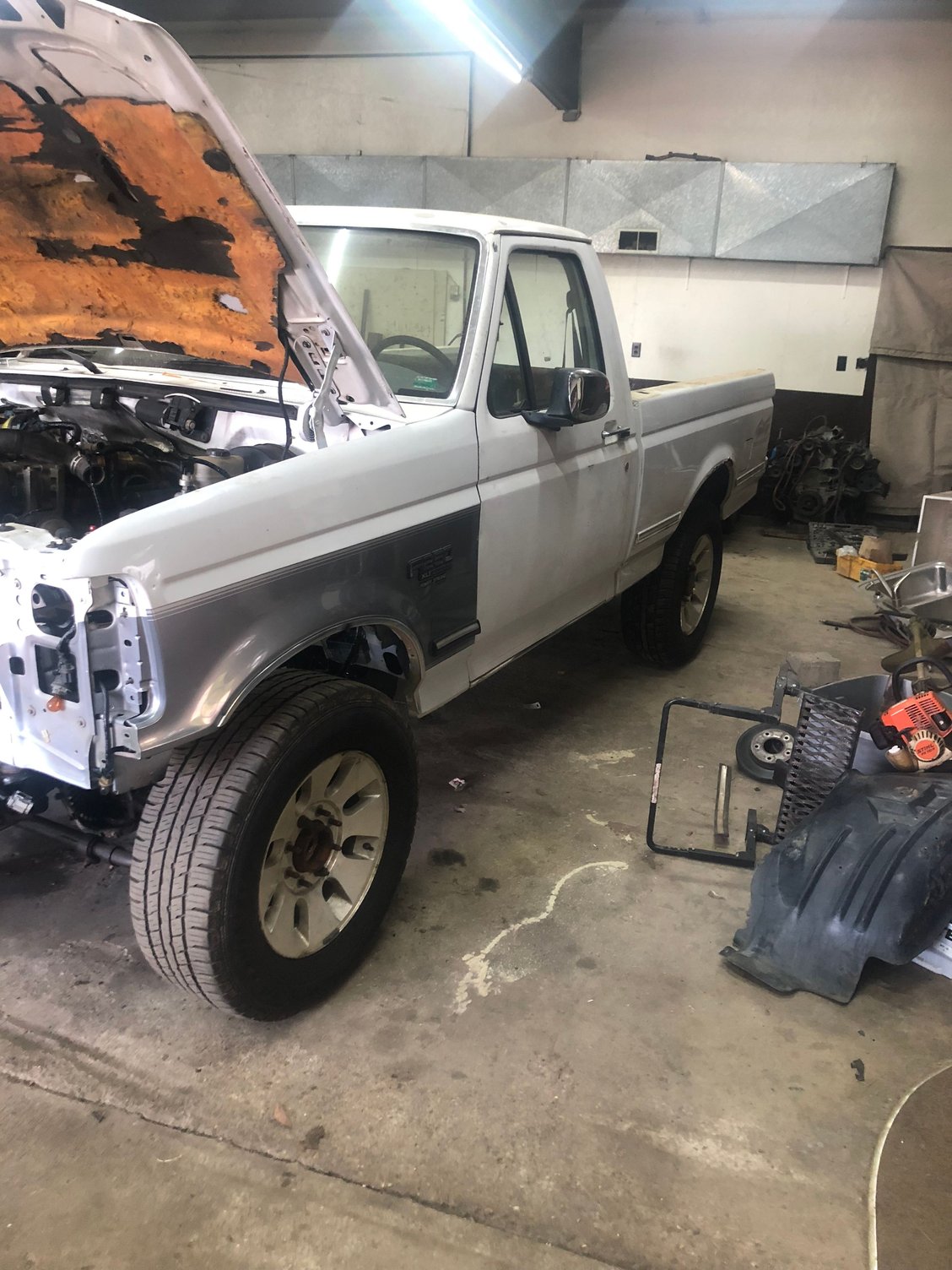

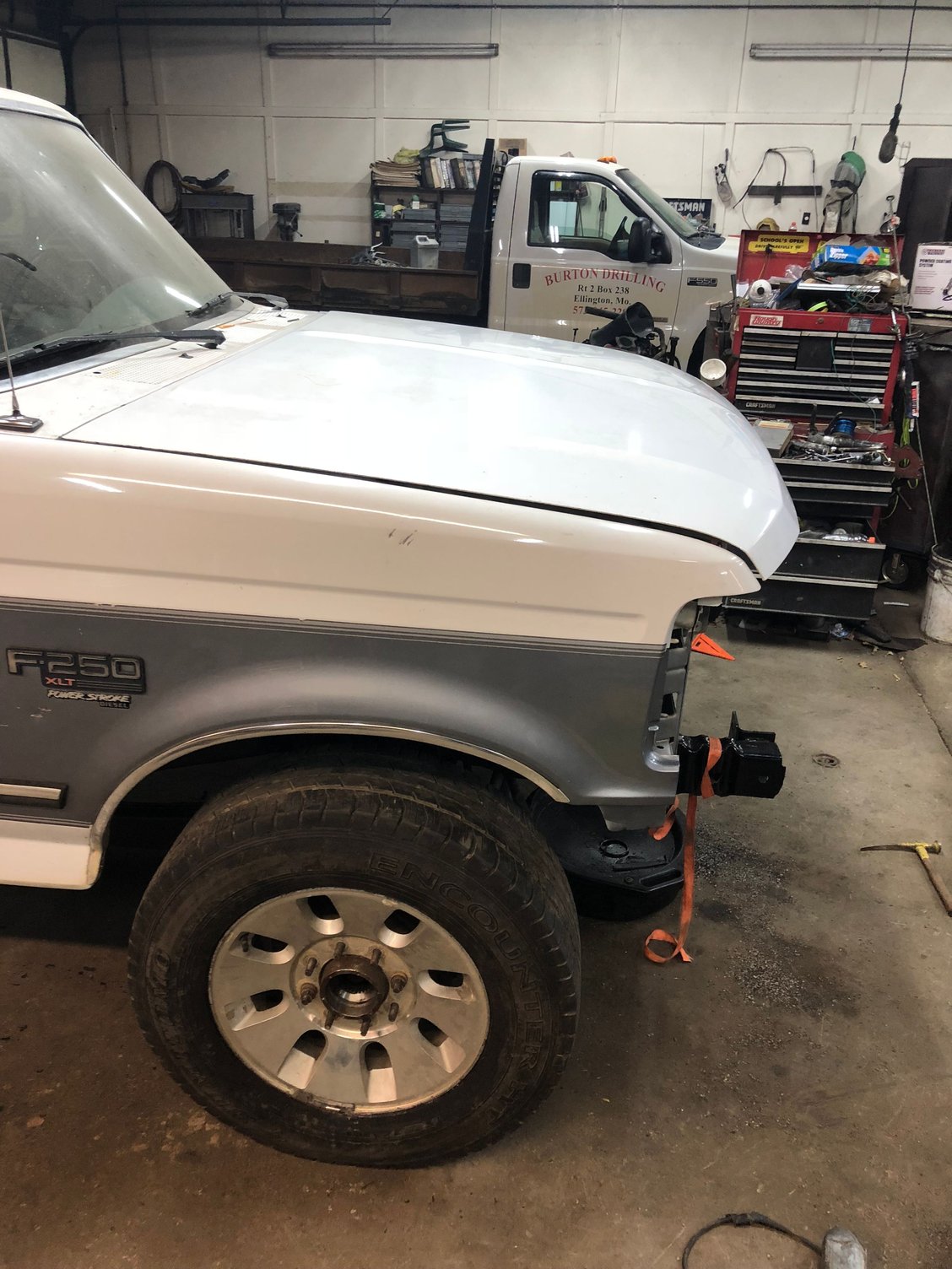

Nice job on this build. It has come together very quickly!

I like that two tone combo, looks more finished and upscale

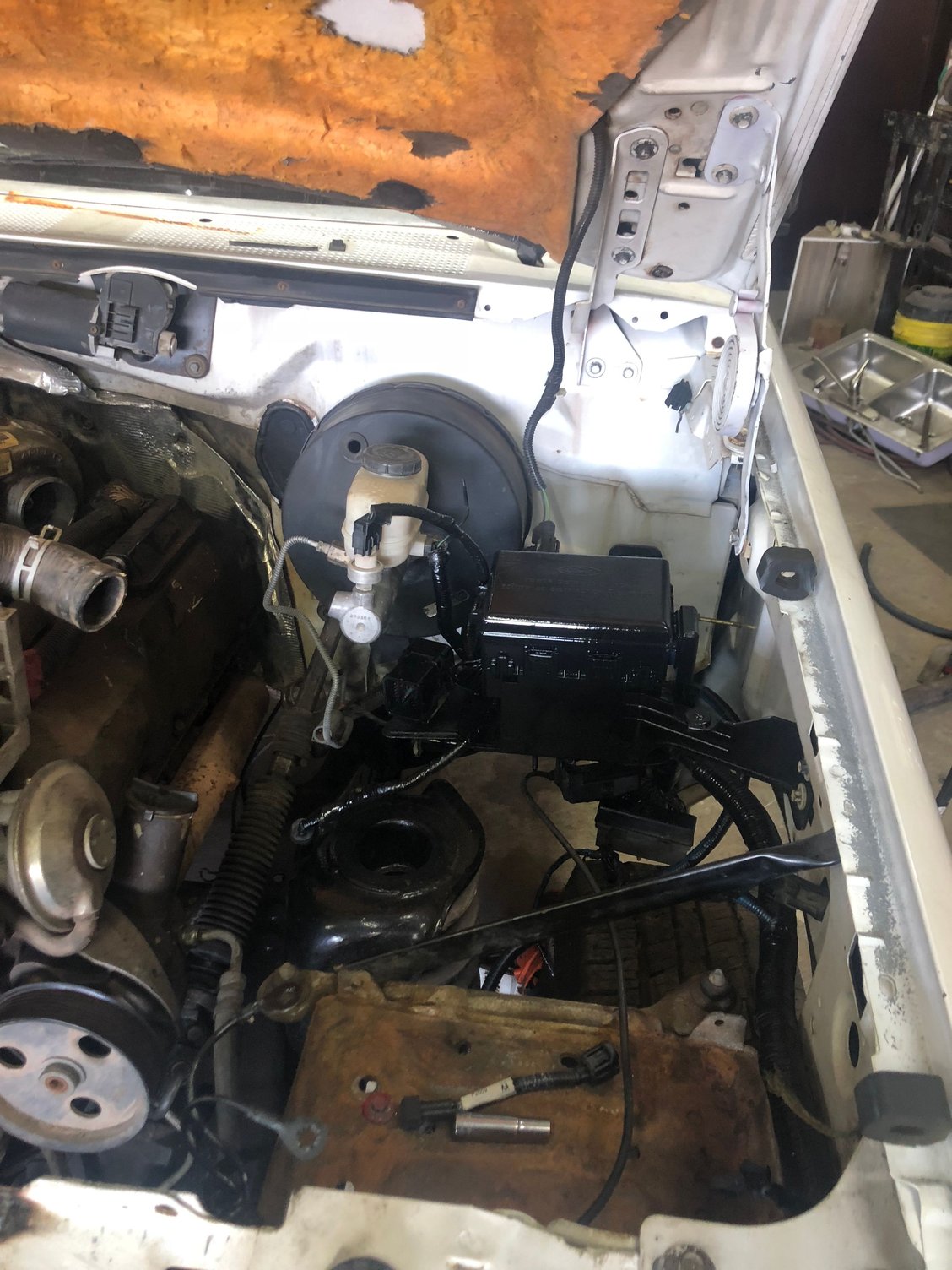

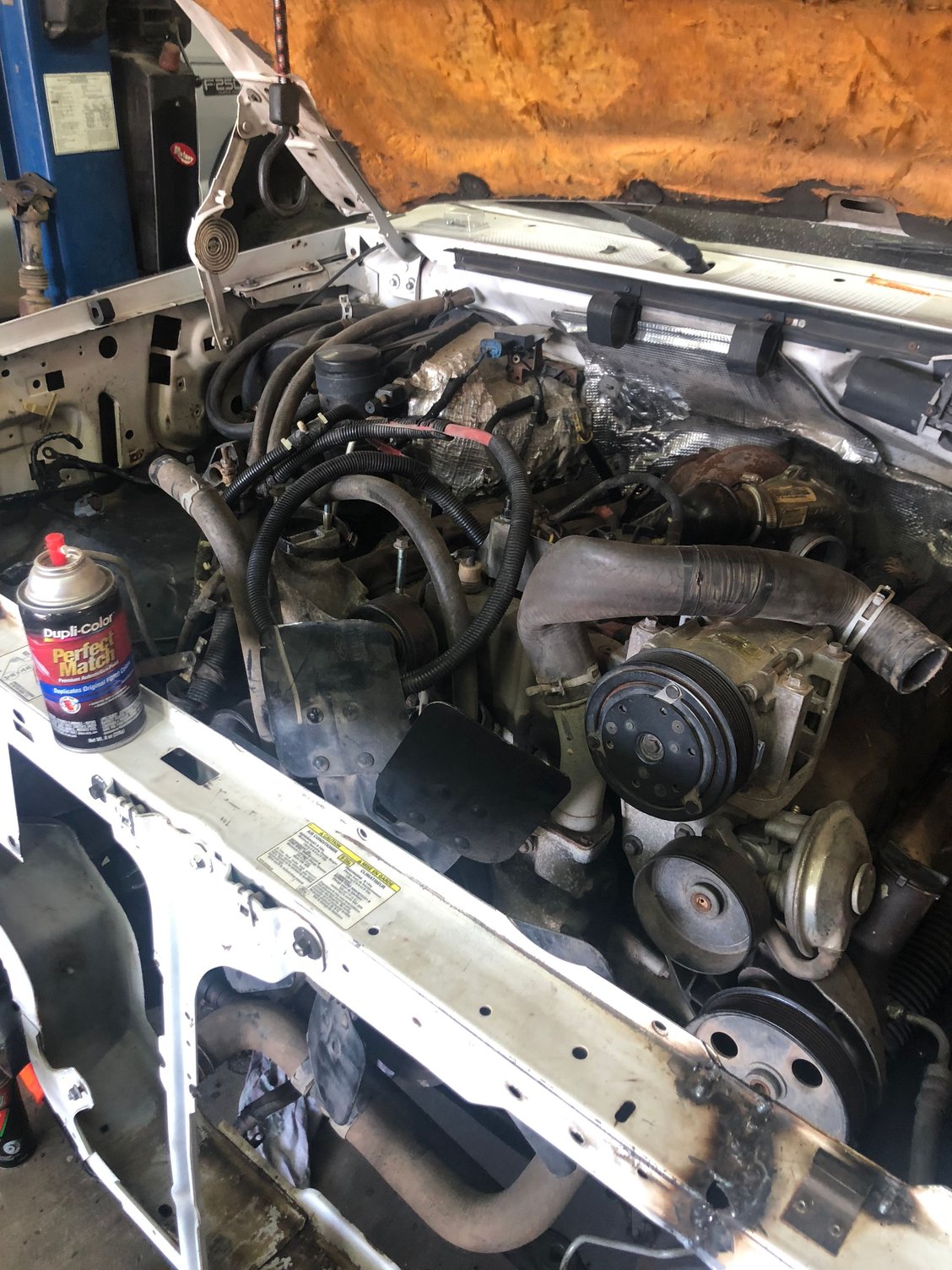

Thanks guys gonna pull them back off tomorrow wash them inside and out and reinstall. Then I half to repair the top of the core support is cracked but should be easily repairable. Also need to quickly lift cab back up and do little extra clearance for downpipe. Truck is really coming together definitely ready to atleast here it run and move around shop yard.

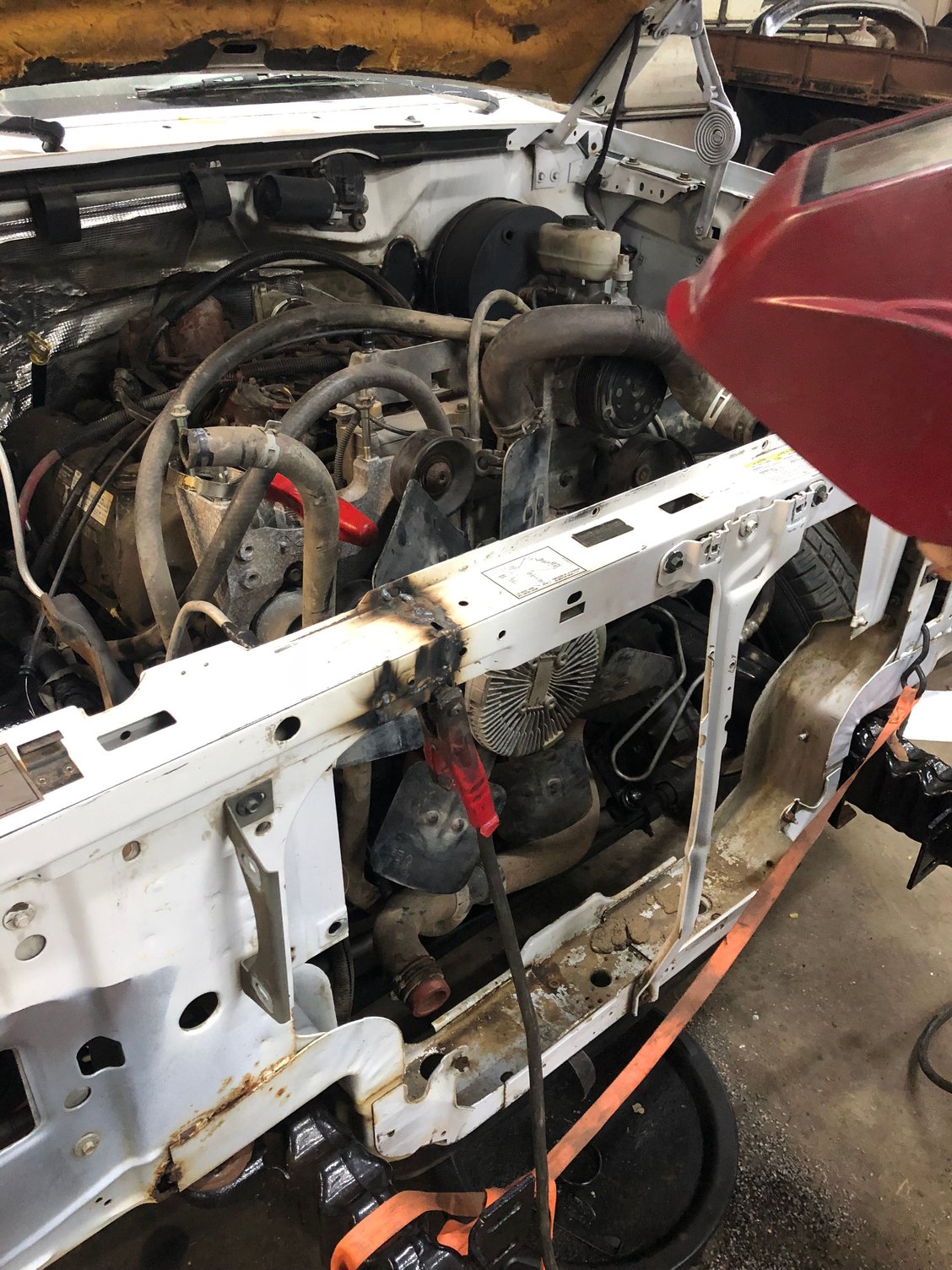

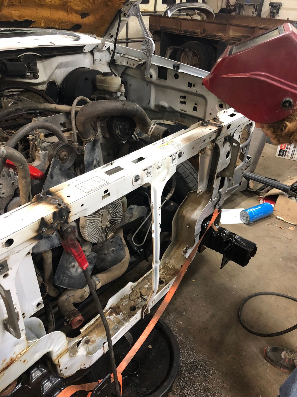

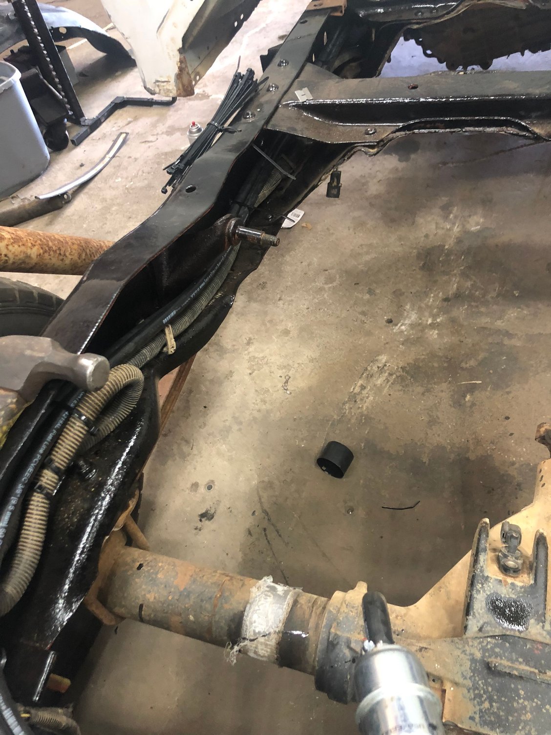

Well got inside of fenders washed up and reinstalled and core support it’s washed up and installed to. Welded up the cracks on top of support this evening going to grind them and make patches this weekend and weld over it to reinforce the support. Really starting to look like a truck

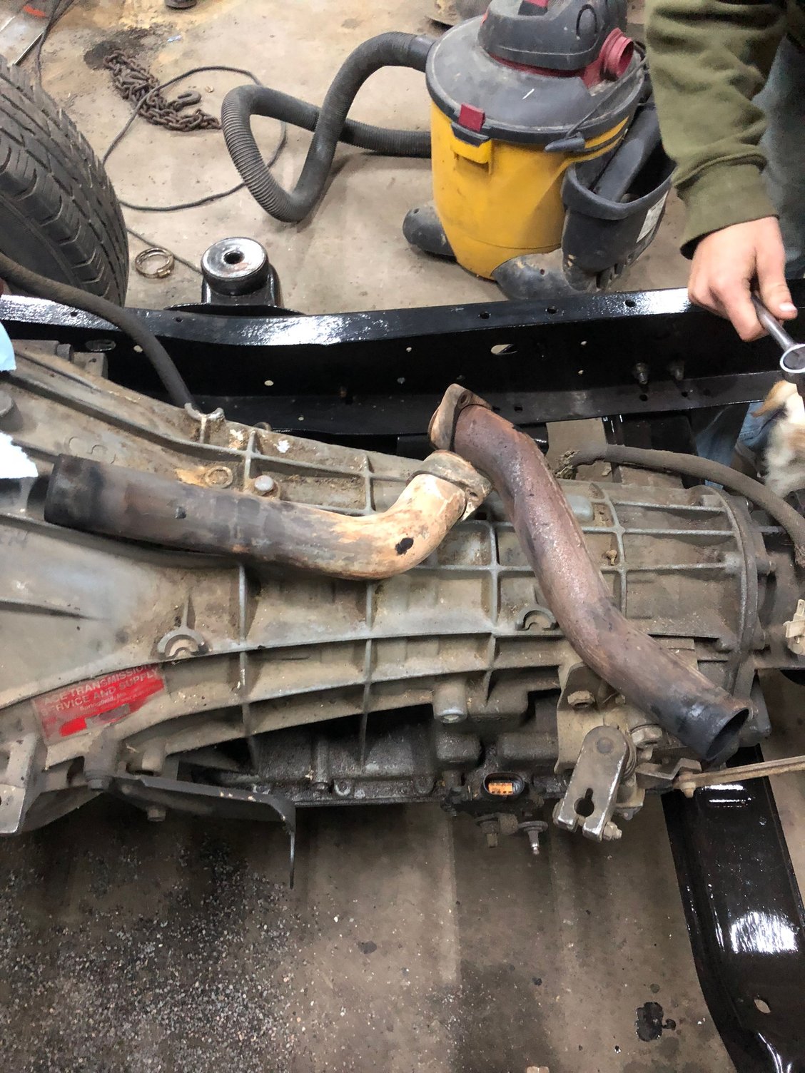

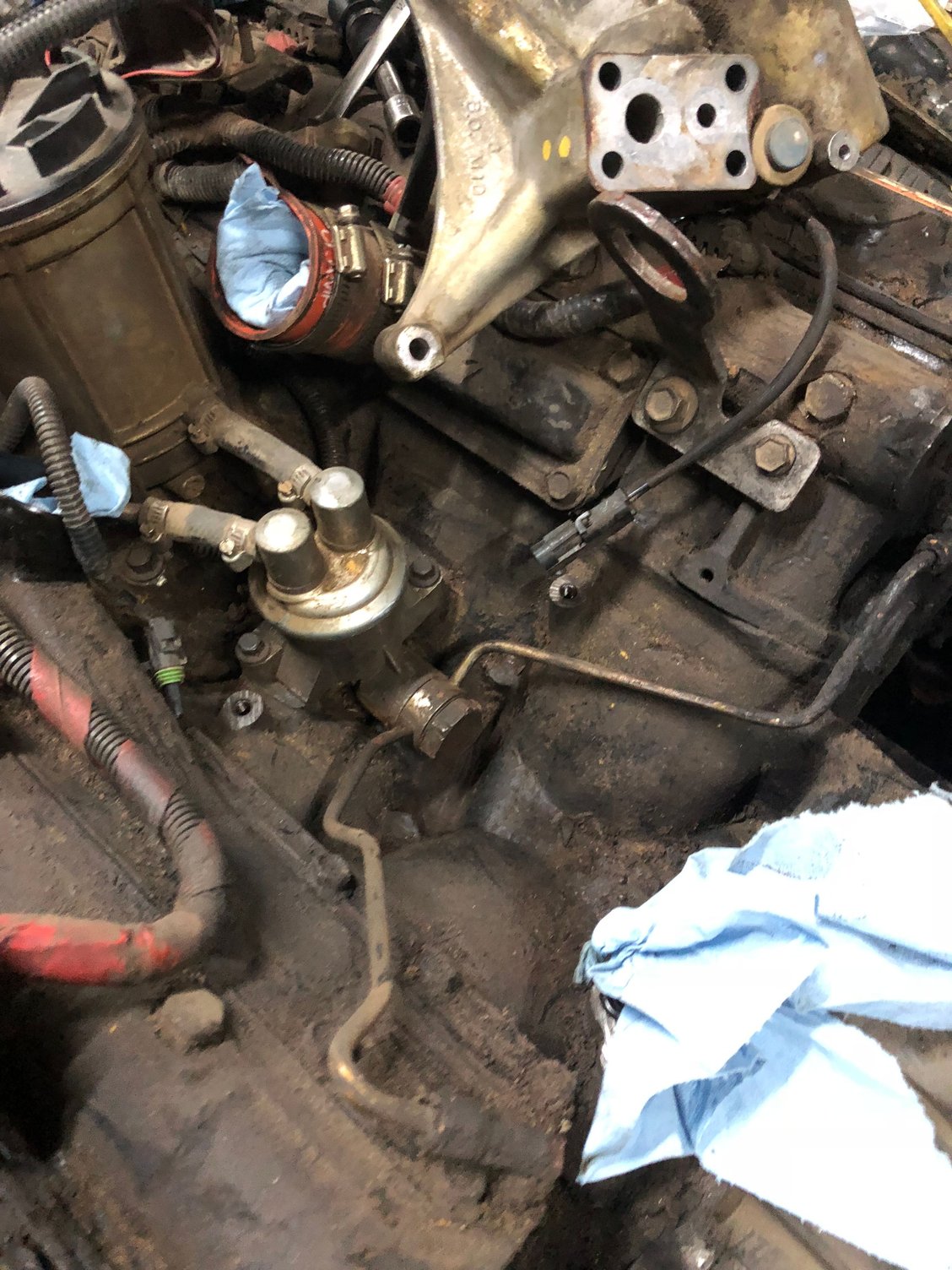

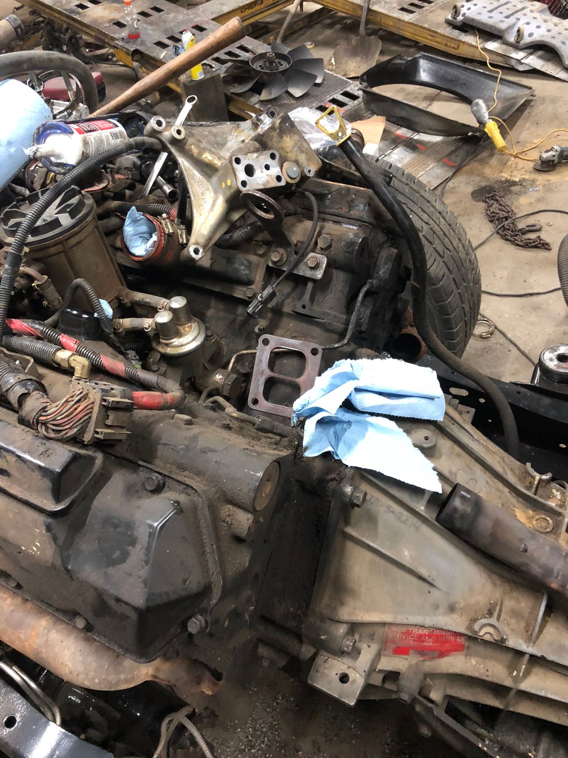

Well just lifted cab up with lift and pulled turbo deleted ebpv and just gotta weld up outlet flap rod hole. And reinstall everything and go from there.

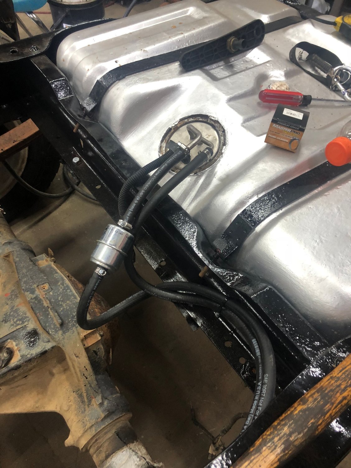

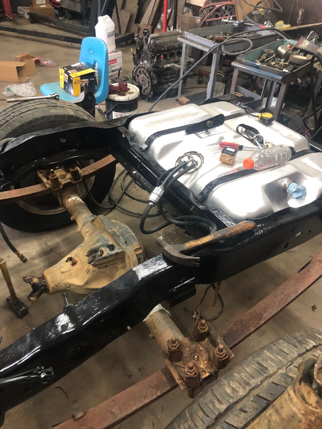

Sorry I know it’s been a while but work picked up and truck got put on back burner but now it’s slowed a little so back at it we go. Also decided to stay with stock fuel at moment just bypassed selector switch and used some diesel rated line.

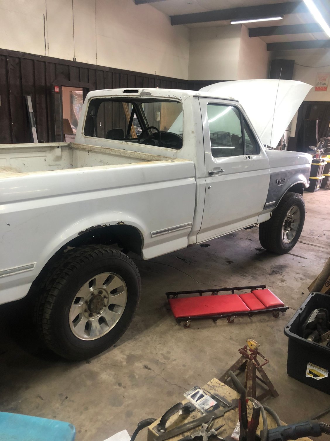

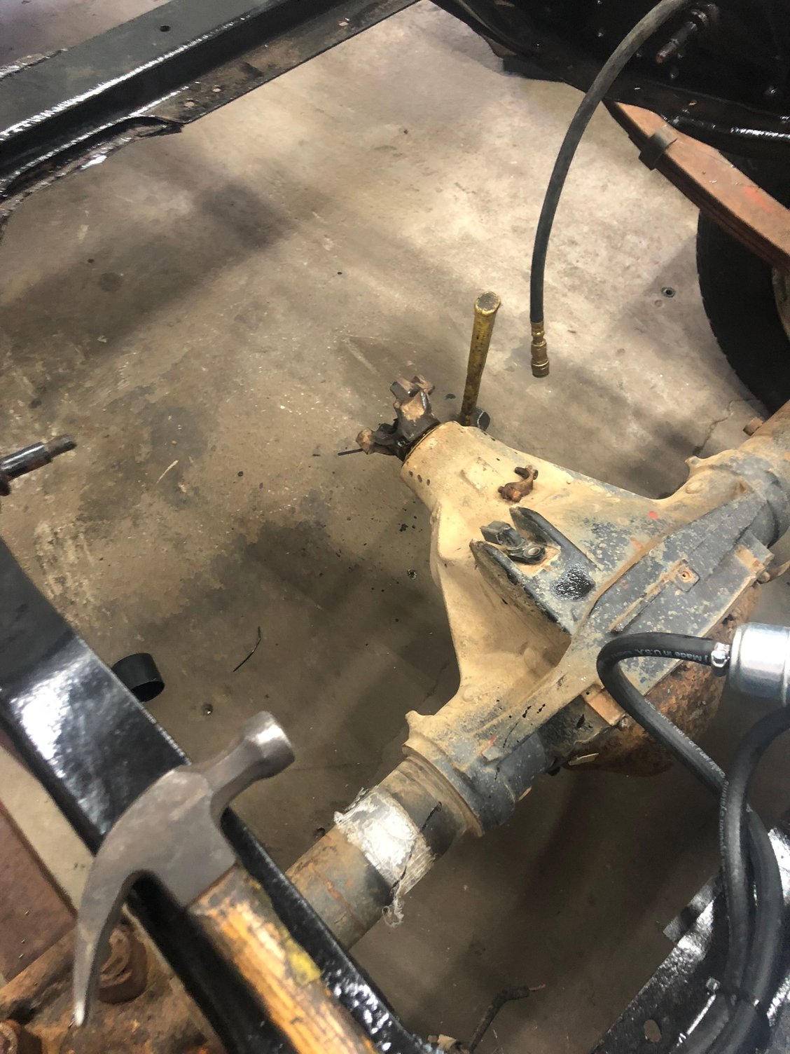

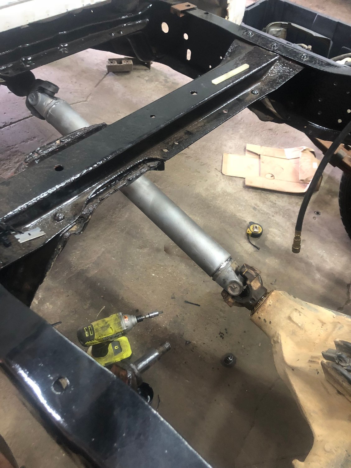

Well got bed set on today and drive shaft welded up and passenger battery tray in today.

The bed I put on it is very clean inside and out but does have very minimal rust on both fender wells.
