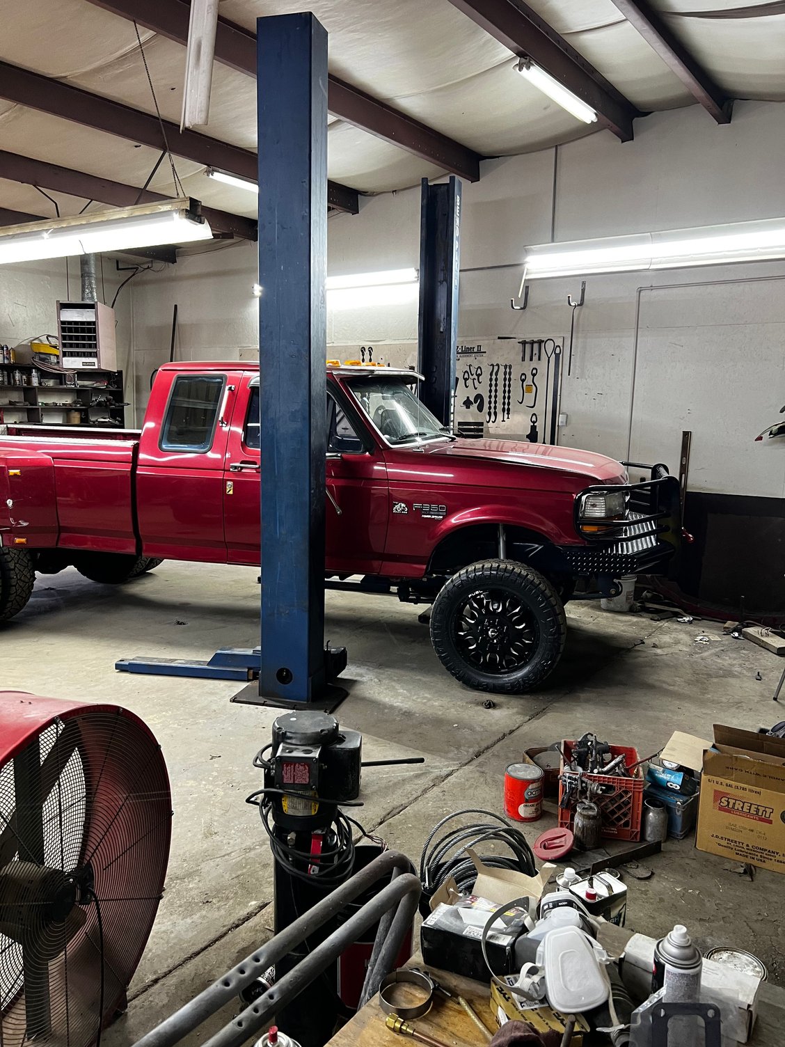

Well ended up pulling 2wd trans before tearing the truck all apart because customers wants to make sure all is well. Before we tare truck apart completely for all the work. Plan on haven a set of 1410 rear driveshafts built and a 1350 sd style front drive shaft built. We got a flanged yoke for the rebuilt 1356 we are installing in it.

Customer ended up changing a bunch of stuff on the build. The trans where installing is a sun coast diesel full competition trans I believe that’s what it’s called anyway. And it’s now getting a s369sxe and 250/100 and all the supporting mods.

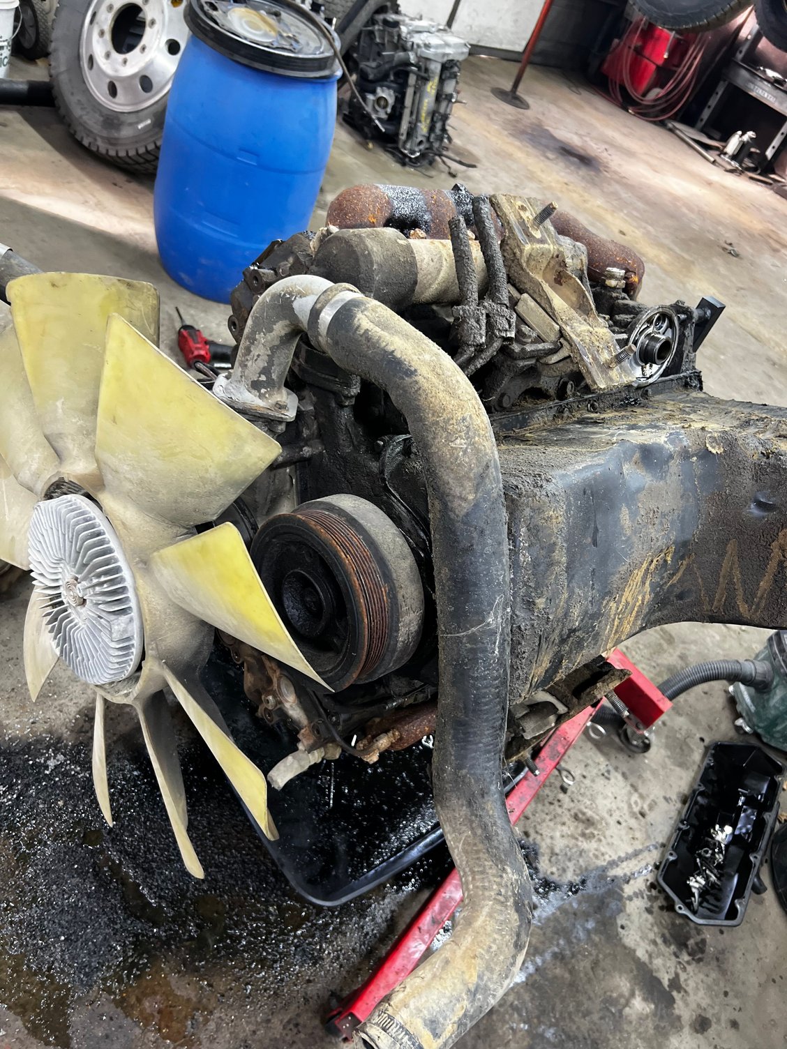

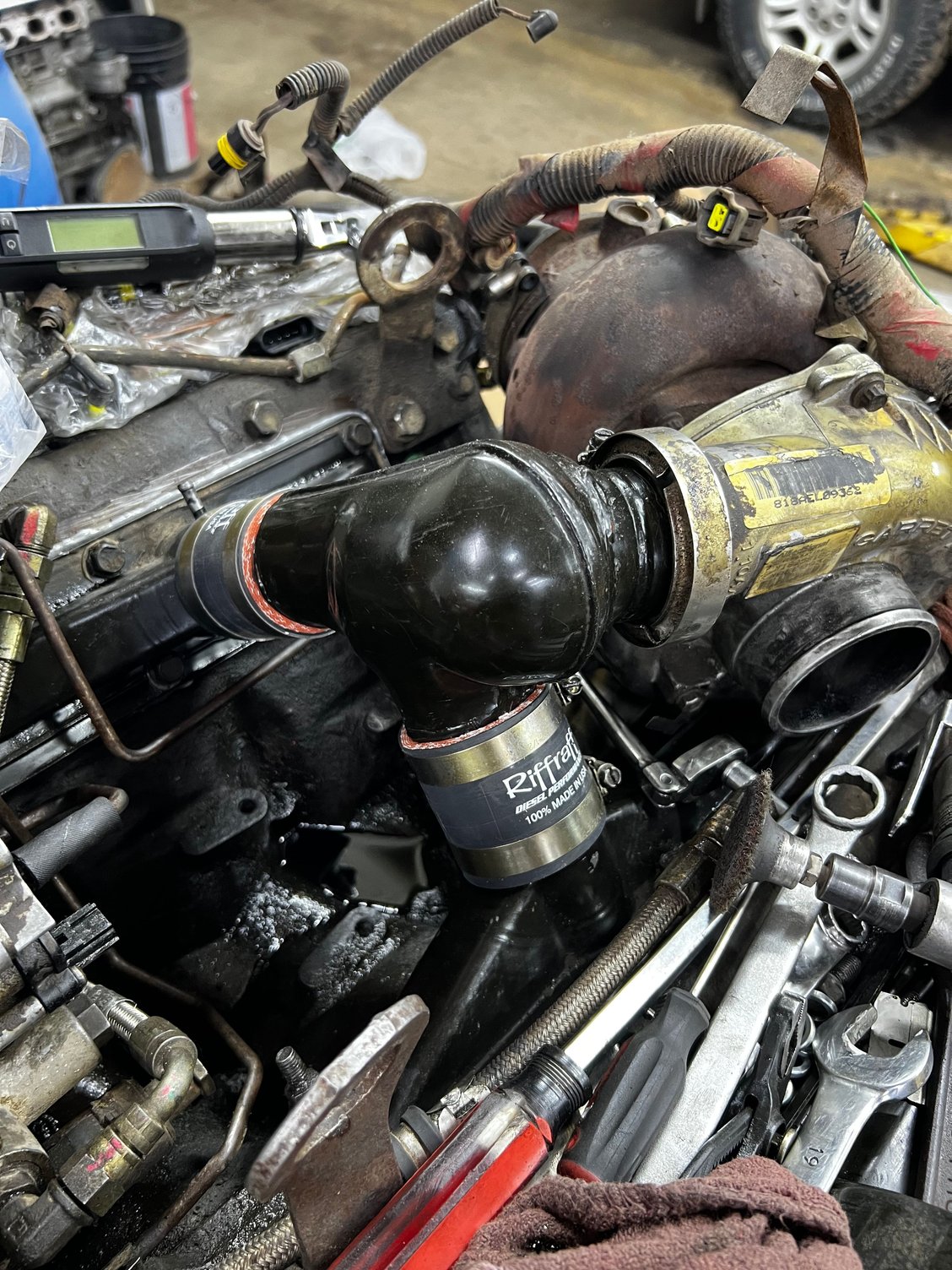

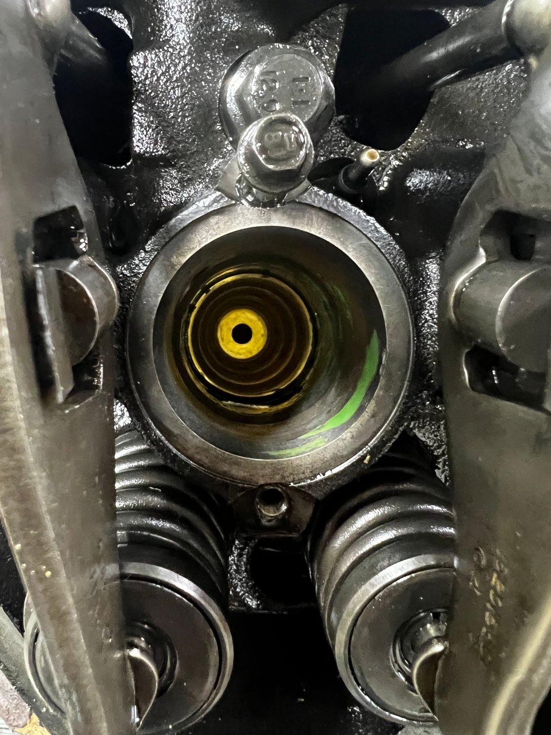

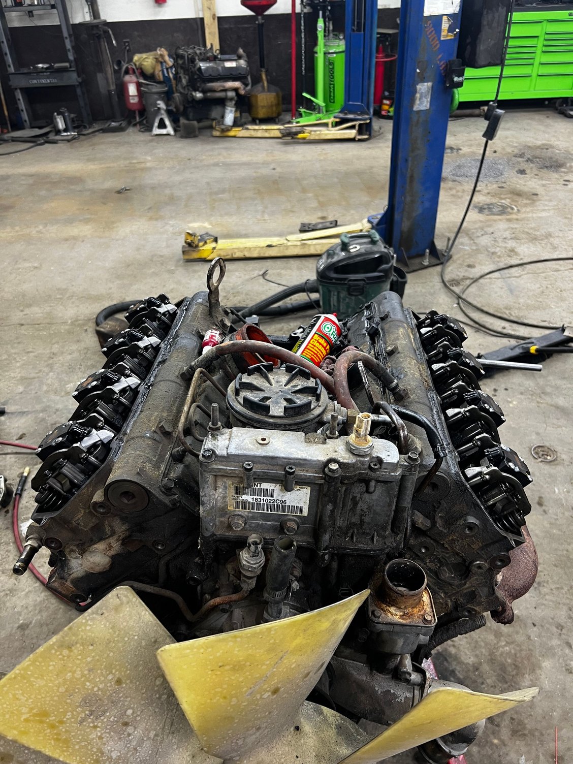

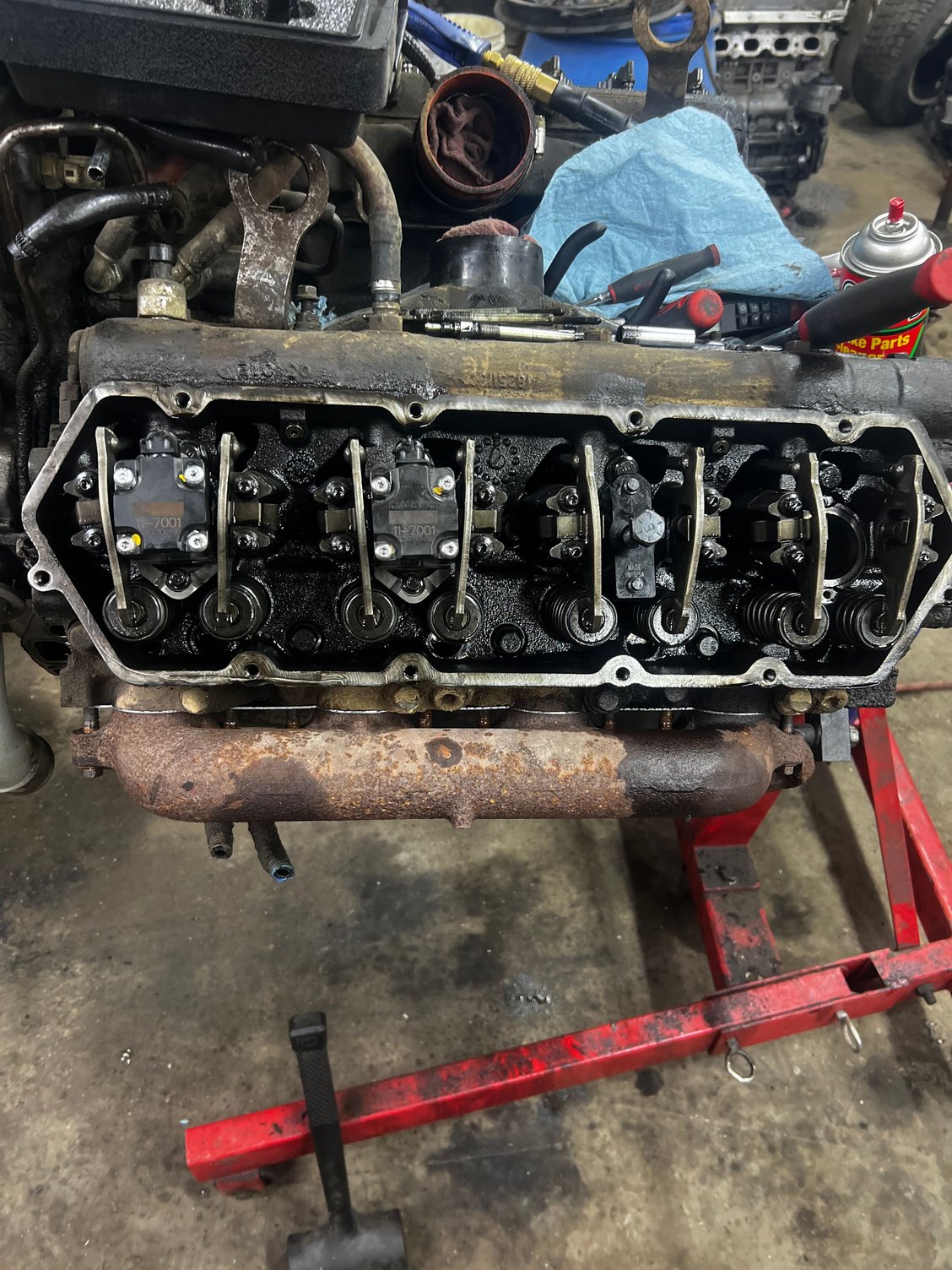

Well in the process of resealing a engine for a 97 super cab 4x4 truck where gonna put up forsale soon.
it’s getting injector cups oil pan and dipstick adapter resealed and rear main and rear engine plate as well. Also the the hpop and fuel bowl this engine is from a 2000 f350 going to switch to the obs plenums and turbo but stick with the Sd fuel system and Mount factory Sd pump on the frame rail. Also got new manifold bolts and gaskets and new full force diesel up pipes for it. Figured good time to post few pics of current work going on.

Well ended up having to wait on the riffraff hpop thread inserts definitely a good product from riffraff. I’m utilizing the factory Sd timing cover and fuel system.

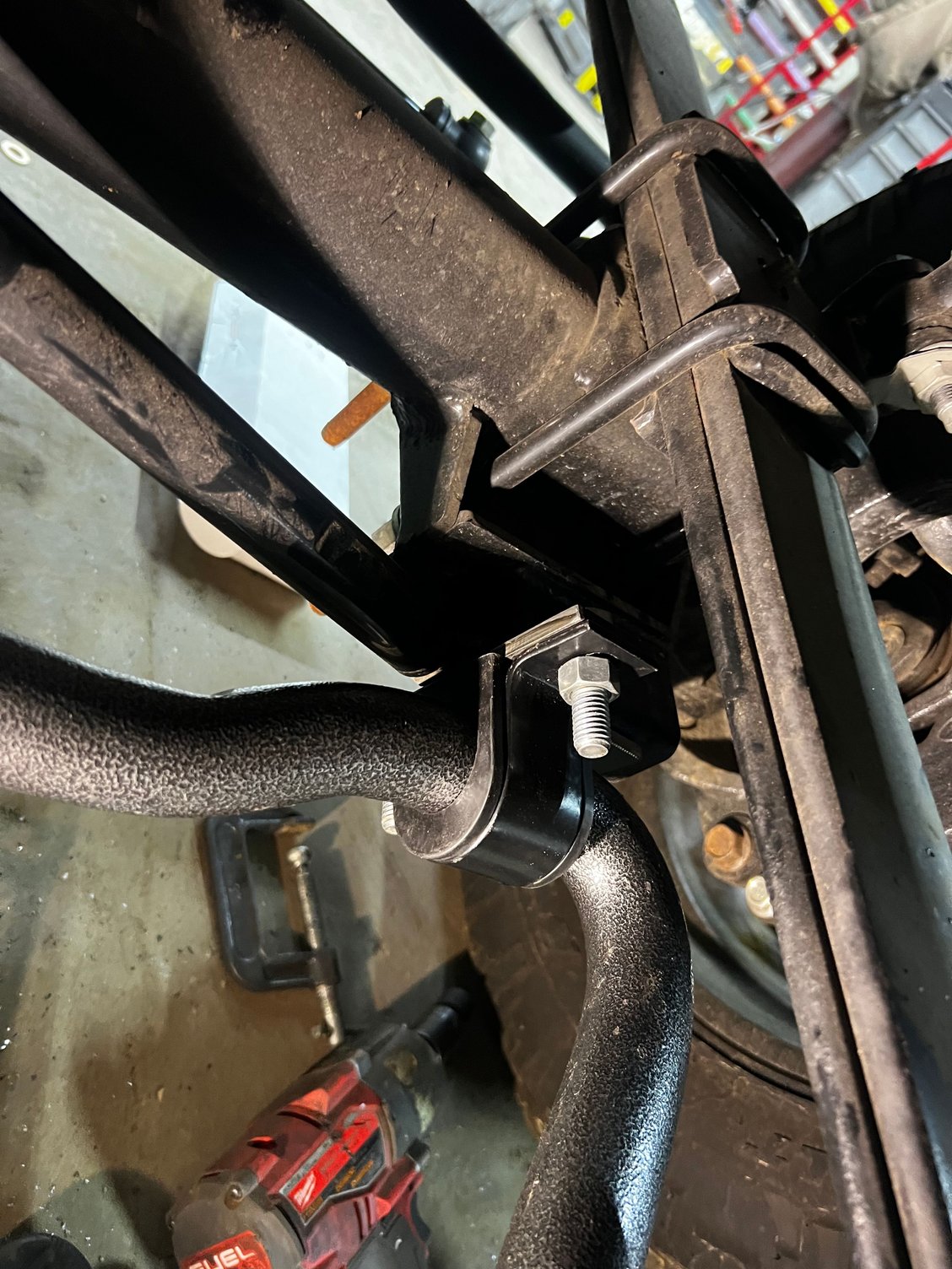

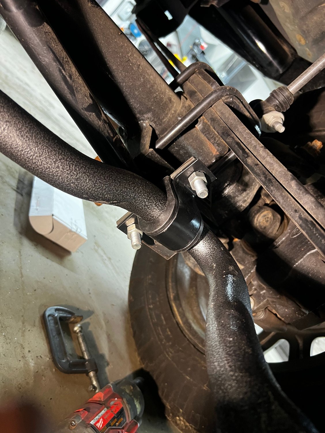

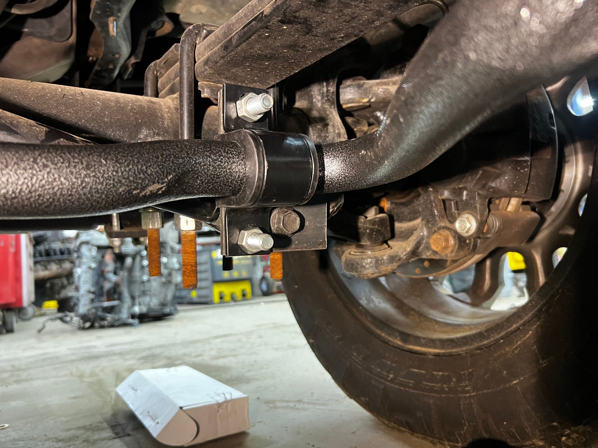

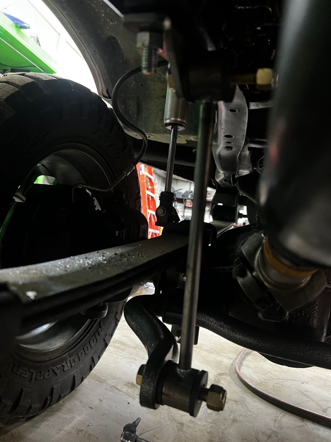

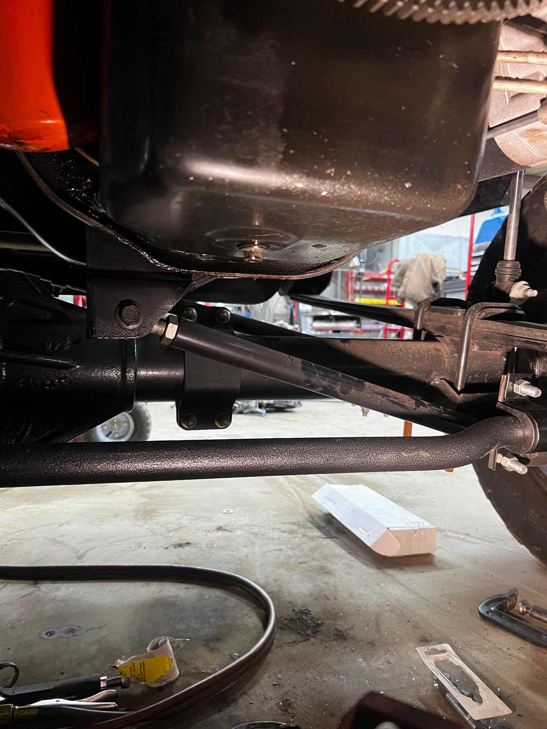

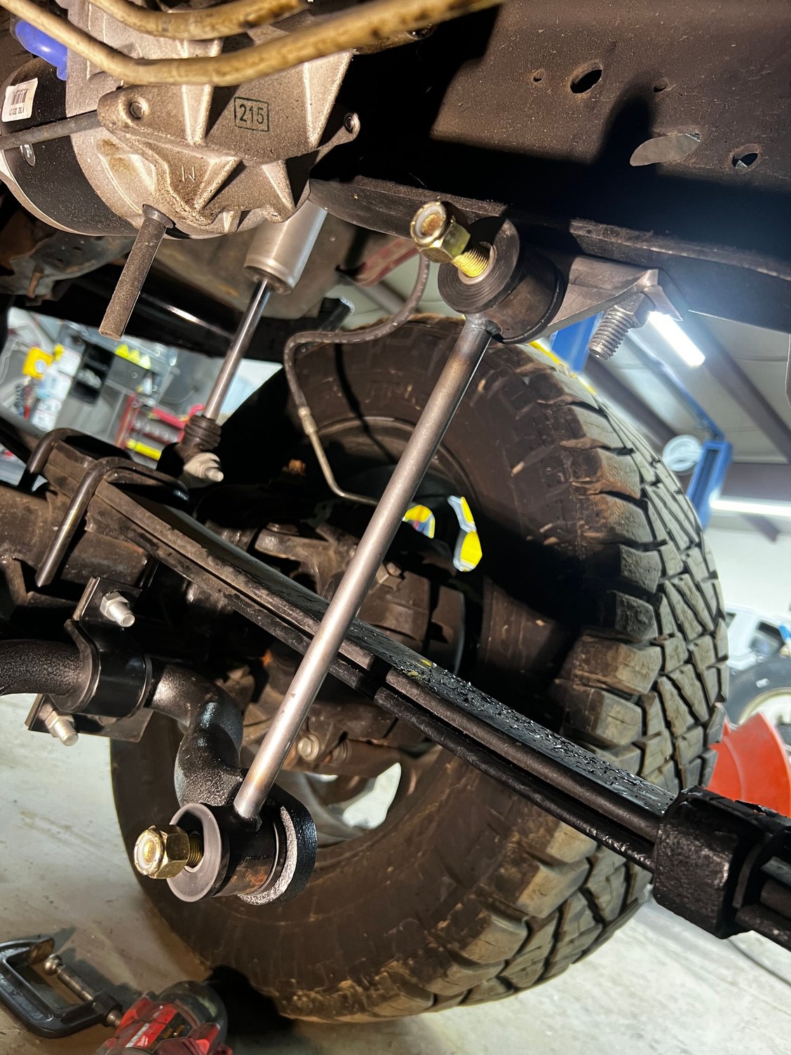

Thanks and only major modifications I see I’m going to half to do is re wire/loom the engine harness to work around the Sd fuel bowl but shouldn’t be to bad.
ON another note I’ve been working on our customers 2wd to 4x4 build we’ve been building past year or so.
I figured out a sway bar solution since we are using the Sd axle with the sky off-road obs passenger replacement bracket. We purchased there Sd sway bar end links kit for a obs. Then I made a spacer out of 1/4 in for the Sd driver side Mount and took another peace of 1/4in on passenger side and matched it and attached to sky’s bracket and worked perfectly.

Where also using a hellwig sway bar

Everything is lose due to fact that where still mocking everything up before the truck comes apart for a complete frame off restro.
