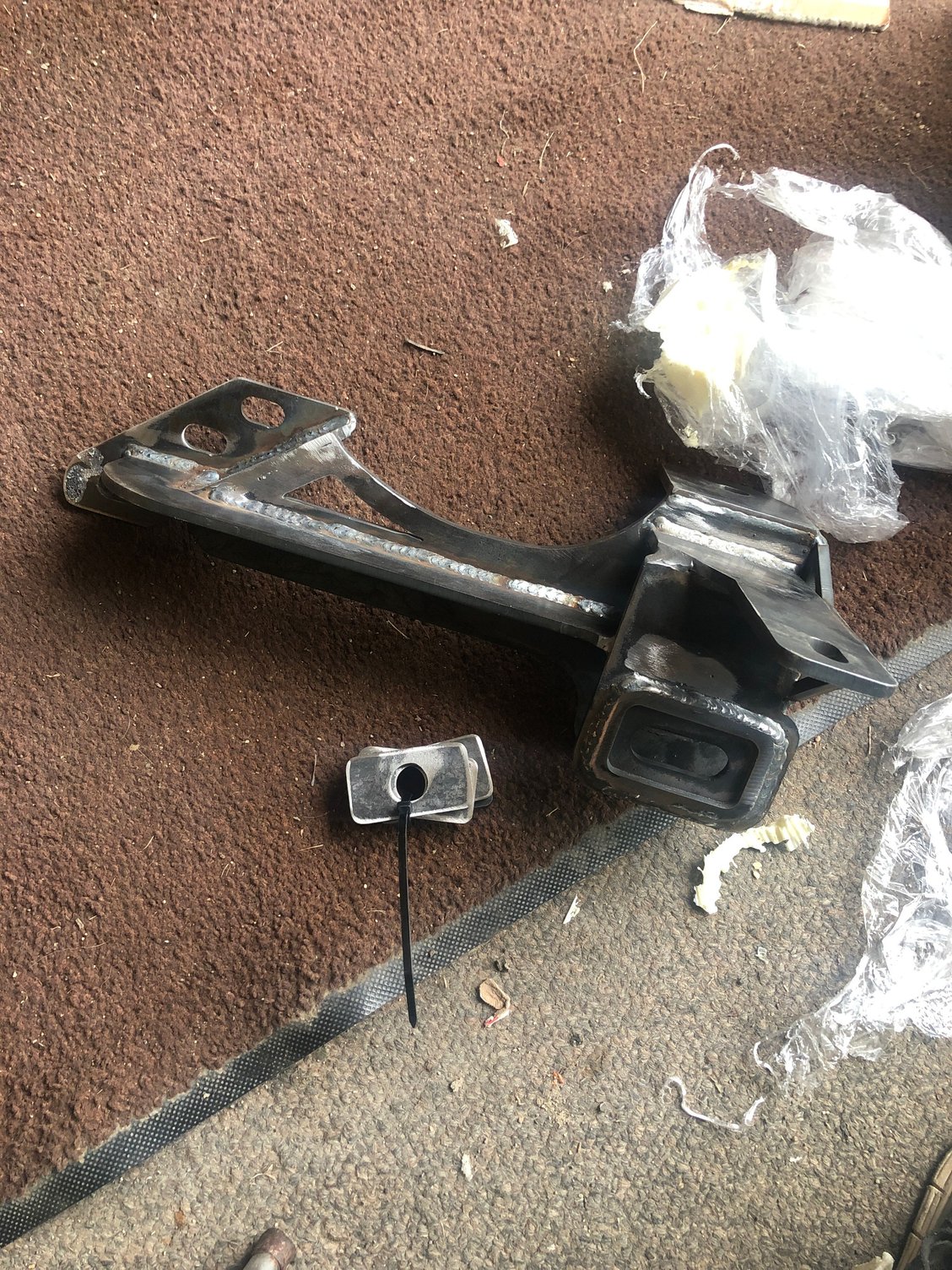

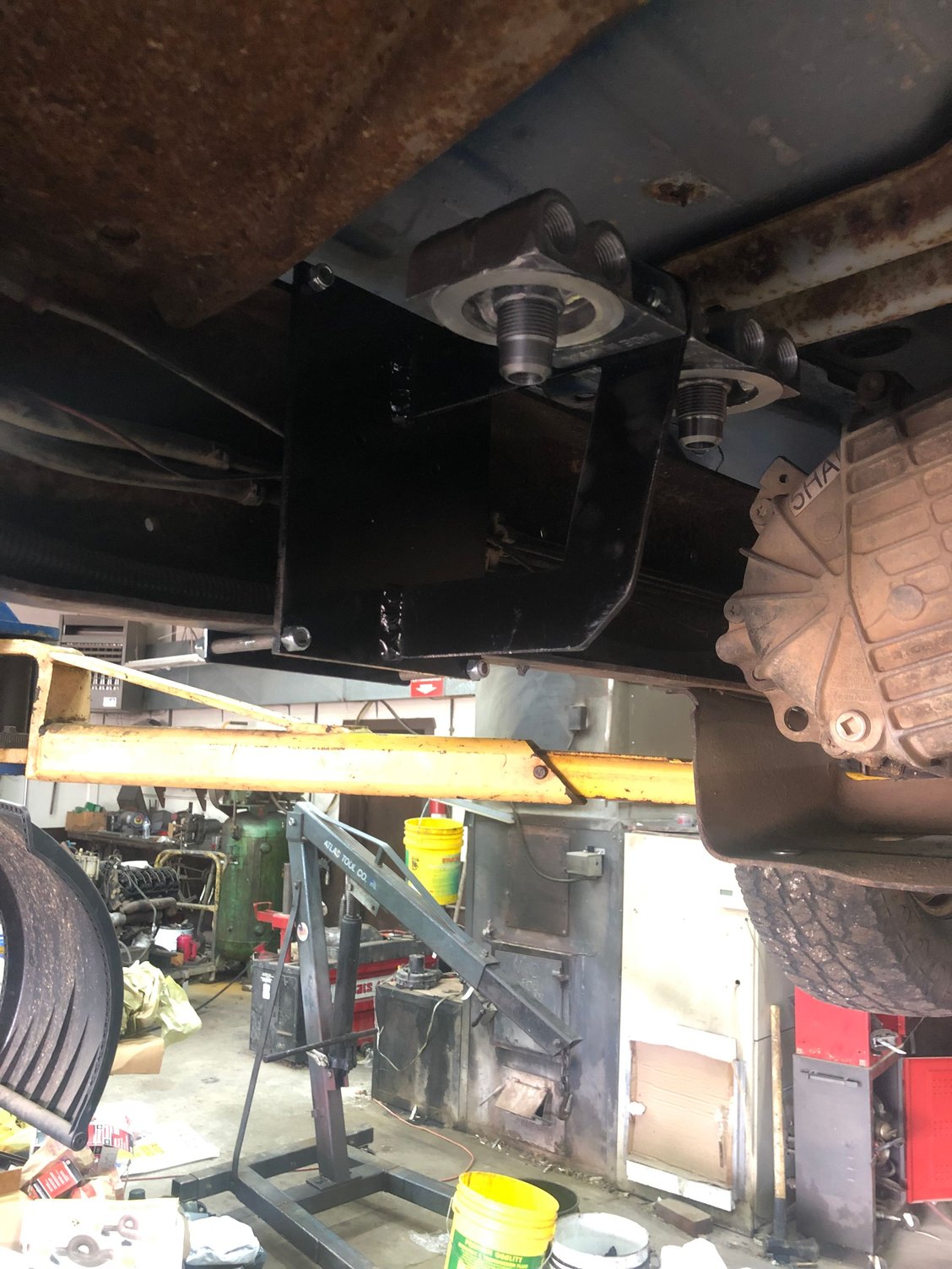

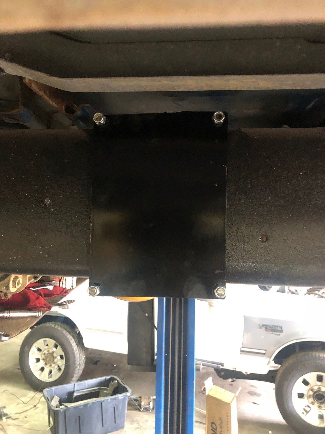

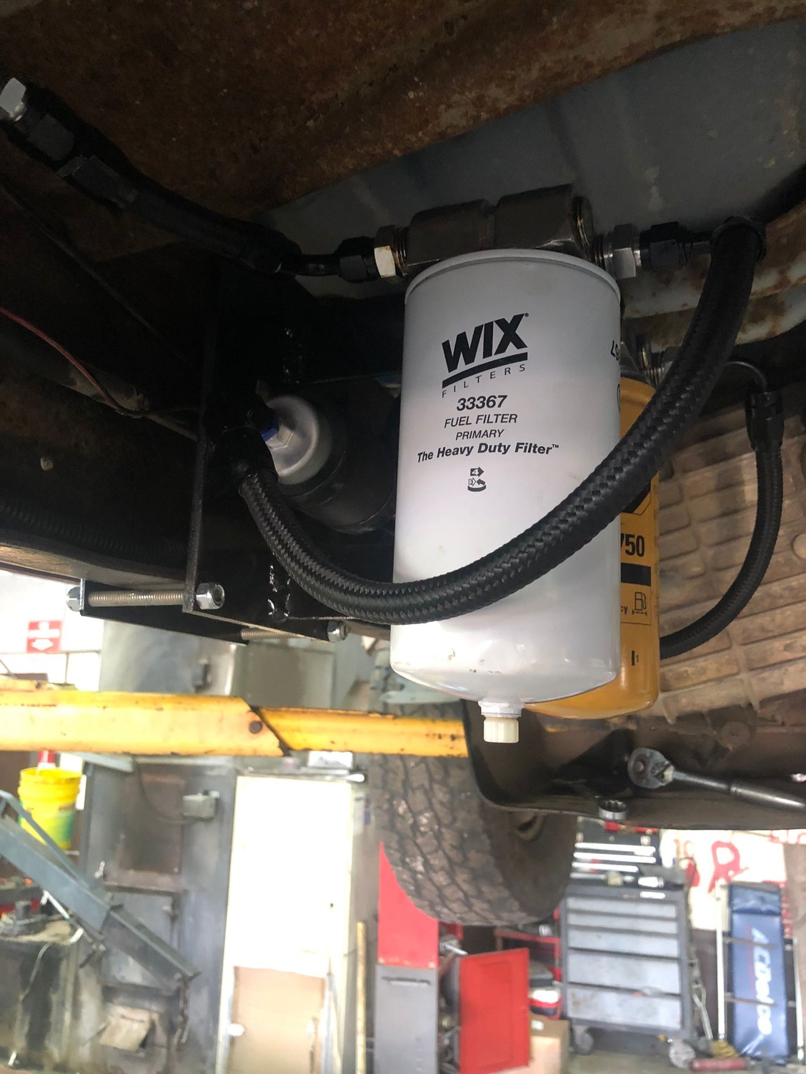

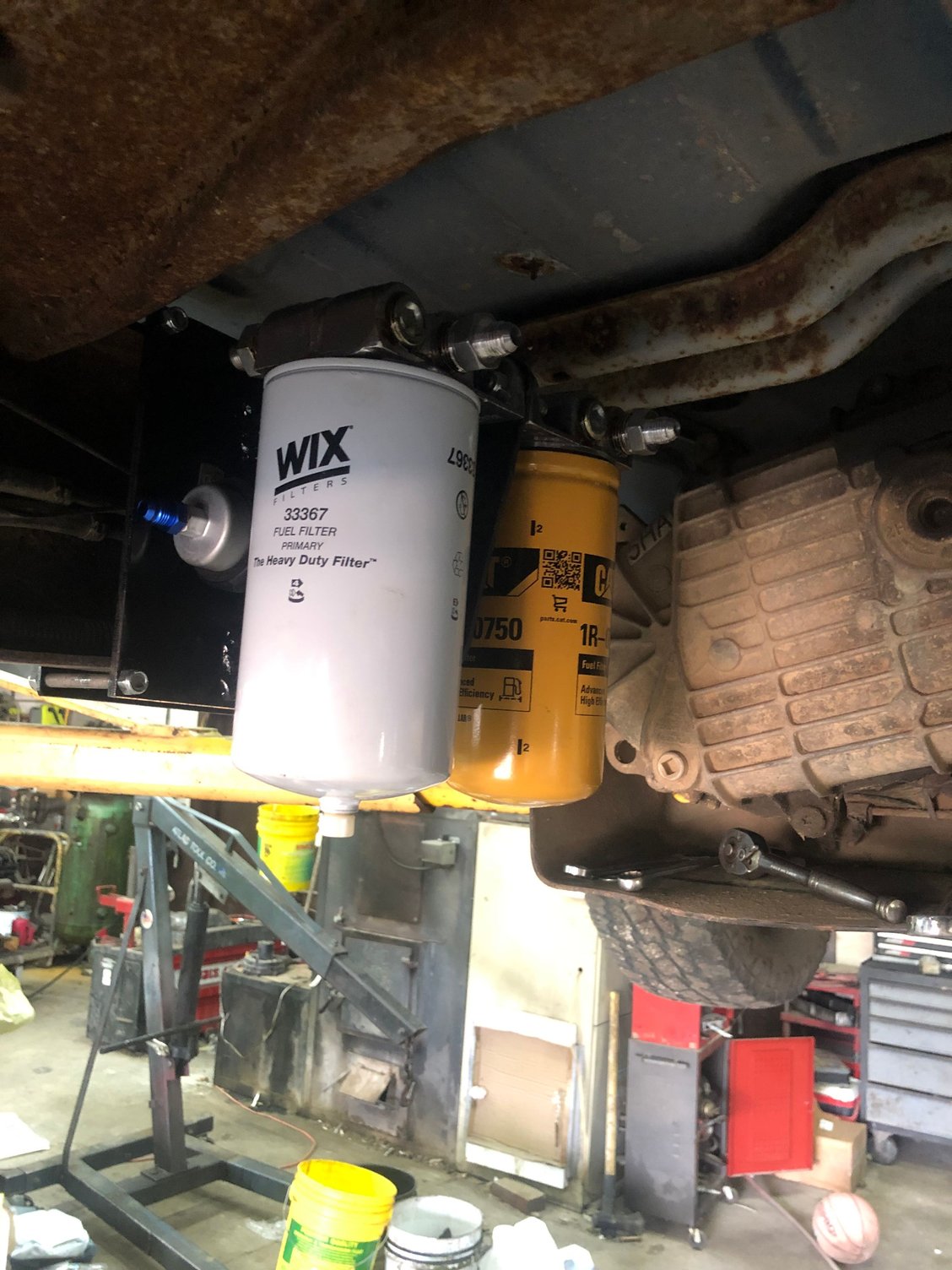

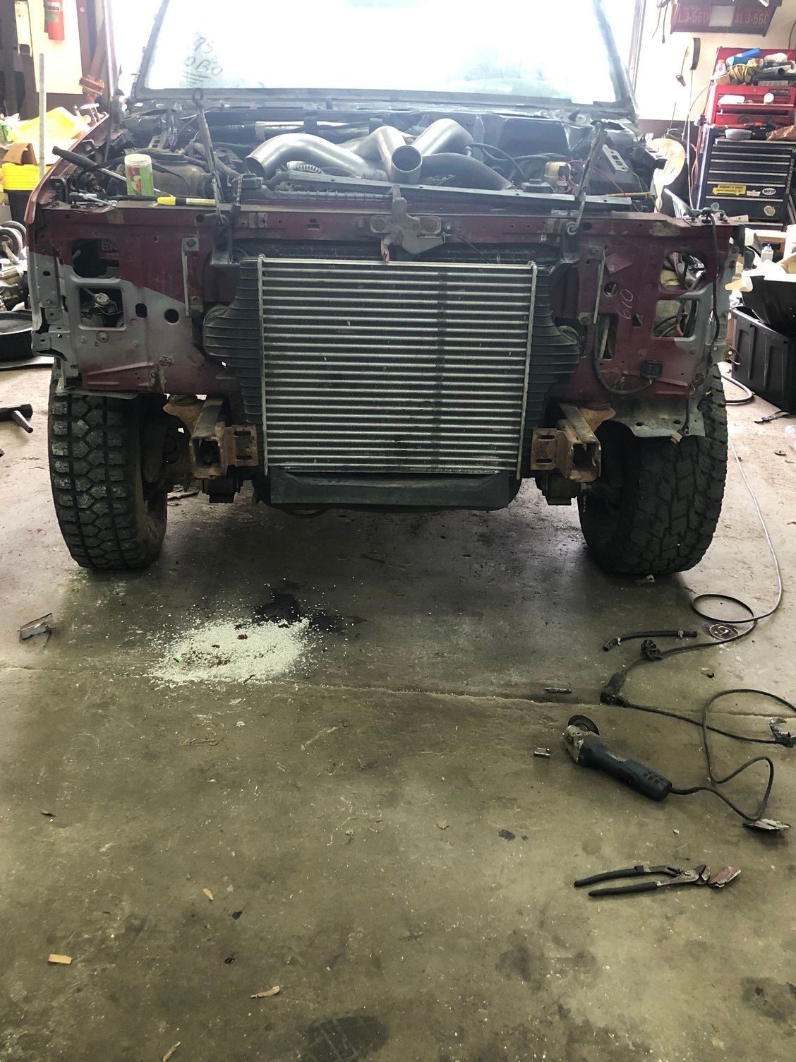

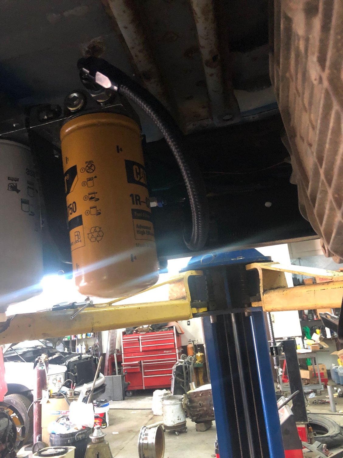

Well I know this isn’t on topic with this thread but figured you guys would like seeing a truck I’m currently building for a customer at my shop. 1995 f250 extended cab long bed customer is doing body work I’m doing all the mechanical stuff. Installed a set of 160/100 injectors. Installing 6.0 intercooler and trans cooler along with a set of Carson Shaffer intercooler pipes. And RiffRaff intercooler boots he already had a d66 with 1.00 housing installed on it. Also running a hydra with jelly built tunes. Then the cool part I’m installing a set of 2005 f250 axles purchased a trac bar mount from absalute diesel another member used it looked slick figured I’d give it a try.

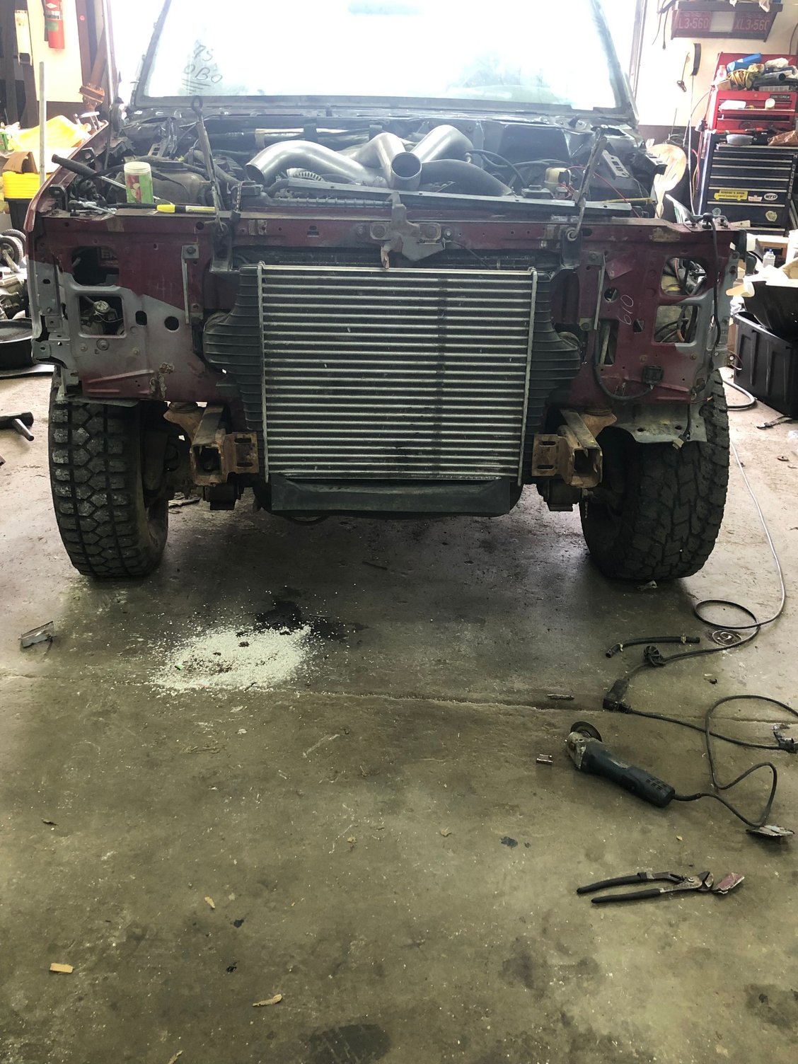

Well have some more work accomplished on truck have it running have radiator and trans cooler hooked up. Front brakes are hooked up downpipe is also in. Had issues in beginning with throttle not being responsive long story short a 96-97 engine bay and dash harness half to stay together and 94.5-95 engine bay and dash harness half to stay together.

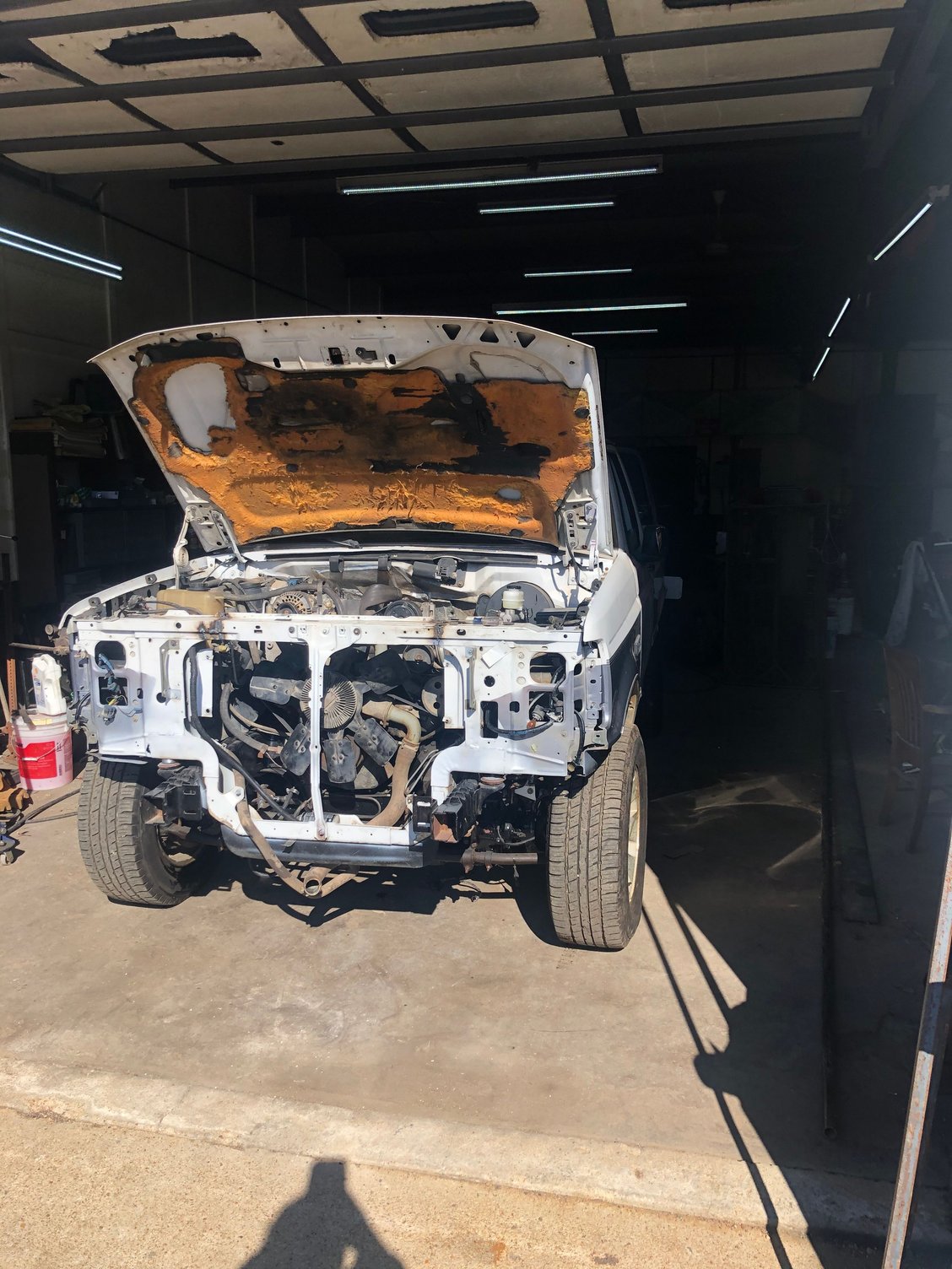

Well got bed bolted down and cab bolted down along with chassis wiring in. Speedometer works but fuel gauge doesn’t work will dig into that later. Planning on getting interior installed over the weekend hopefully.

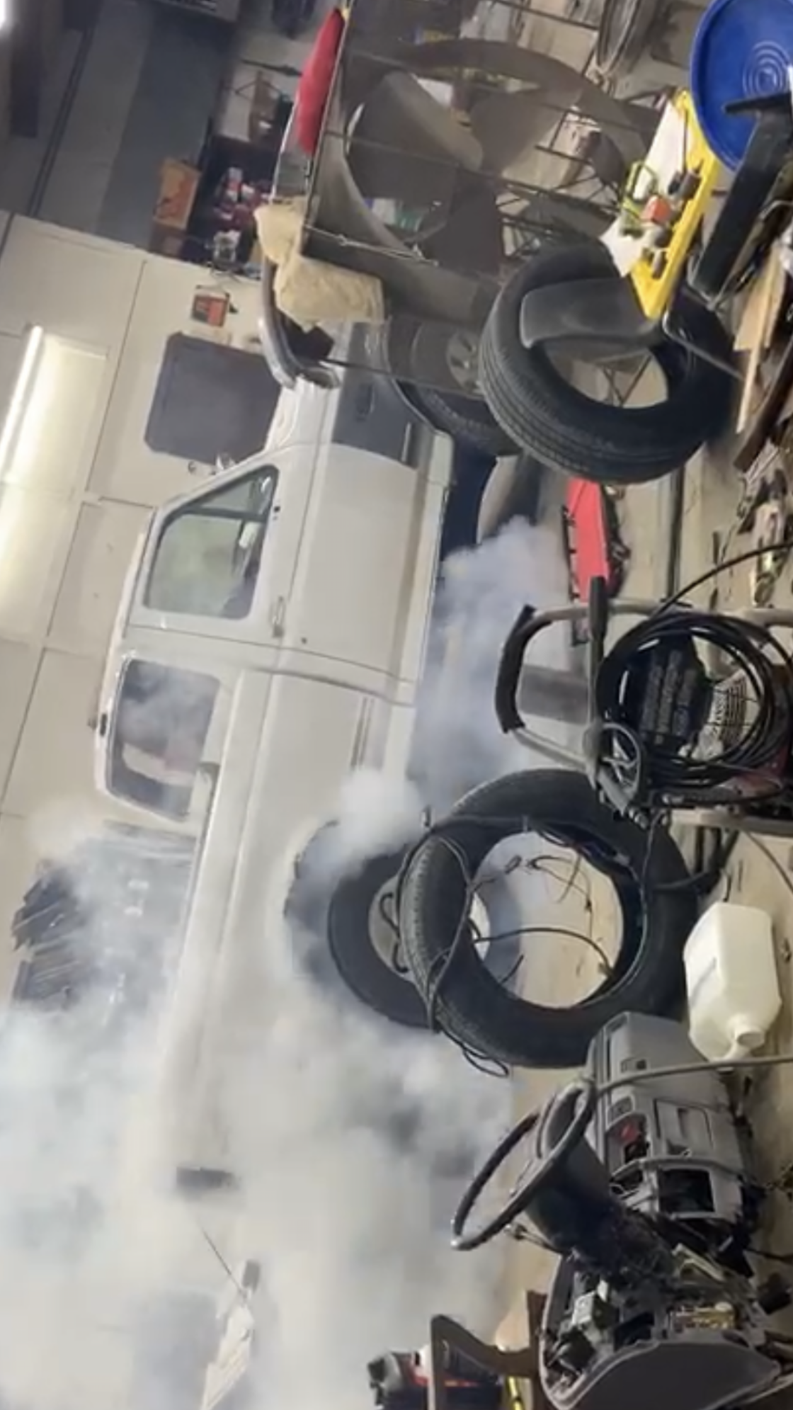

Well we got the complete 96 donor wiring harness installed over holiday everything except the fuel gauge. And abs valve on frame work I half to swap the abs valve to correct year to plug in. Along with trace wiring down to figure out why fuel gauge isn’t working. But had to do the first burnout Of im sure the many to come.

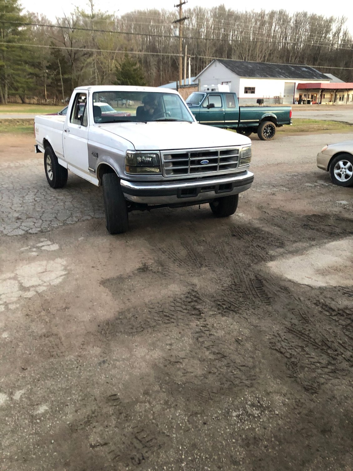

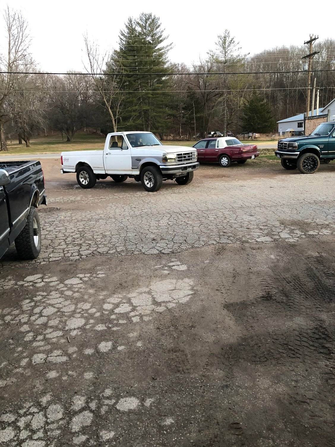

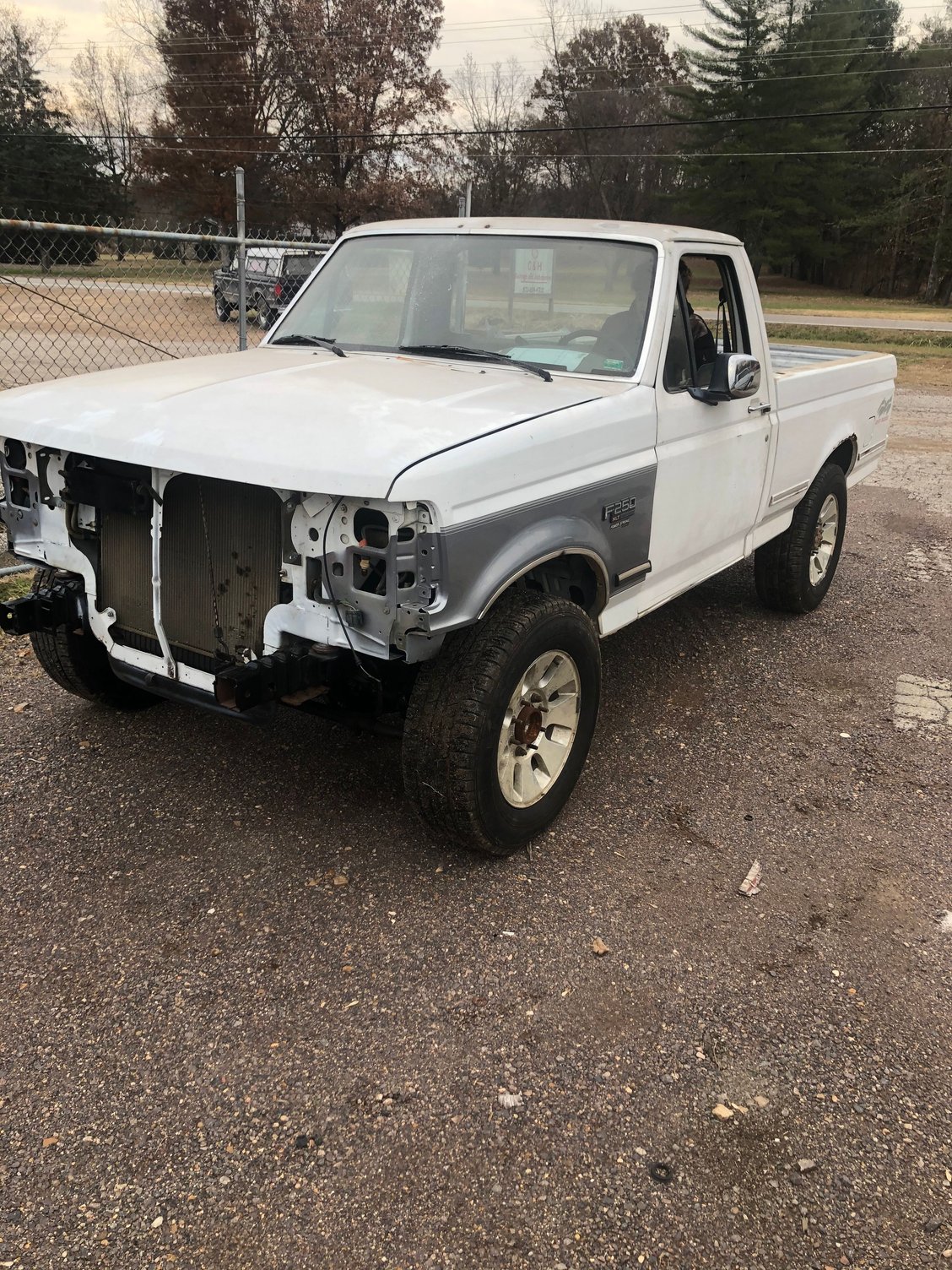

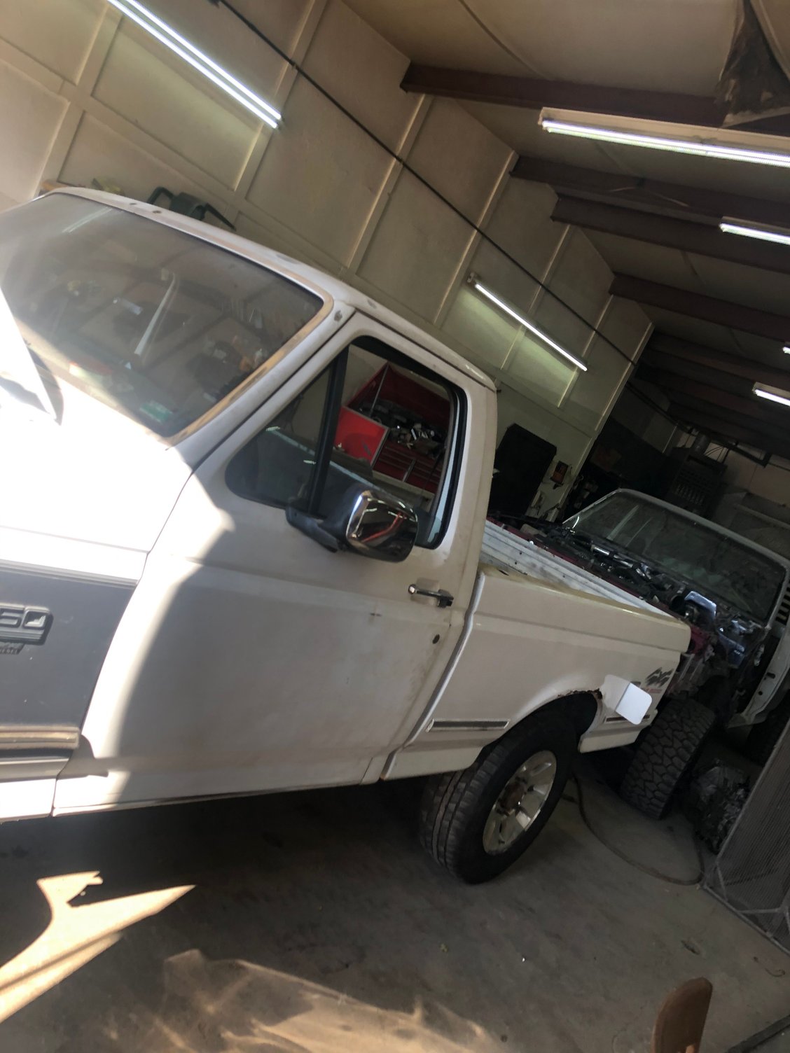

Well figured it was time for a update on truck now that it’s drivable.

That looks like it was a fun build. Bet its gonna be a blast to drive.
Old Dec 21, 2020 | 12:32 AM
  #72
7.3 forever's Avatar
7.3 forever
Joined: Aug 2014
Posts: 1,821
Likes: 238
From: piedmont mo
It’s definitely been fun as far as blast to drive it’s very much stock for time but runs well considering. But it very much is a assume rig.
