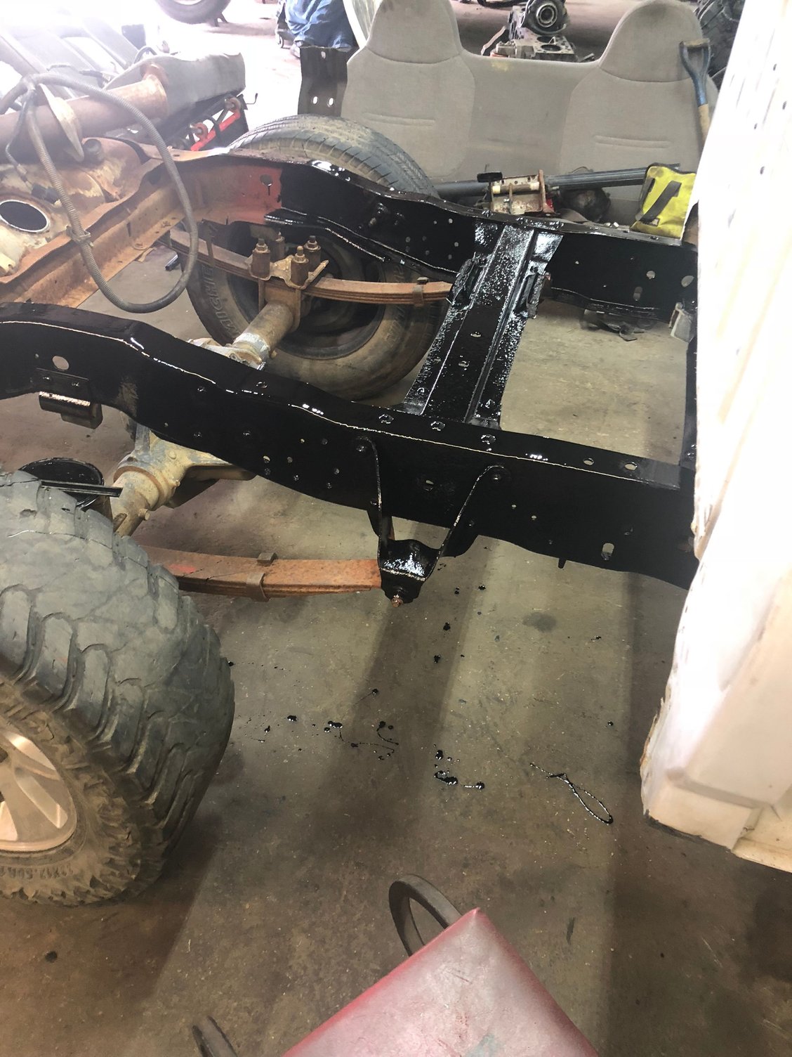

Originally Posted by 7.3 forever
And got the other side primered and trans lines in.
What is the paint you are using? Doing any type of prep before painting or just painting over the rust as is?

I’m not going crazy on prep but I am running over it with a da with 220 sand paper then hard to get to areas using a digrinder on it. Paint and primer is simply oil based rust primer and gloss black that u can get at your local hardware store. It has worked very well for me for a lot of projects I brush it on and it almost looks like it was sprayed on for most part. I’d like to get a lot more detailed on this project it’s just not gonna happen this time around. But hopefully I can document hole build on here as it slowly gets built.
220 paper seems pretty fine but must be working well for you. Up here I would probably need to be at 40 grit anyways for our rust. or an air chisel.

Yeah it’s actually in pretty good shape but either way not really trying to build show truck just wanting to make it last a bit longer and be a reliable dd for time being.

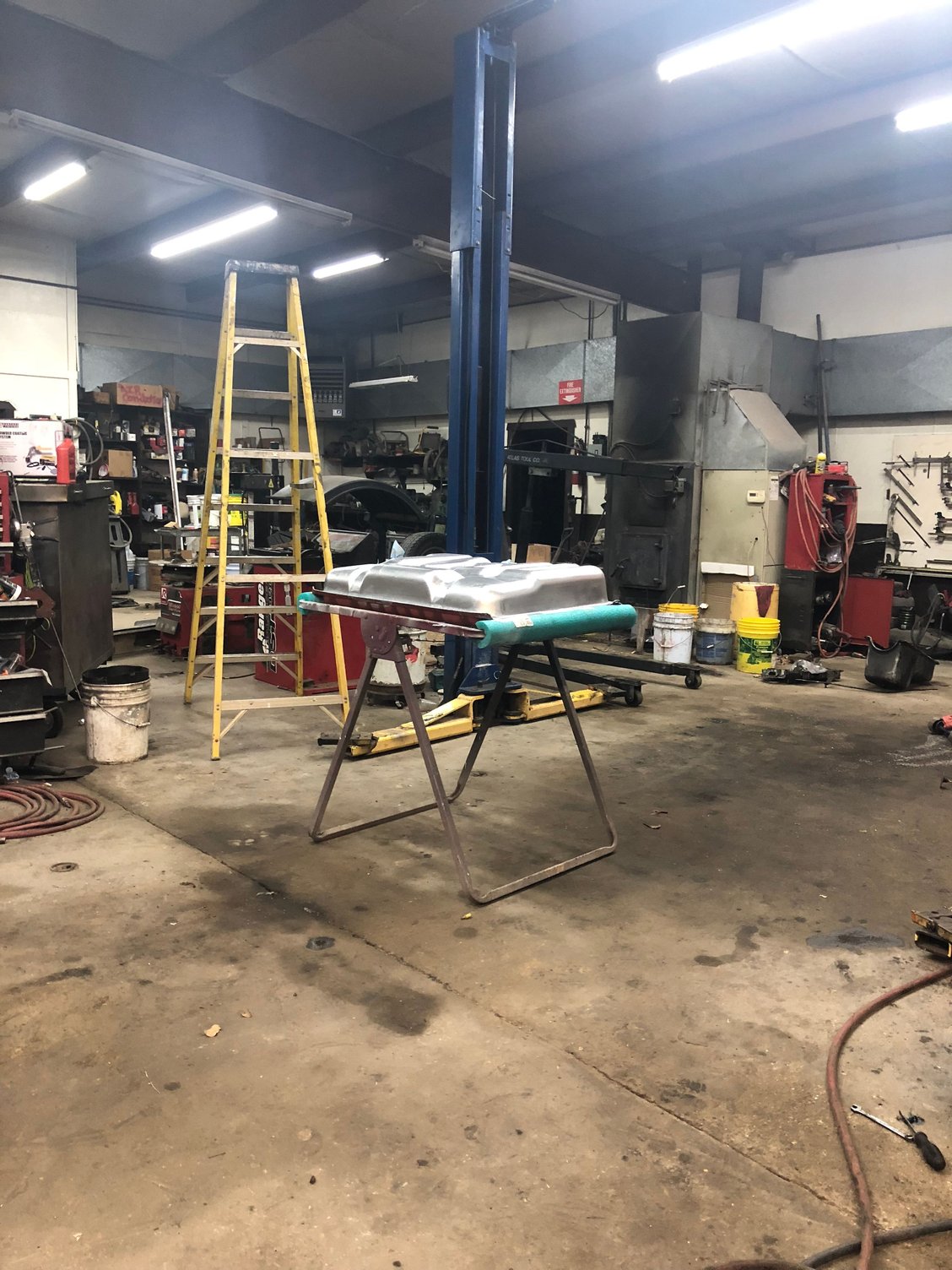

Old Oct 26, 2018 | 01:32 PM
7.3 forever's Avatar
7.3 forever
Joined: Aug 2014
Posts: 1,821
Likes: 238
From: piedmont mo
