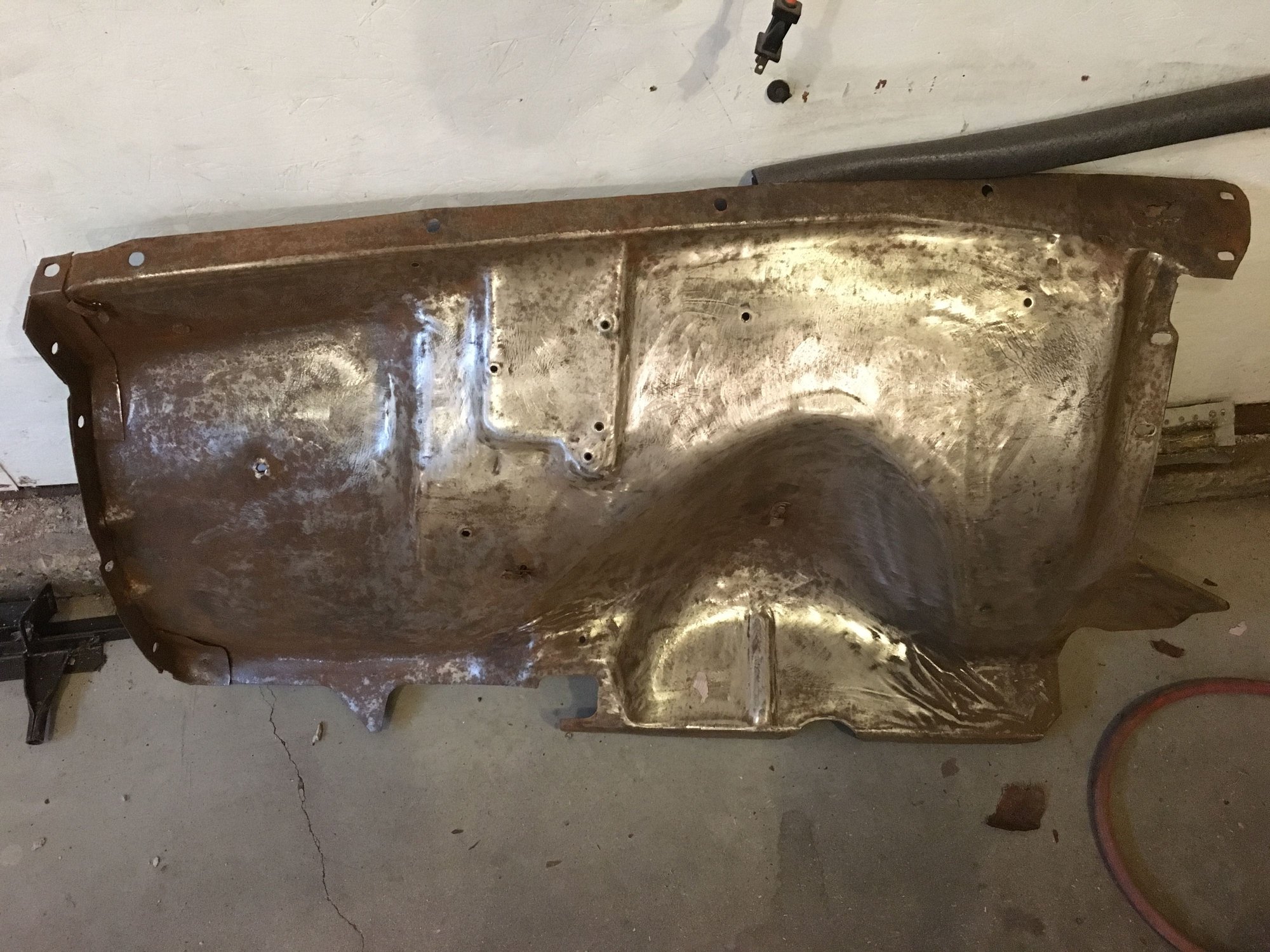

Wire wheeled the other side inner fender and the driver's fender. They are in pretty good shape with the usual pinholes above the headlights on the fenders.
Not as much bondo on this side but has a good dent on lower front.
Cleaned up nice.

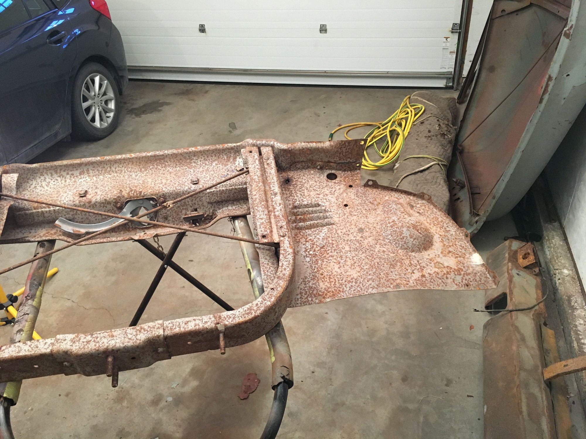

Originally Posted by F100wish
Will replace floors even though rust is not all the way through they are getting a little thin. Will keep brace and weld in front halves and rear section. Cab not off of frame yet.

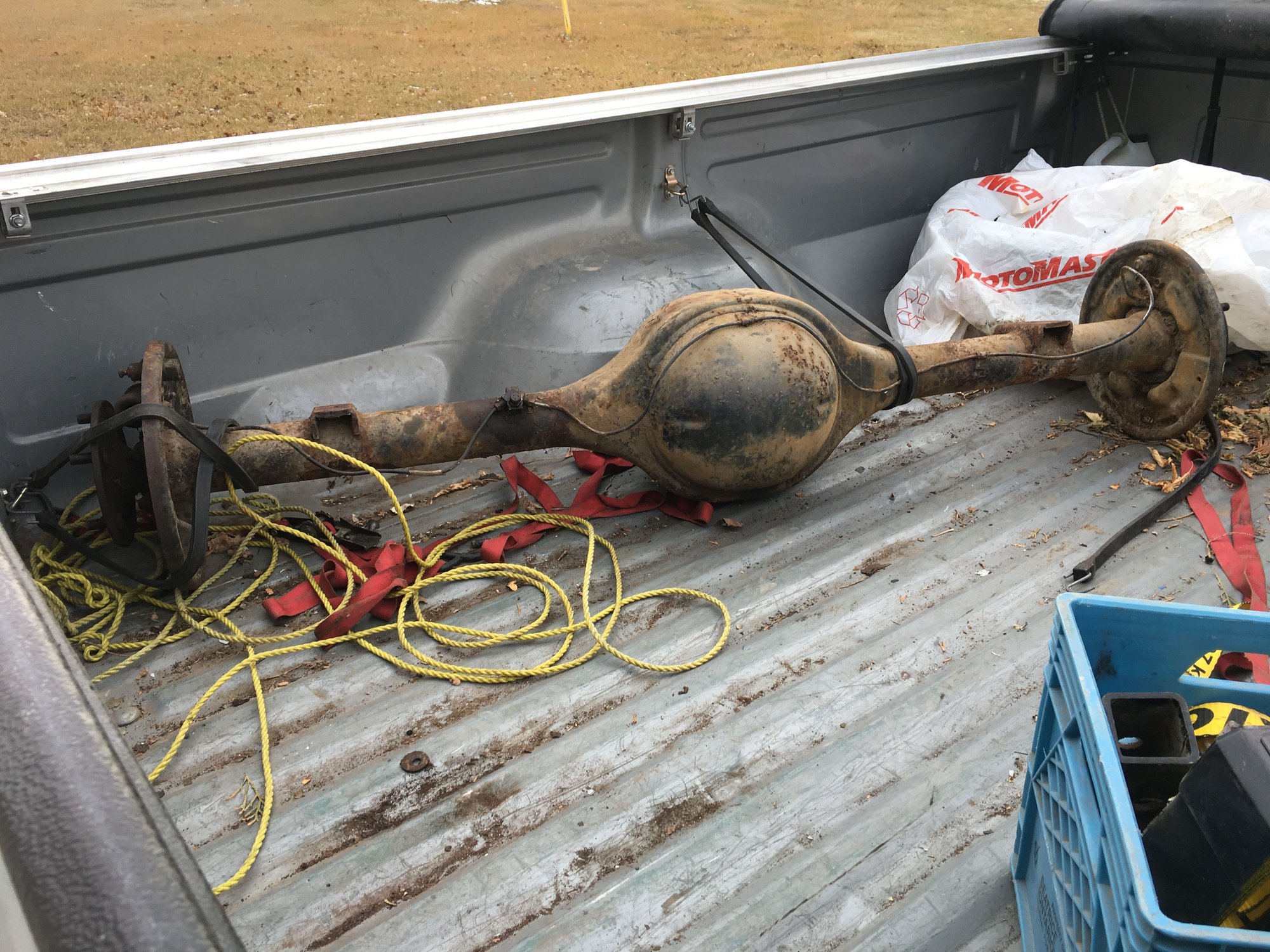

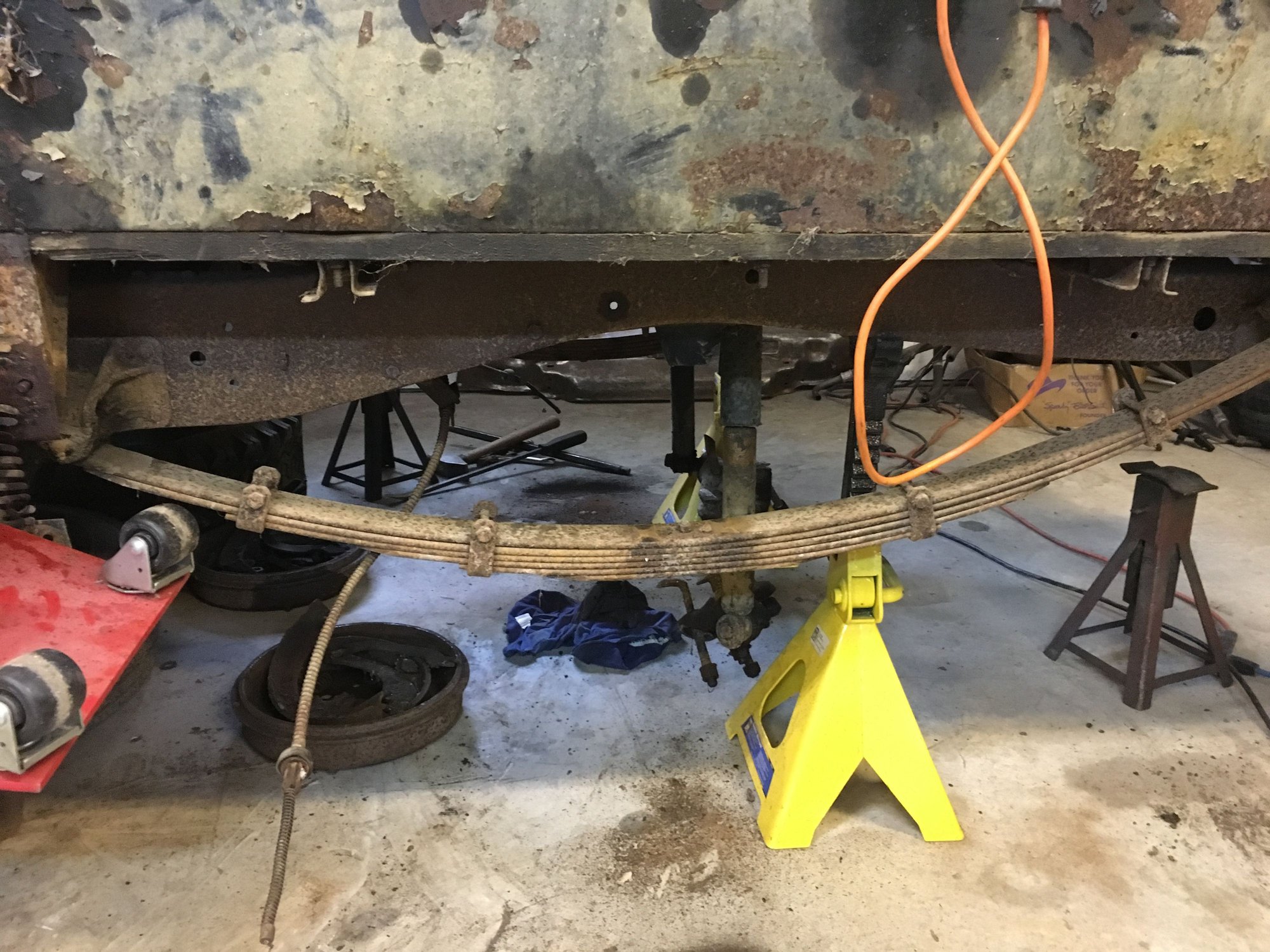

Rear diff is out and off for a rebuild. It had 3.96 gears so I opted for 3.50s instead to help keep rpms down at highway speeds.
Will take some work getting the front leaf spring pin out, it is in there good!
Heading off to the driveline shop for rebuild.
