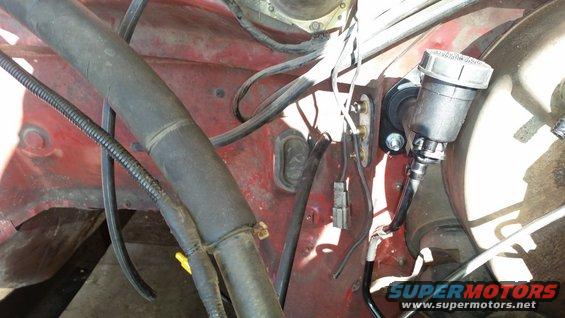

Hi all,
I'm taking the 302 out of my '85 Bronco, and replacing it with a "carb'd" 300 (Sniper EFI system). As such, I pulled out the ECU and the huge brick of wires that goes through the firewall.
Both the 300 and 302 of this era had an ECU (the 302 was fuel injected, the 300 was computer control carbureted), but the 351 was still 100% carb'd, so it had a rubber plug that filled this hole (so plugs DO exist).
Since I'm removing the ECU, I'd like to fill this massive hole, but can't find a plug anywhere for it.
The hole measures almost exactly 1.5" x 3.00".
Everything I'm finding that looks remotely close says they're either for an EB, or for a 67 - 77 pickup, and measure 1.375" x 2.875", which is too small.
Does anyone know where to find this plug?
Thanks

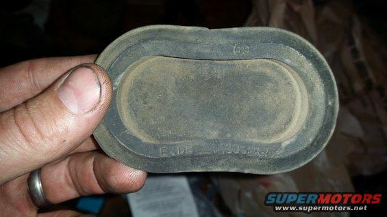

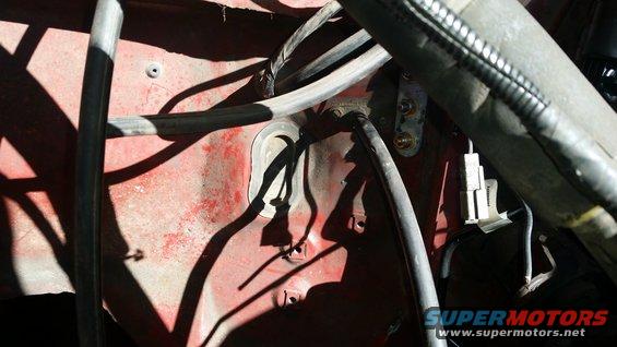

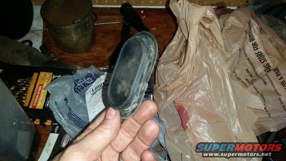

Well, I found one in the junk yard today. Actually, I found two, but one was completely dry rotted, while the other was still nice and fresh. Both in bull nose trucks with 351s.
Part number is: E3DE-14603-BA
Nothing comes up with a search for that online, but... I have a plug in my firewall now.
Old Sep 10, 2018 | 08:11 PM
AbandonedBronco's Avatar
AbandonedBronco
Joined: Dec 2007
Posts: 7,987
Likes: 104
From: Boise, Idaho
Here's some pictures.
I also pulled out my micrometer to get the width/height and it is, indeed 1.50" x 3.00" on the gasket inner diameter.
