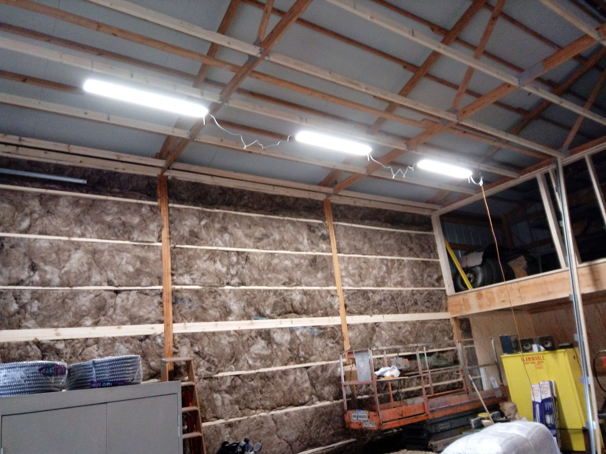

Chris, yes, we're blowing in at least 12" of insulation in the ceiling. Have it sitting on two pallets waiting for the ceiling to be finish. The bottom 8' of the walls are plywood for two reasons, we can mount things to the walls like shelves, air piping and air hose reels. Also, if one panel gets damaged (I've been known to drive my forklift into walls) we can unscrew a panel and replace it. Also a third reason, if for some reason I have to get to the wiring in the walls, maybe to add an outlet or light, it'll be fairly easy to get at.
We placed the air compressor up in the mezzanine to save a little floor space in the shop area and also to eliminate some of the noise. So far it seems to be working pretty good. I need to run pipe down throw the floor of the mezzanine for supply and a separate pipe to drain the tank of water. I'll air hose reels on the walls and I have four drop electric reels hanging from the ceiling. I actually got the idea accidentally when I rented my second shop. The previous tenant was a machine shop and had power drops from the ceiling ever so often for their machines. The landlord told me he would have the drops removed before I moved in. I told him not to, just leave them hang. That was a great decision, made for handy power and avoided extension cords on the floor. The reel make them even better because I adjust them just to miss the mast of my forklift but low enough for me to reach them.

Abe, yeah, I have 24 four footers going in the pole building. 16 on the main ceiling where it's 15' high and another 8 under the mezzanine, in the area where I'll be most of my me measuring, drilling and tapping. I like lots of light when I'm working. We temporally rigged up three lights from the beams on the high ceiling and they did a fair job at lighting the entire shop. Can't wait to see how they light up the place once I get them all lit.

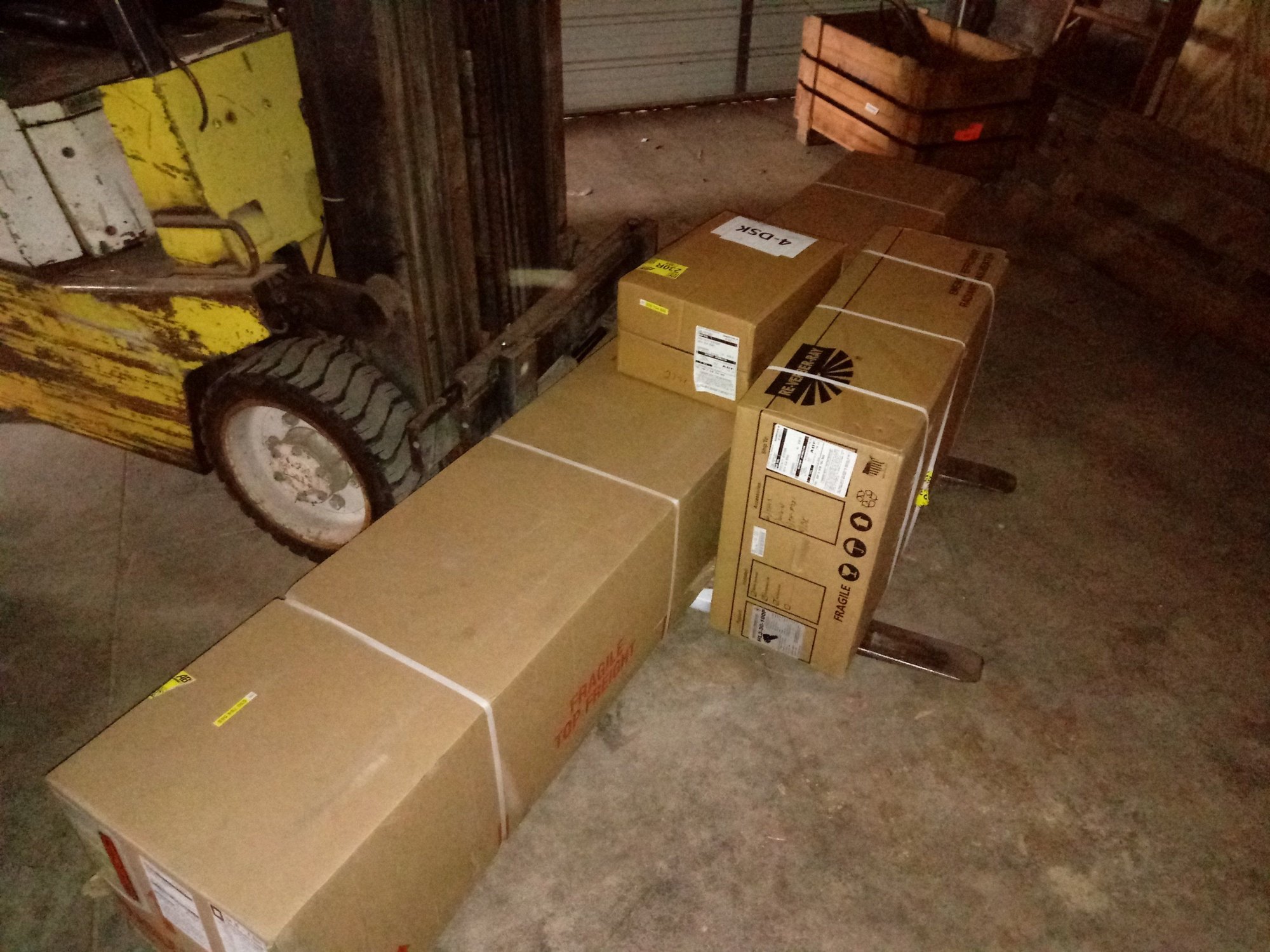

I got a call yesterday to from the trucking company to tell me they were delivering my heater today. Just got it off the truck an in my shed.

We have the building pretty much done. I have the furnace installed on the ceiling along with the LED lights, ceiling fans and retractable power cord reels. Still have to do some minor finish touches and straighten out the stuff and finding a place for everything. I've already done a few customer jobs in it, working out great.
I'm already experiencing the benefits of the insulation. Right now we're having a heat wave, I'm sure like most of the country, with temps in the high 80 to mid 90s. The shop is staying about 10 or more degrees cooler than the outside as long as I keep the overhead door shut. I don't have AC but when the temps drop at night I open the windows and close them first thing in the morning. When working inside it starts to feel warm until I walk outside for a few minutes and then come back in. I can really feel the difference. With the LEDs it's like working under a super nova, well not quite but it's very well lit. The ceiling fans also help with the heat, keeps the air circulating. The reel cords are super handy to have just about head height, eliminates the need for extension cords that lay around the floor. Not looking forward to winter but I'm interesting in seeing how the furnace keeps the place warm.
