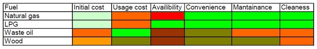

This a chart I came up with based on my need to have a relatively low maintenance, dependable heat system. Different needs and tolerances would change according to the individual. From what I have gathered from this discussion and others I've had waste oil heat while cheap, or even free, is not convenient. Just from years of working on cars and trucks I know a little oil mess can easily turn into a BIG oil mess. Also, the initial investment is more than four times I feel the IR system would be. I also have had a long period of experience with IR heat and I really liked it. Also, while waste oil could potentially be free it would take a lot of work and time to gather the amount I would need to heat my shop on a continuous 30-50 hour a week, 5-6 month period. Even if I could set up a system on my property to have people drop off their waste oil, thus saving the gathering cost, I would see a huge mess developing having oil spilled and dirty container spewed around. Also, from what I have found, waste oil systems are sensitive to impurities in the oil. Unless I can collect the oil myself and left it to others there's no guarantee water and other impurities wouldn't be present, causing maintenance problems. Natural Gas or LPG, while having substantial cost, is very convenient to use. Both would be delivered to my shop without having to raise a finger other than writing the check every month.
I know my wife and son likes the "free" part of waste oil I doubt either one will be there when it comes time to perform maintenance or clean up of a mess.
There, I corrected the chart

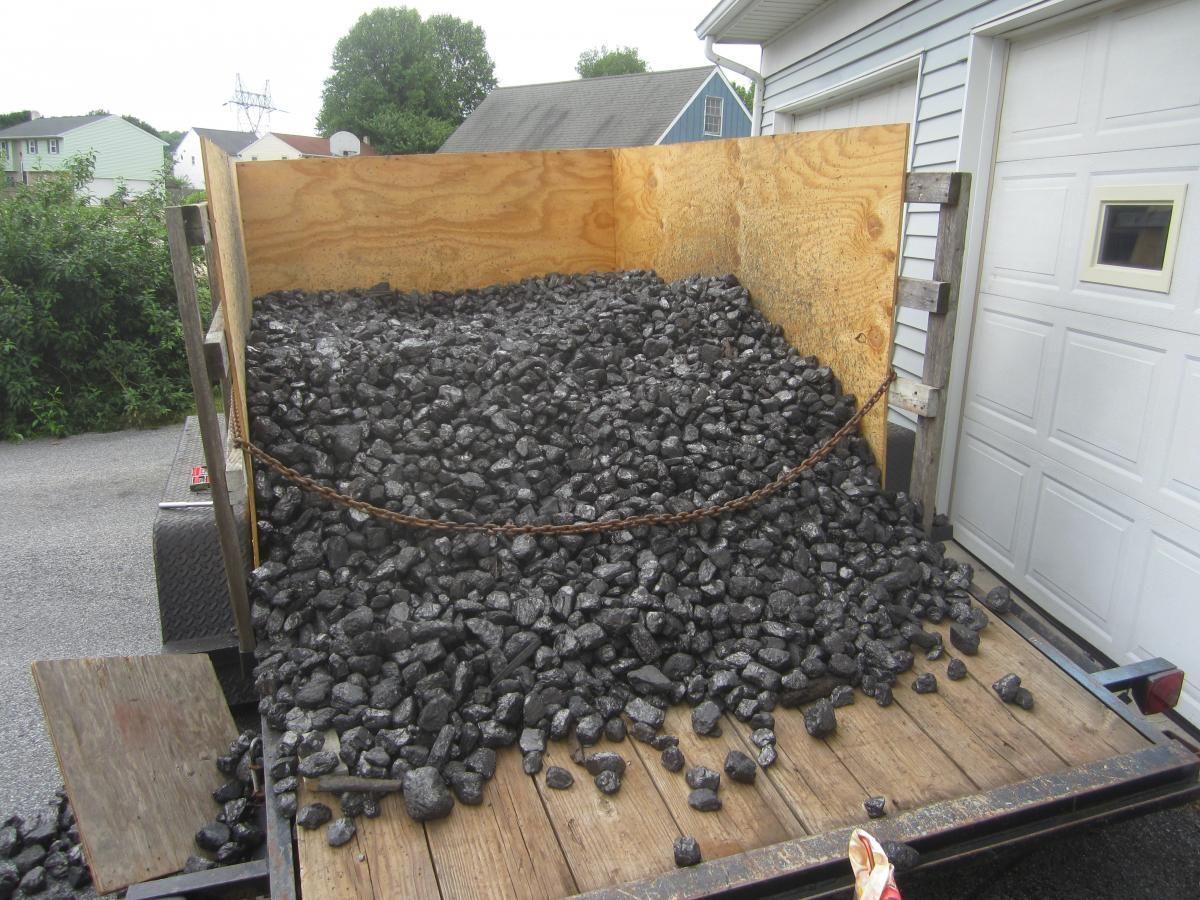

Hey, where’s coal on your chart? Dennis

Why did you give LP red for availability? I thought you already get it delivered. Also I thought you do not have a natural gas line in ground to your house? So shouldn't natural gas get the red, assuming red is not good.
I've known to be naughty but naughty enough to get enough for Christmas to adequately heat my shop.
Abe you got me. I have them swapped. I do have LP at my house but no access to Natural Gas. When you get to that point just stand on your head or wait until later and I'll change the colors.

I’m a big fan of coal. Dennis
