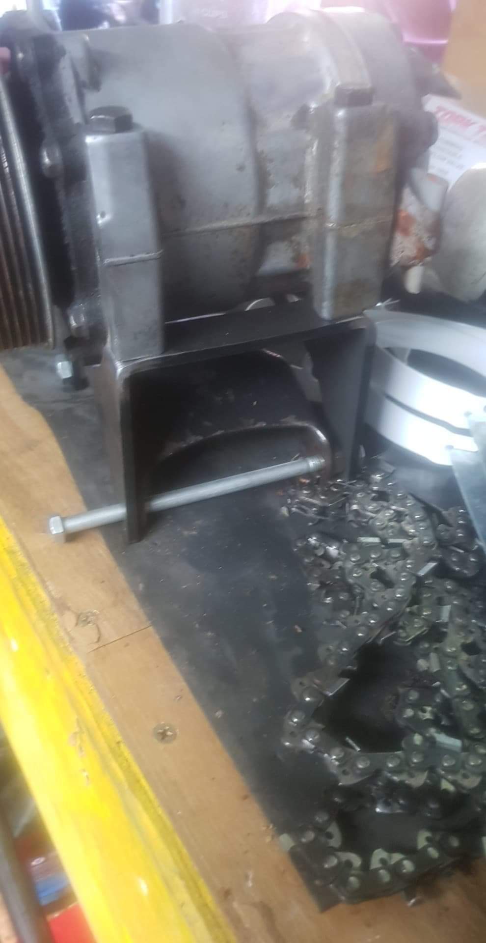

Old Apr 2, 2019 | 06:38 AM
  #70
gun32gtr's Avatar
gun32gtr
Joined: Aug 2018
Posts: 49
Few photos of the build progress thats finally getting some progress. Starts and runs but just waiting on my high mount custom ac mount to made thatll look just like the one in the engine.
Dump pipe and exhaust just needs tiging up. Im Sending off the rear tailshaft this week. Going with external reg on the dodge alt and i will use the crank sensor and a decoda box for the tach to be calibrated.
Got 24v top hoseand oil filler valve cover comimg and will be making the botton hose out of 2inch stainless bends and some silicon joiners. Here is a few more pics as well. Few pics of the custom ac brackets. This is the test 1 and now its all measured up correct now as it sat 1 rib to far forward the proper one will be lazer cut and the idlers will be installed.
