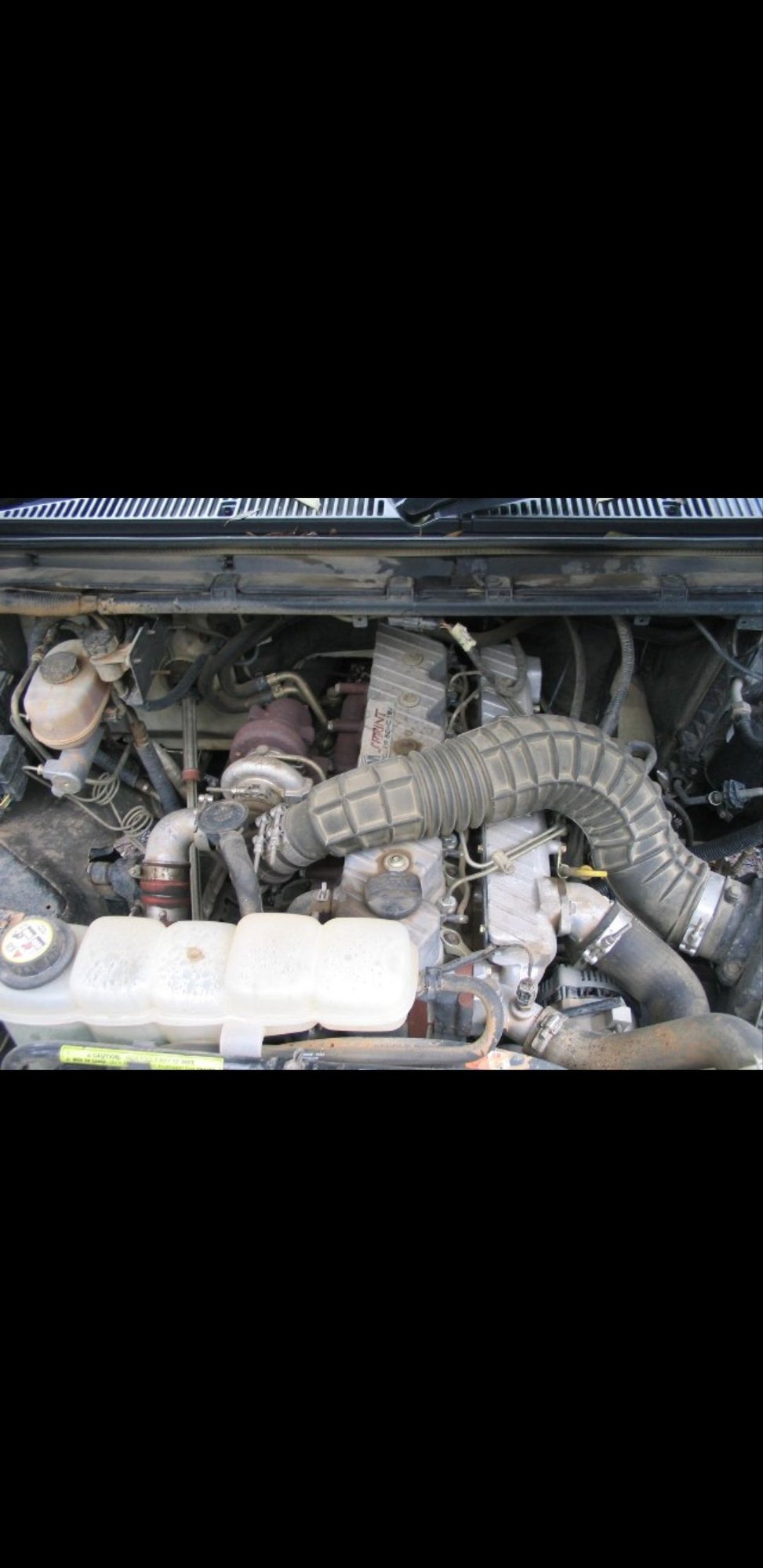

Not my bay bit best i could find online. They really dont have much online infor ilon these engines

That engine mount mod dont seem to difficult. I wonder why they dont just make some like yours as an option? Or is it purely because of the trans we are using? With my ac and stuff i might just use the cummins stuff i think. Or using a 7.3ps alternator i think i bloke in Australia did and used the 7.3 belt rhat way

Old Aug 16, 2018 | 07:45 AM
gun32gtr's Avatar
gun32gtr
Joined: Aug 2018
Posts: 49
This is exactly same as my engine im organising
