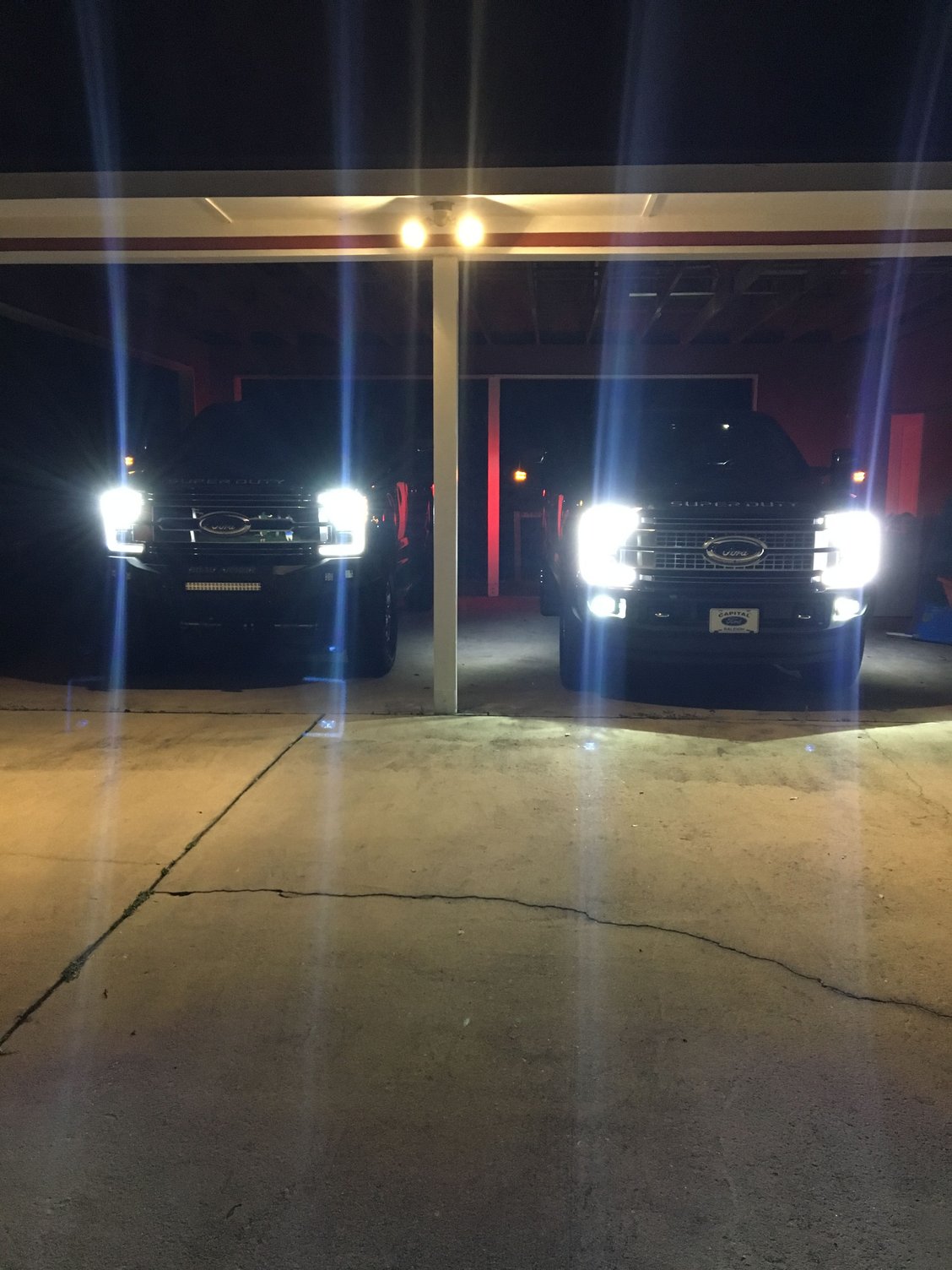

Ok, not scientific but a side by side comparison. The ‘18’ s were definitely brighter and didn’t seem to dim with the lights on.

Wonder if that's a Forscan changeable setting for us 2017 owners or new oem led hardware?
