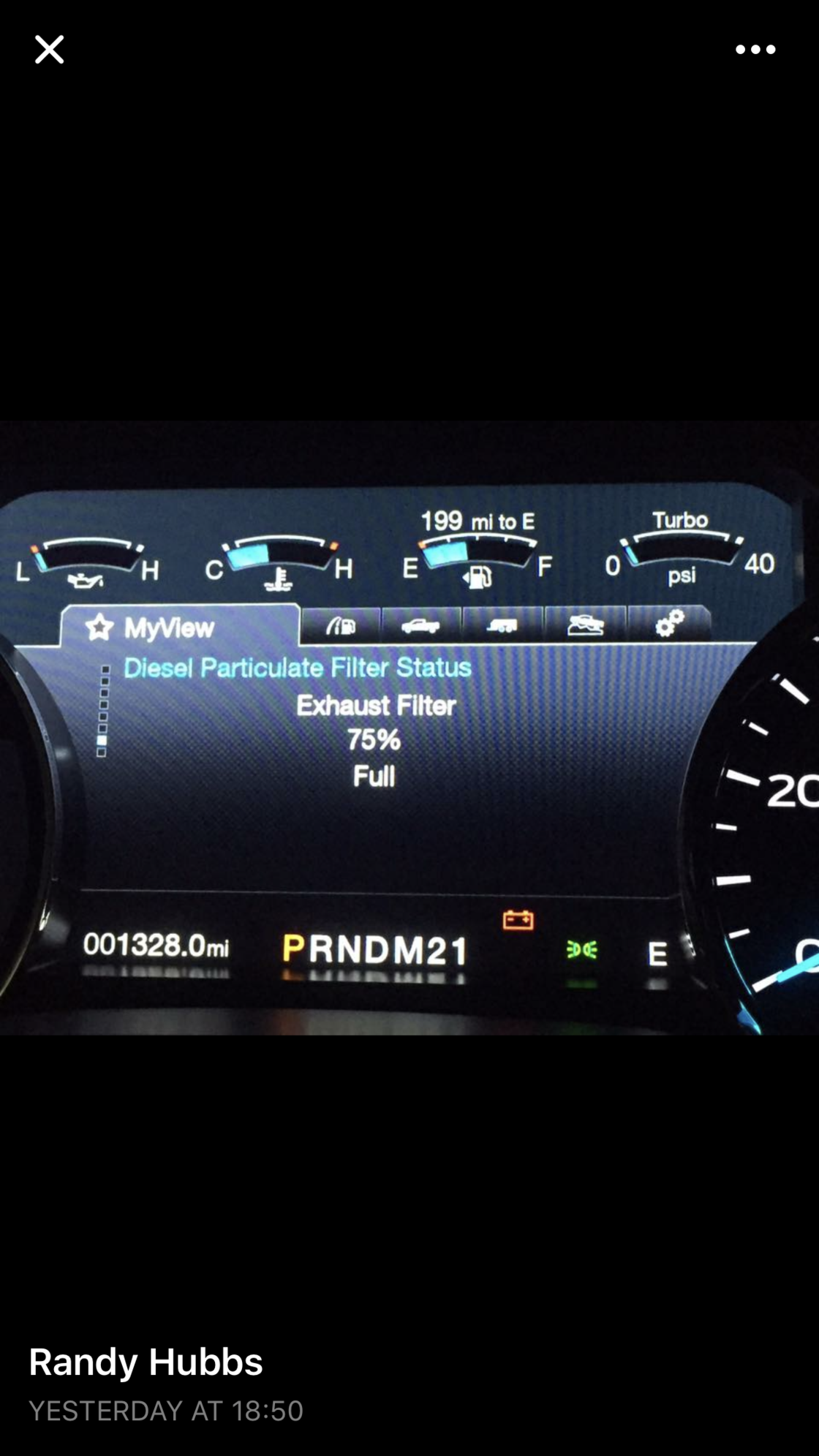

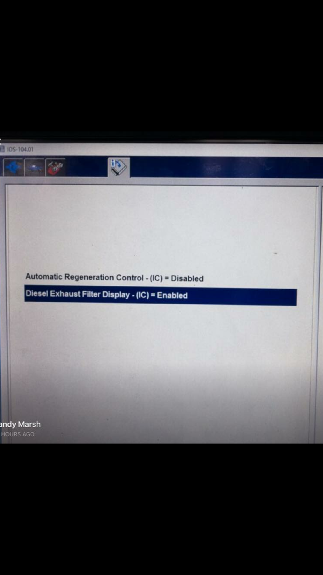

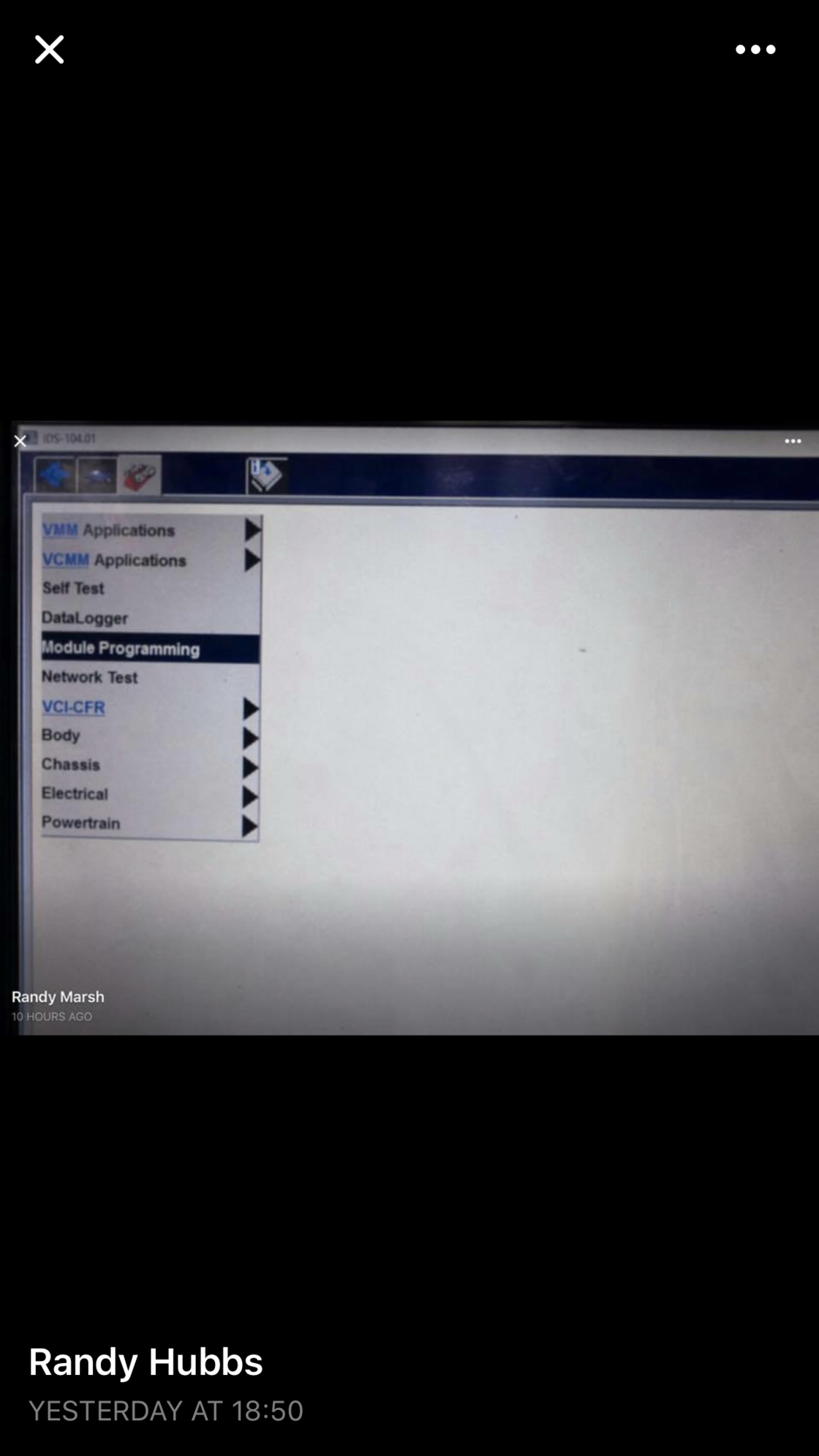

I saw this in a Face Book post, and it's something I want very much. I'm going to post the photos here to see if anyone can tell me if this will work and/or if there is any risk in doing it?
What do you guys think?

It's been discussed on here as well (probably the same person). You have to have the Ford IDS tool to do it (until the Forscan folks can get it figured out).

Yep, as Tom said, it's been discussed in a few threads here. I have it enabled on mine. It's a one minute procedure for the dealer to do for you.

Thanks Rodney. Any change they can change it to operator commanded regens while they're at it? It kind of looks like maybe they can in the pics?

Robert, it does indeed look that way but I have't seen anyone enable that command and try it yet...

I had them do this on mine and posted a thread. Took longer to tell the tech what I wanted than for him to do it.

I'll take mine in and get the DPF% display enabled.
Wondering while it's there, if they will do a couple more programmings for me...
Bambi mode & Disable double horn honk.
Was going to do the last 2 via Forscan, but if they can, what the hey...

Why are you guys having to have this done? Its on the main menu. Are you talking about the dpf % full? My truck does that?
