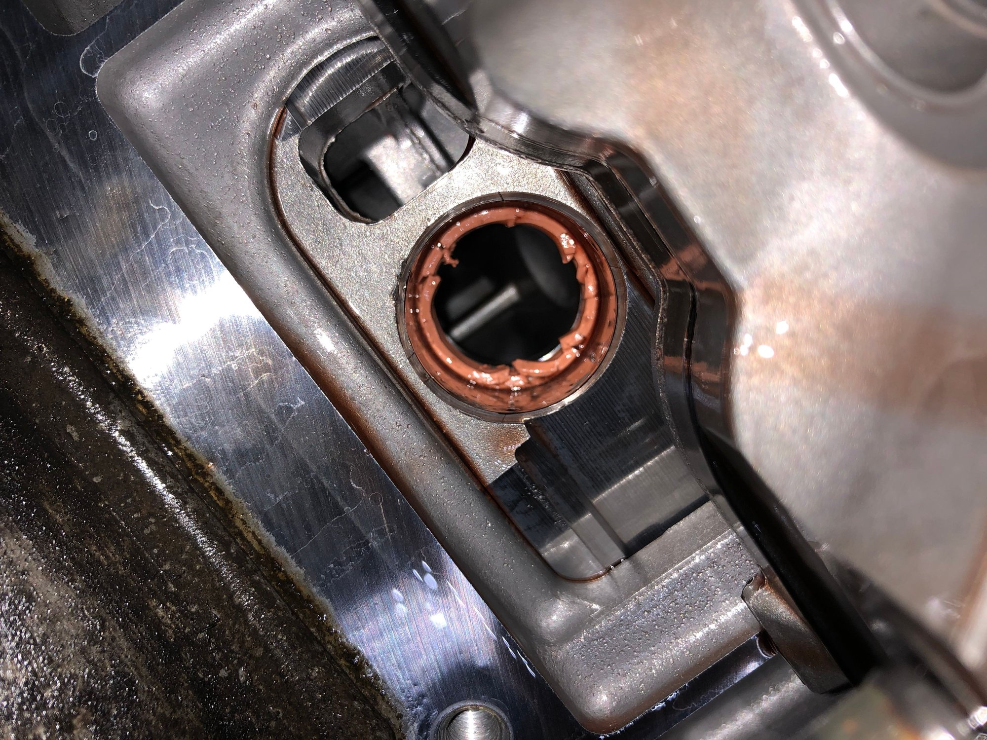

Help filter oring on trans stuck
It is coming off in pieces. It seems melted to the side. I tried everything. What am I doing wrong.

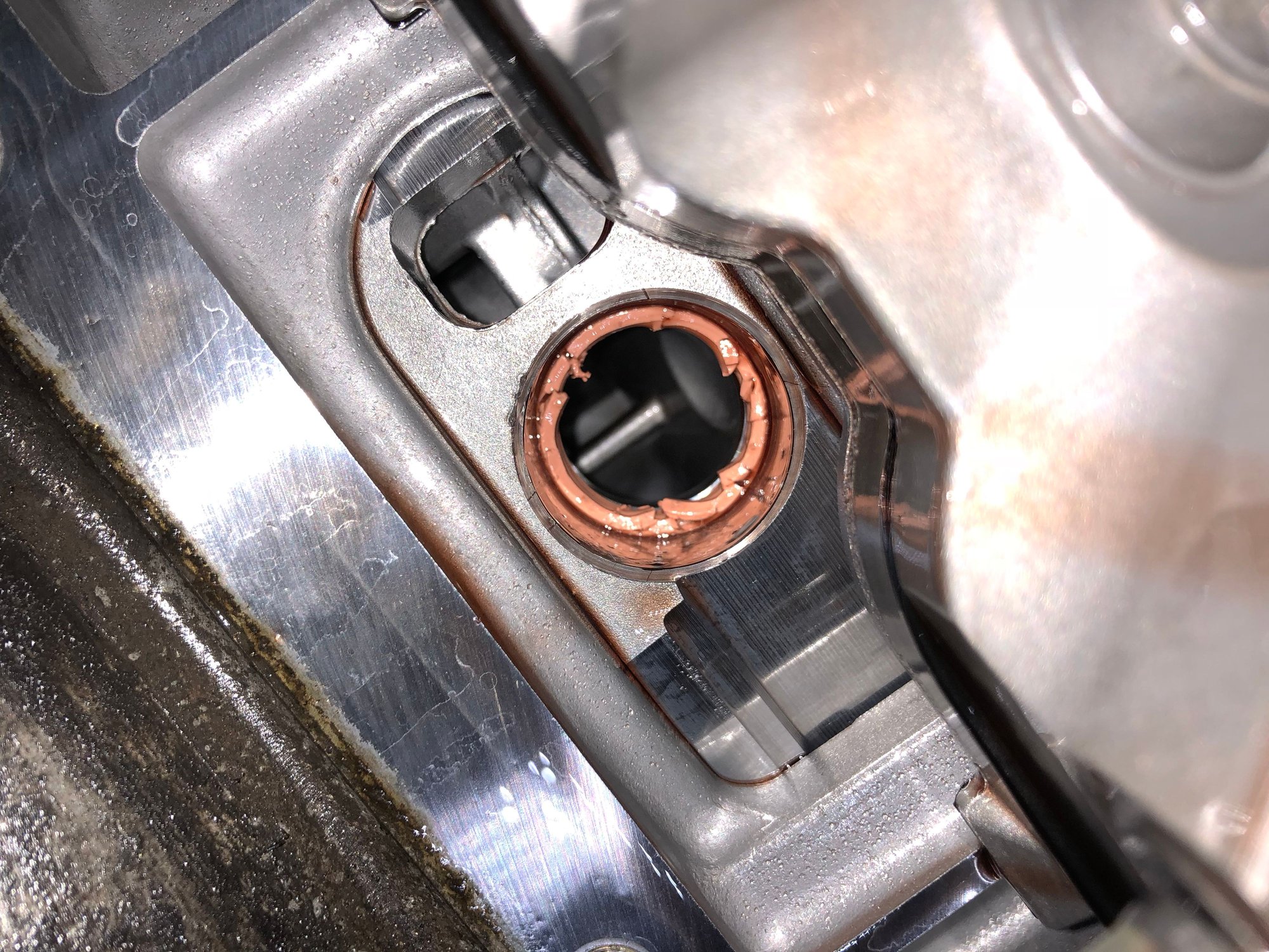

In the vid, @ 3:55 in.

He doesn't mention how he does it or got it past the oring to begin with. Is there a lip? It seems to be stuck on something like it was pushed to far. NOw that i've gottena few chunks out it seems there's a metal piece protruding into the middle.

I grabbed a washer that fit inside of the ring, placed it above the ring then moved it to the side of the bore and pulled down.

I got it, but made a small scratch on the side right where the gasket sits. I made sure it’s not pointing out, concave, and am ready to start the fluid exchange.

Go to Harbor Freight and pick up a set of the plastic body clip tools.
Find the one that fits the hole and stick it in and work you way around
and pull to work it loose. That seal has a steel band in it under the rubber.

In the future rig up plastic washers on a threaded rod to pull it. I made the tool when I did my pan replacement but did not need it.

The key thing is what ever you do you do not want to scratch that bore. That is the intake to the gerotor pump and it
you allow air into it from a scratch in that bore your going to have issues.
Maybe Mark K will stop in and say just how much is too much.

Amen...,don't use a metal pick......don't ask me how I know

What finally did it was pushing up on one side caused the other to pivot and then the point of contact was much smaller.

Now that you have it out how did the bore do?
Also now you can feel that steel insert in the seal.
