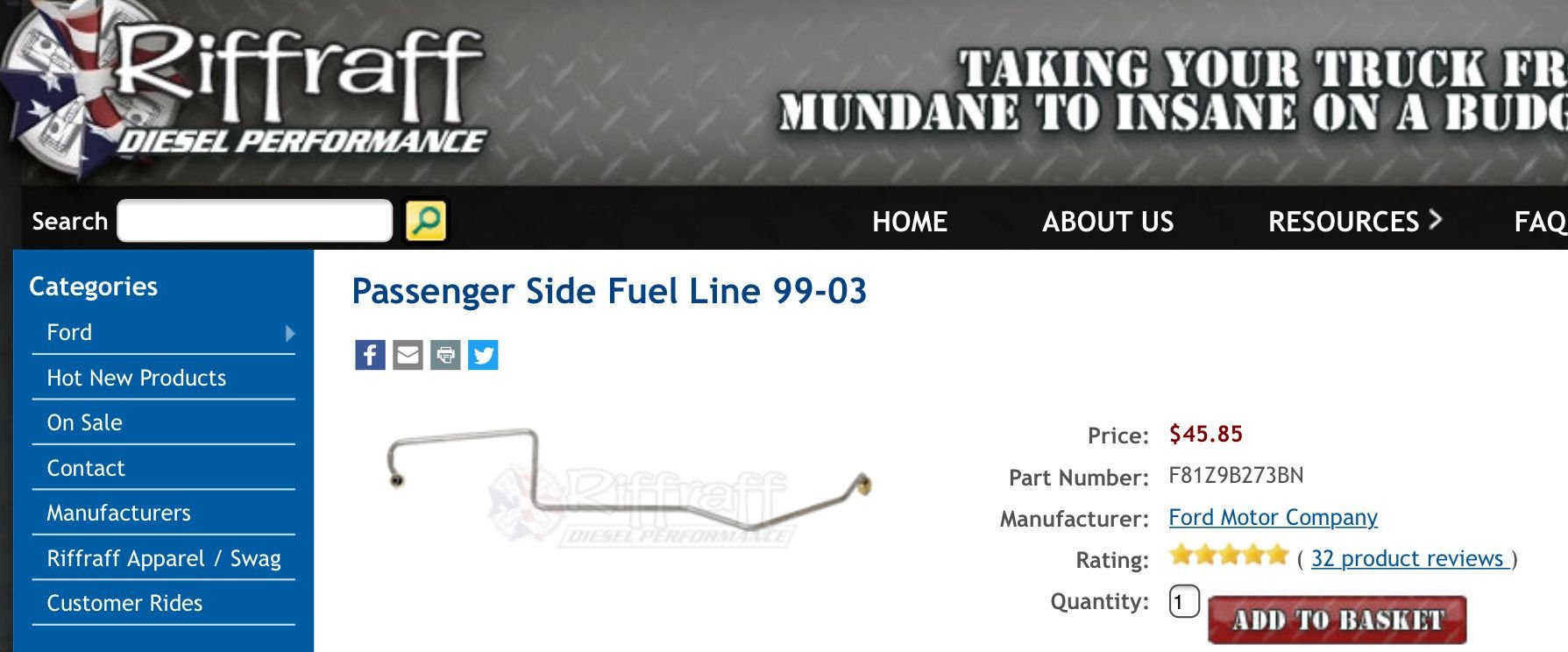

while you are in there, have you done the fuel lines ?
i think it is the passanger side hard line that is prone to bursting from rubbing a hole in it at the clamp on the back of the head.

Stick with OEM HPOP lines for some reason aftermarket ones dont last. Like mentioned obove make sure your passenger side fuel line is OK, I would suggest resealing the fuel bowl and changing the Parker sleeves in the fuel lines going to the heads to fuel bowl.
you can also reseal yoir HPOP I think its Riffraff? Or Diesel O rings? that carries them.

here is a thread showing the clamp that rubs a hole in your passanger side fuel line.
https://www.ford-trucks.com/forums/1...fuel-line.html
riff raff sells the ford line but cursiously doesn’t offer the correct clamp.
