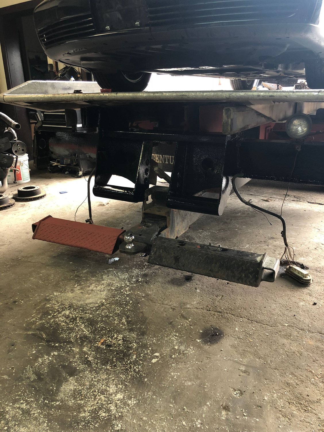

Sorry guys about being scarse past little bit but been busy at work with other jobs and truck has been slightly put on back burner. I have been working on some sandblasting and rust primering and painting on the taillight housings and control boxes on it in my spare time. Also the plan is to swap motors after a compression test.
